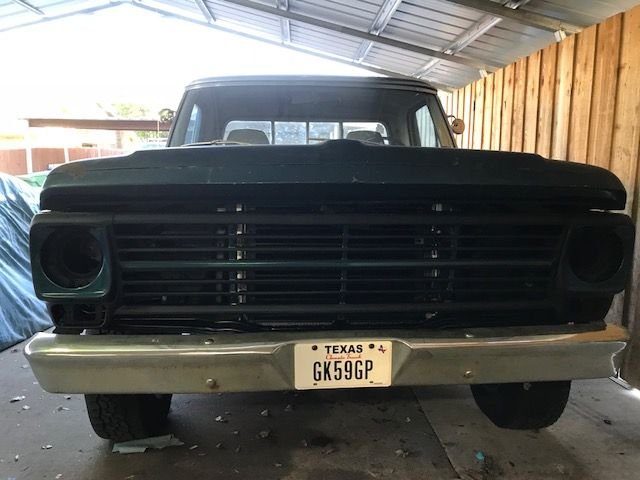

I had to fab the brackets for the A/C condenser to set closer to the radiator and not interfere with the header panel of the grill. Keep in mind, this is the first time I’ve ever tried to do any parts replacement from the major wrench she was in in 97, other than a fender and hood. Even those were halfassedly aligned. I was angry, replaced the immediate item and parked it against the fence for 15 years.
So, there’s a sneak peek at the grill. If you blow up the pictures, I think you’ll see how it all ties together. I’m waiting on some parts to come in to fully assemble the grill, plus there’s a cool custom dodad I have in mind. I’ll see how that turns out before posting.

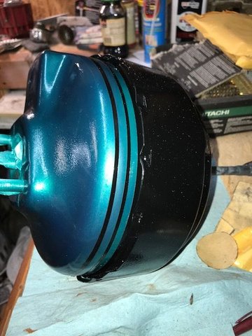

WOW amigo, I love that color. Very unique and that is some serious attention to detail. That booster will set your engine compartment way above the normal. Dang, I was just looking forward to better brakes with mine, now, you have raised the bar...

Originally Posted by TeachNlive4ever
I should get something accomplished this weekend. We’ll see.....
Hey Chris, is this from a spray can?

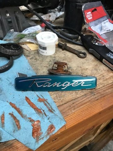

It is. The booster has 7 coats of primer (3 passes=1 coat) sanded in between to fill the pits.
The emblem is painted from the back from the factory and the “Ranger” is embossed in the plastic. I sanded off the red with 180, followed up with 320 and finaled with wet 600. The plastic will become clear as the chrome remains. Paint until coverage and reapply a silver backer for pop.
I was going to wet sand and buff the green on the booster, but I didn’t want to take the time. That and I was concerned about the rattle can clear not holding up.
Being lazy and cheep, I didn’t buy base coat and clear nor did I want to fire up the paint gun.
Ok WOW!!! That is the best paint from a can I have ever seen !
