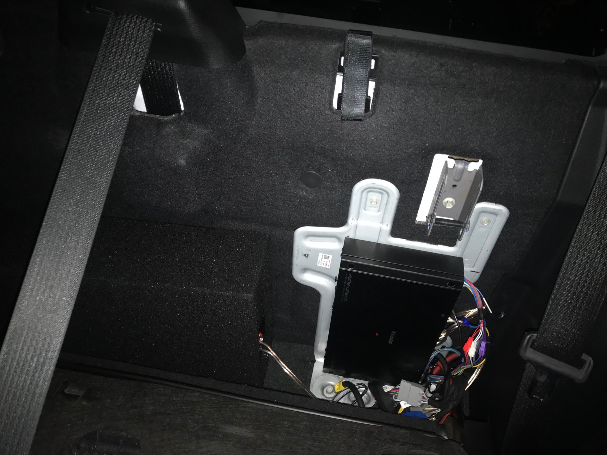

Here is a quick picture.

Cool. Looks like the maestro is on the bottom? Does the Kenwood share the same mounting points as the stock amp? Or did they drill the cab?
I wonder if the amp and maestro alone are worth the upgrade while saving the speaker upgrade for alter. I think the worst part of the system is the terrible Sony processing and ineffective EQ. I was streaming some music from Amazon the other day, and even with the bass EQ'ed all the way down, it was still a bassy bloated mess, as if the bass was turned up. I wonder if he factory sub is not affected by EQ settings....

From: So Cal
All of my wires are actually hidden behind the plastic on the side walls (I pulled them out to check something).
I had to drill holes to make the amp fit onto the rack. The stock amp removes easily with a few screws and bolts.
The stock speakers are CRAP! I would change the speakers over the amp if you are thinking of only doing one.

Looks like the JL Sub speaker grill got crushed by the seat? Otherwise looks good. Thats one thing i miss on my Mega cab Ram lots of room for subs and amps.. Cheers

No issues at all... Well there is a weird quirk that when a chime goes off your drivers door music gets cut in half. AND if you have 2 chimes go off at once the music in that door cuts off 100%.

It did crush the grill, but the grill is there to protect the sub, so it is doing the job well.
