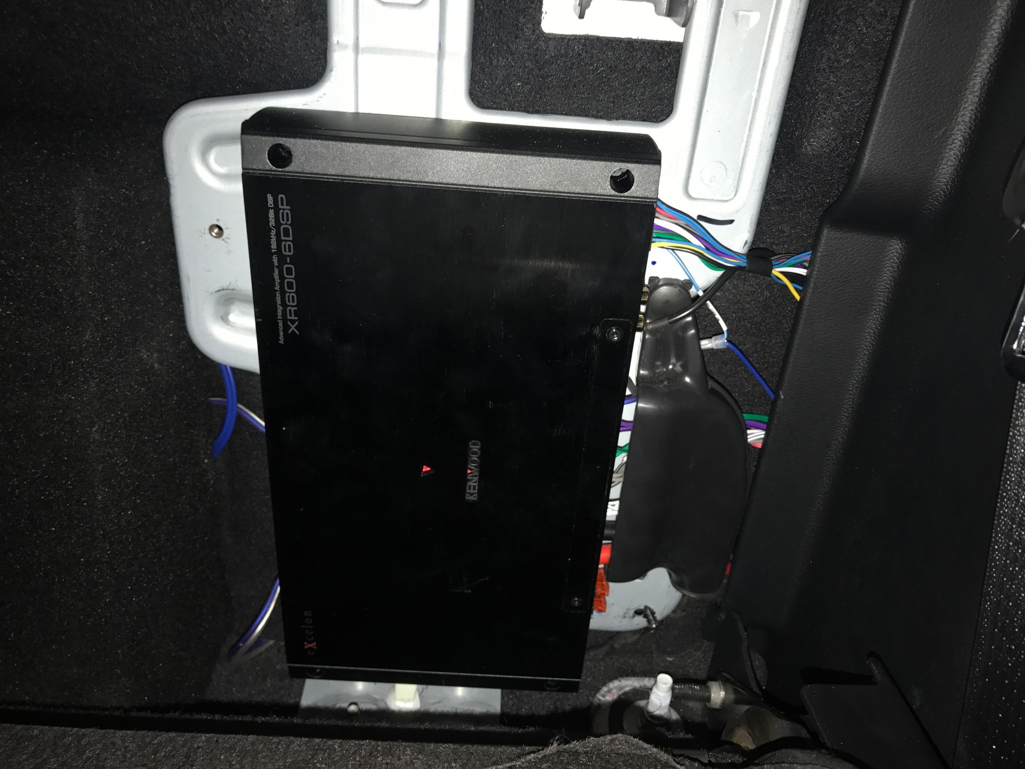

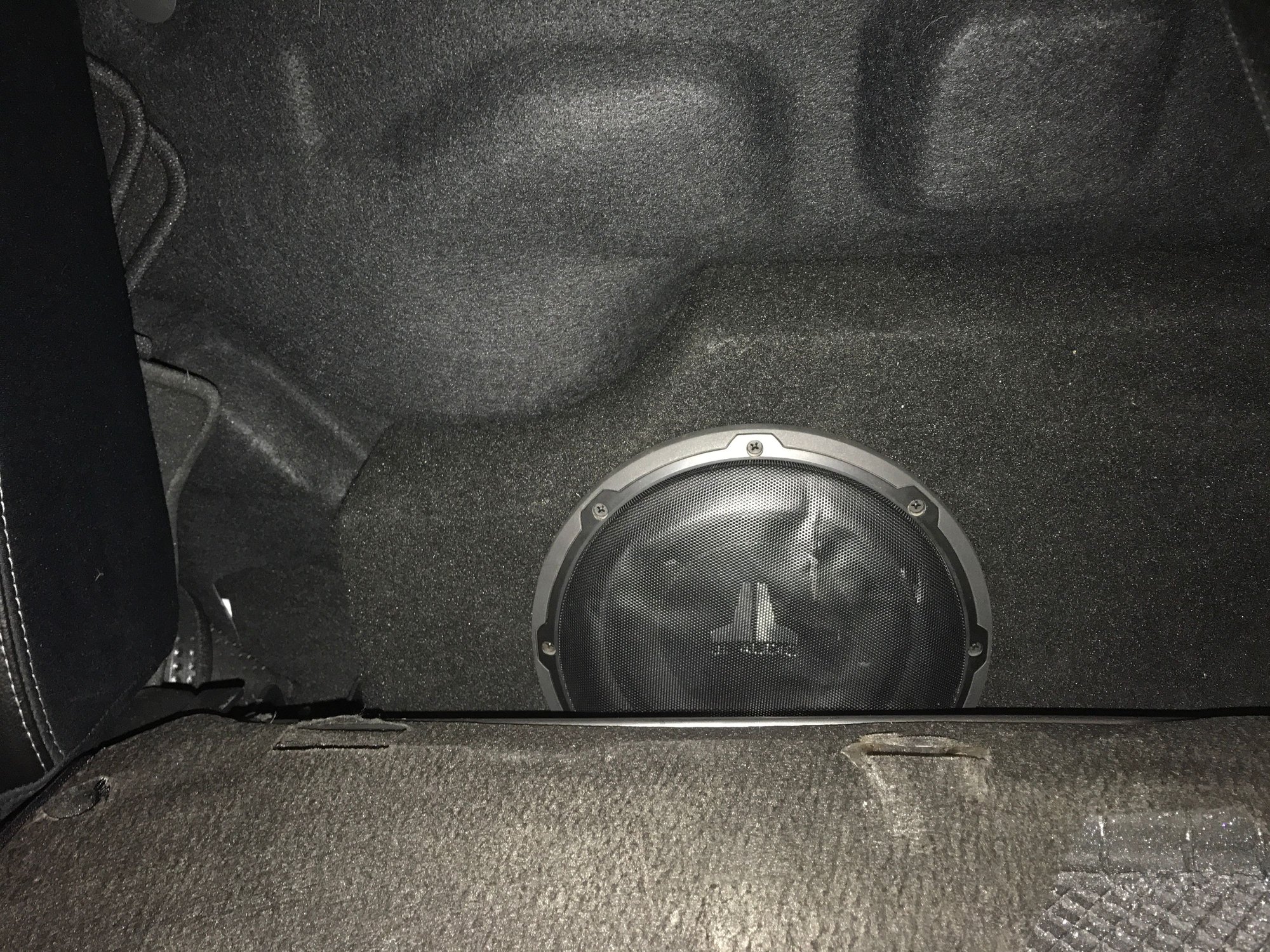

We had to make a few changes after dropping my truck off since the 8" box did not come in on time. They ended up making a custom box and fitting a JL Audio 10W1v3-4 10" behind the seat. The amp is extremely easy to use and get setup, I still have some tweaking to do with the DSP setting, but I am blown away by how good this system sounds without the final tuning finished.

I love the clean install!

I think you should be happy the 8" sub didn't show up. To get a good punch you need a 10" miniumum, which you obviously got. I haven't even got my truck yet but am already dreading the sound system based on what I've heard from people. Question, I thought there were 8 or even 10 speakers in these trucks (Crew Cabs). But your only using the four door speakers. Was there a particular reason for this vs. trying to use all the speakers? Will that Maestro/DPS thing work with more than 4 speaker? Do you mind if we ask how much that setup cost?

The only speaker that wasn't used was the center speaker in the dash. The other seven were replaced (two tweeters, two front mids, two rears, and a sub). You are looking at around $1800 for parts plus labor. I think it was worth every penny.
