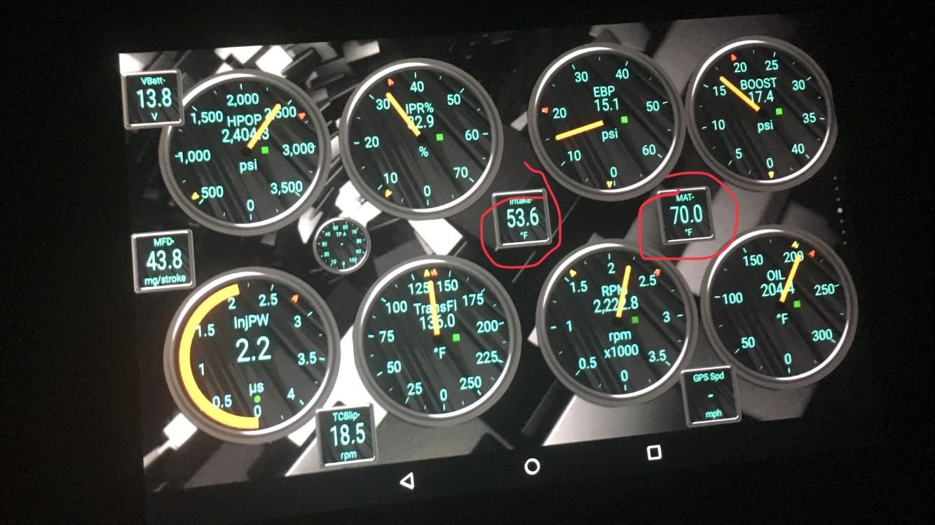

Here’s another comparison. Loaded the same, same hill, same speed, nothing changed other than the turbo. Note the difference in intake vs. manifold air temp deltas.
38r WW2 1200* egt
364.5/74.91 900* egt

Looks to be a cooler day also. Trans temp and oil temp are down quite a bit. Interesting that the FIPK is also down.
The 38R you ran I'm guessing was the older version? It's difficult to find anyone with any KC38R 366 info.

A 9 degree drop in ambient will not cause a 300 degree drop in EGTs, but a 300 degree drop in EGTs will definitely result in cooler engine and trans oil since both are cooled by the coolant going through the radiator, which is behind the intercooler.
FIPW is a pretty dynamic number for a screenshot, but now that I’m burning what used to be smoke out the tailpipe, I need less throttle to maintain speed.
38r was bought new in 2013 from Riffraff.
I’d also like to see some KC videos, other than a quick WOT run.
