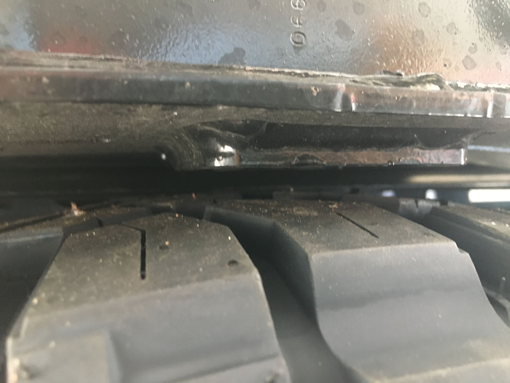

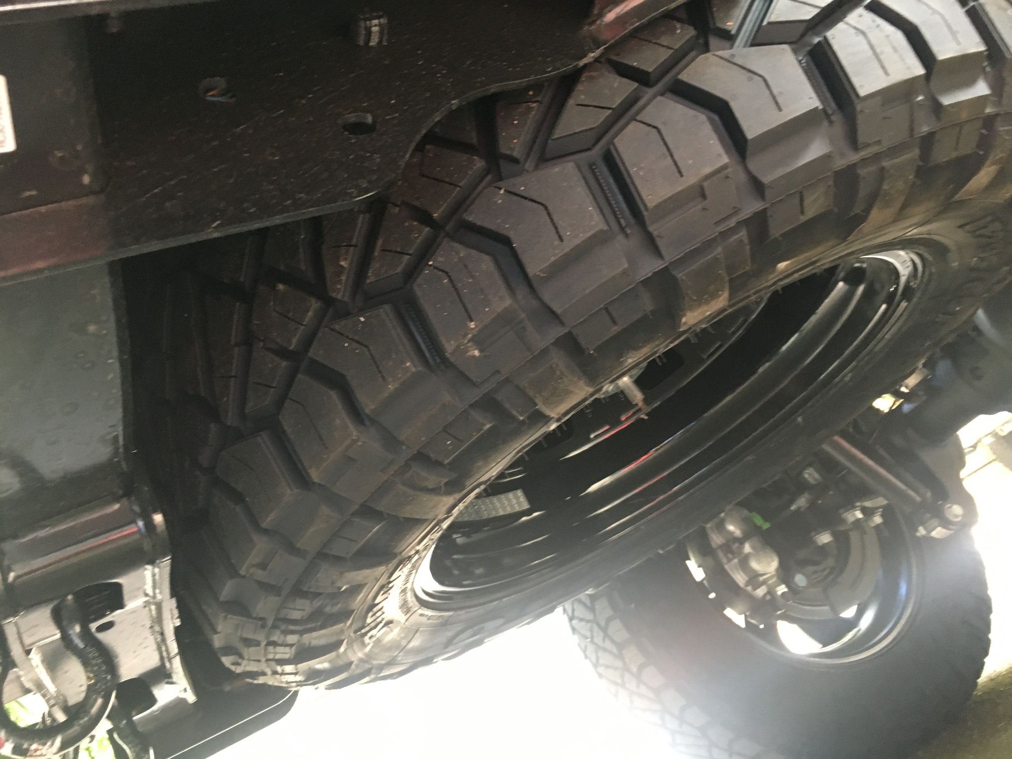

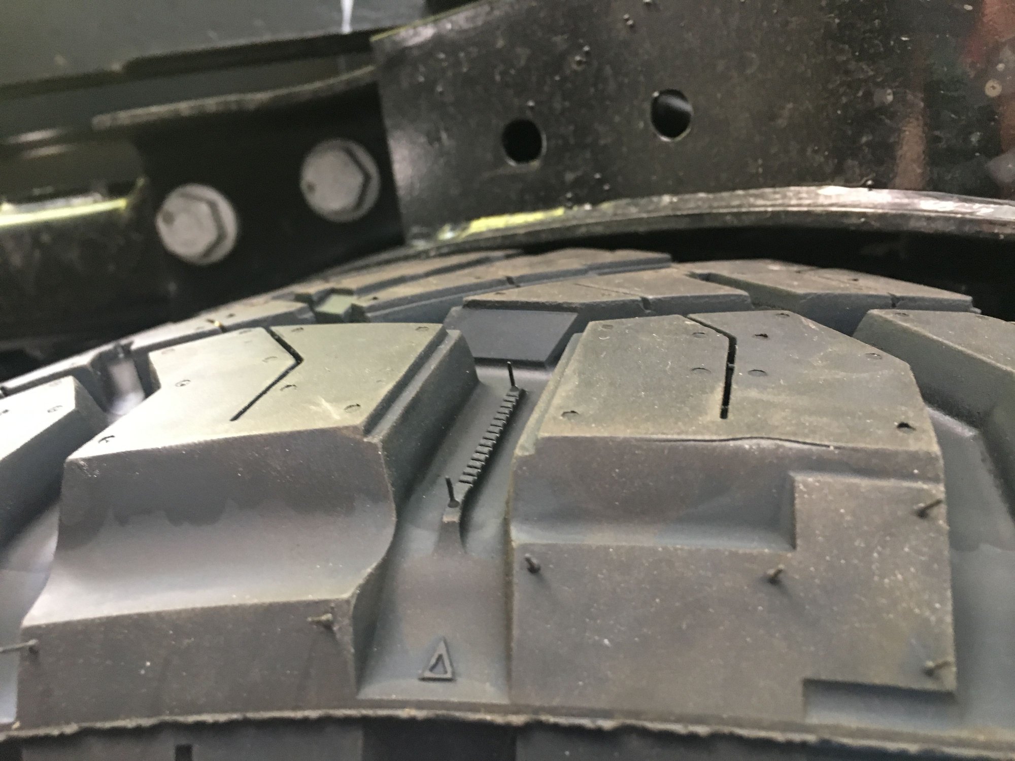

I have a nitto 295/65/20 under mine and that’s as big as you’ll fit. It was touching on 3 sides.
