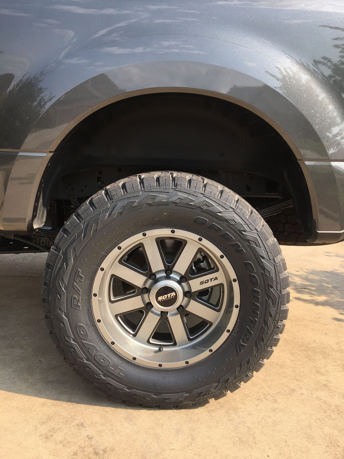

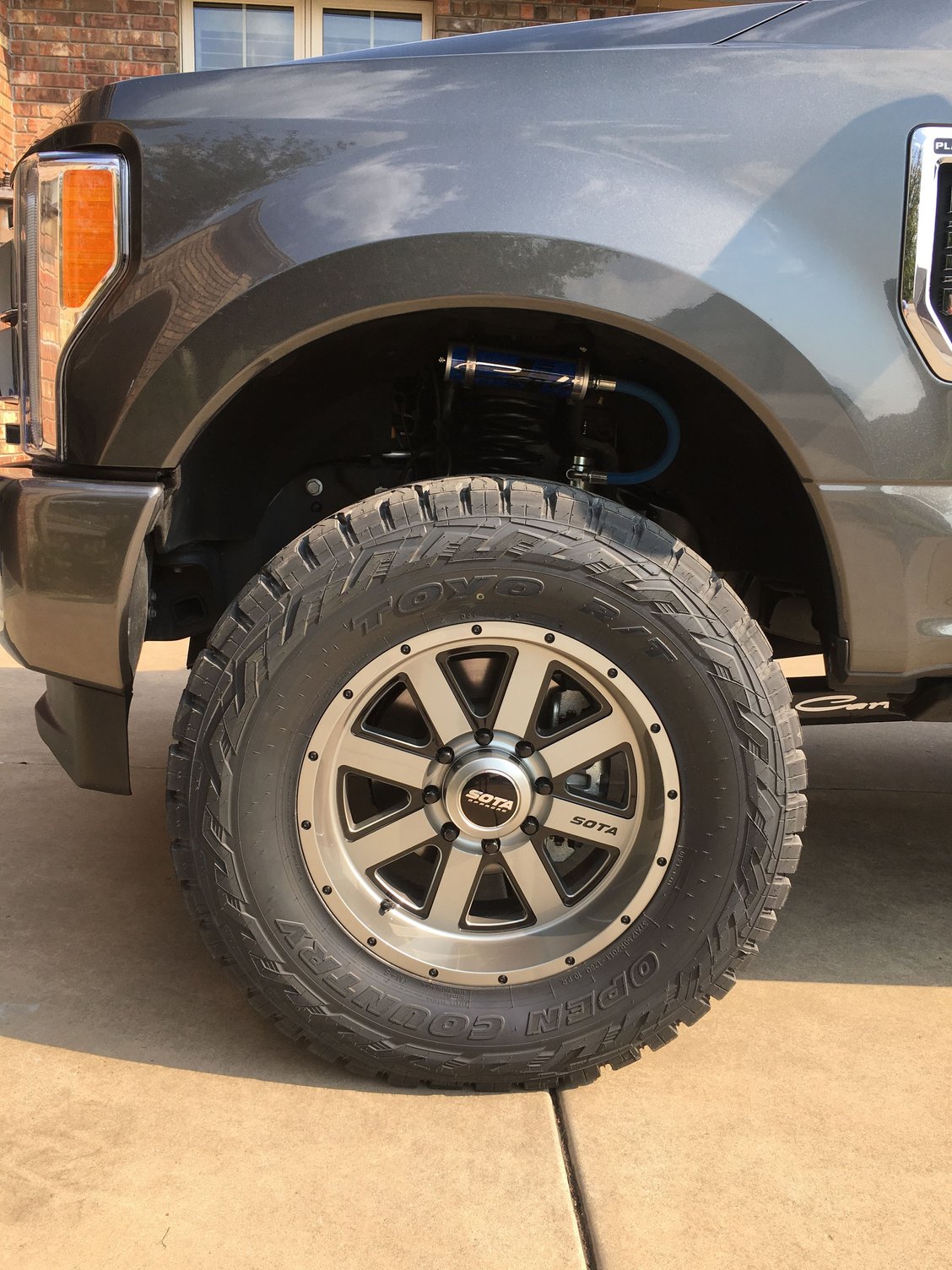

Just updating in this thread. Pretty happy with the 2.5 Pintop. I'm still running pretty high pressures in the tires because I have to tow on Friday and didn't want to mess with it. Ride feels really good. Took some getting used to with having the hood level and not looking over it with the factory rake. Made me want to elevate my seat at first! 37x12.5s on a 20x9 rim with 5.5 backspace. Did have to trim a bit on the inner rear part of the front wheel well, but mostly the plastic molding. I'm finding myself looking around for bumps to hit just to see how it goes. No problems with handling that I can tell. I've been up to 80 on the interstate and it's pretty steady. No bump steer or wobble. I haven't turned on the lane departure yet, but I don't really ever use it anyway. The first night I got it back I was getting high beam flashed a bit, so I took it home to lower the headlights which is a pain. Plastic parts that don't want to move tend to break. Especially the front right which uses a cable system to adjust. The screw head basically separated itself from the cable. Parts are on order at the dealership. Here are some pictures. Happy to get more if there's anything in particular you want to see. Anxious to get it on some Forest Service roads next weekend.
Before
After
Before
After
i have the poor peasant version of your truck, XLT with chrome appearance package....i gotta say, those BMF's sold me. they look great with the paint color of the truck. Also jelly of the pintop kit.
