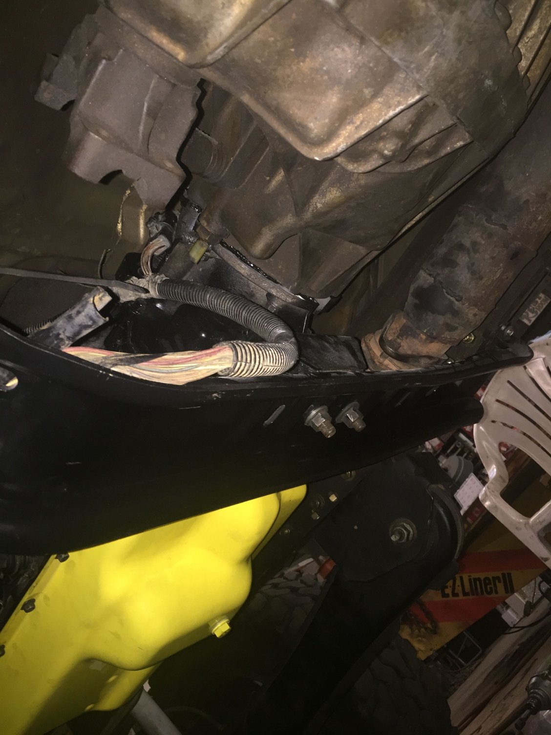

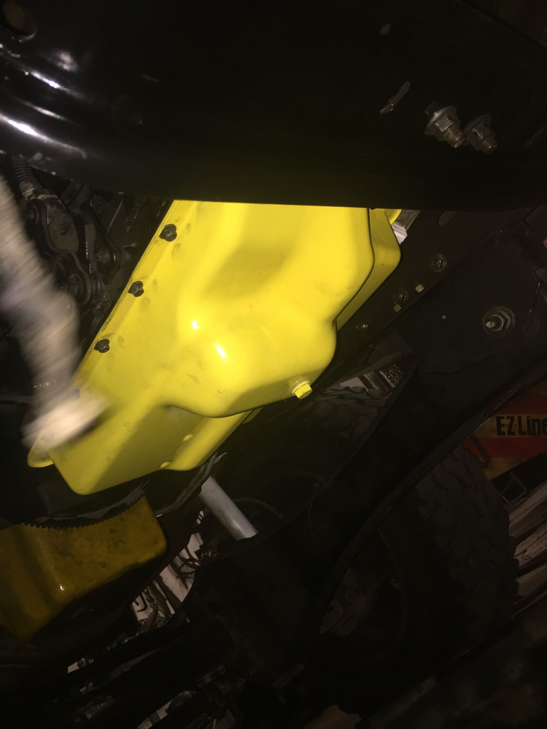

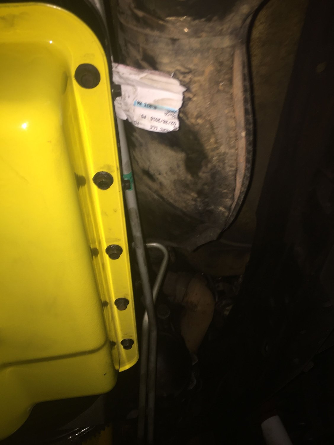

Got trans in and most the stuff swapped over have hand full of things left to swap and I can take it for a drive once I know everything functions I’m gonna pull seats. Swap the carpet and pedal box and hopefully be good to go.
