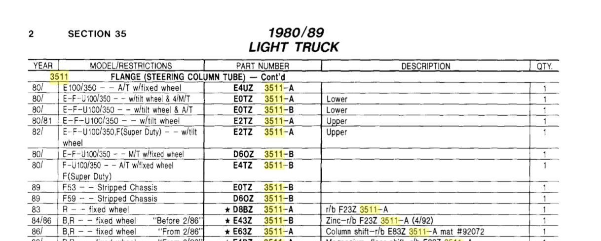

Welcome to FTE! That truck has possibilities. The steering column illustrations are here: Electric Fuel Pump Control - ???Gary's Garagemahal. However, the part you need is number 3511 and I don't have the part numbers for that shown on that tab. Let me know if you need it and I can add them. Anyway, if you had the number you could see if there is a new one available. Otherwise you'll need to go to a salvage and get it. But they may want you to get the whole column.

Old Apr 26, 2017 | 09:34 AM
NumberDummy's Avatar
NumberDummy
Ford Parts Specialist
Posts: 88,826
Likes: 785
From: Simi Valley, CA
Originally Posted by neoniacin
I just picked up this 1981 F-100 Custom cheap from a police auction. After some tinkering I replaced the battery and starter solenoid and it fired right up.
It is in need of some TLC and I'm up for the challenge! The major issues I'm aware of are:
Lock cylinder casing (upper steering column flange) looks like someone took a crowbar and hammer to it. Lost the key I'm guessing? or maybe someone stole it. Police said it was a DUI seizure.
Anyone out there know where I can get a replacement? Right now the truck is started with a screwdriver or a home light switch that I believe the police added so they could move it.
E4TZ-3511-B .. Upper Steering Column Flange / Obsolete
1980/89 F100/350 & Bronco with A/T and fixed steering wheel.
Only 1 may be available NOS .. I have to call the source (SoCal) to verify the part number, as he eliminated the suffix.
Note: Below the ignition cylinder is a snap ring, flat bearing and brass gear. Looking at the damage, I don't see them.
DOAZ-3C610-A .. Snap Ring-retains ignition cylinder / Obsolete
CARPENTER NOS OBSOLETE PARTS in Concord NC has 10 = 800-476-9653.
GREEN SALES CO. in Cincinnati OH has 170 = 800-543-4959.
D6AZ-3E700-A .. Bearing / Obsolete
GREEN SALES CO. has 122.
D4AZ-3E717-A .. Brass Gear / Available from Ford
GREEN SALES CO. has 5.
