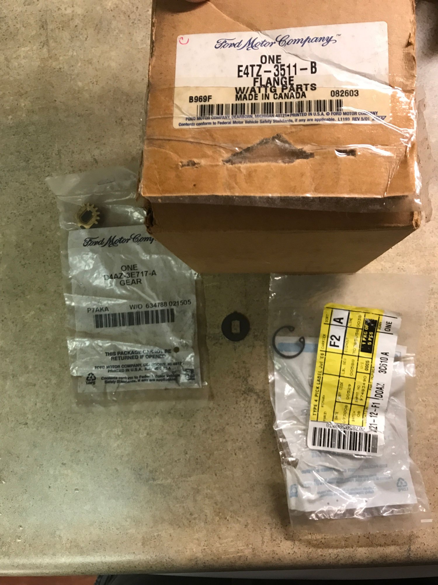

D6AZ-3E700-A .. Bearing / Obsolete
GREEN SALES CO. has 122.
Where is this? I don't see it in post #51.
Old May 2, 2017 | 10:56 AM
  #54
neoniacin's Avatar
neoniacin
Joined: Apr 2017
Posts: 99
From: NE TN
It is the part not in a baggie in the middle.

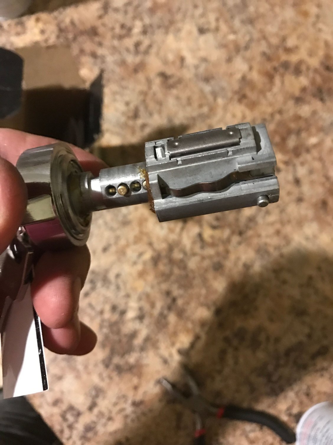

So I got the column repaired but had an issue with the cheap lock cylinder. It came apart as I was wiggling it to remove it from the column after a test fit.
Thats what I get for paying $10 instead of getting a quality part. Ordered the motorcraft cylinder. Should get it today.
