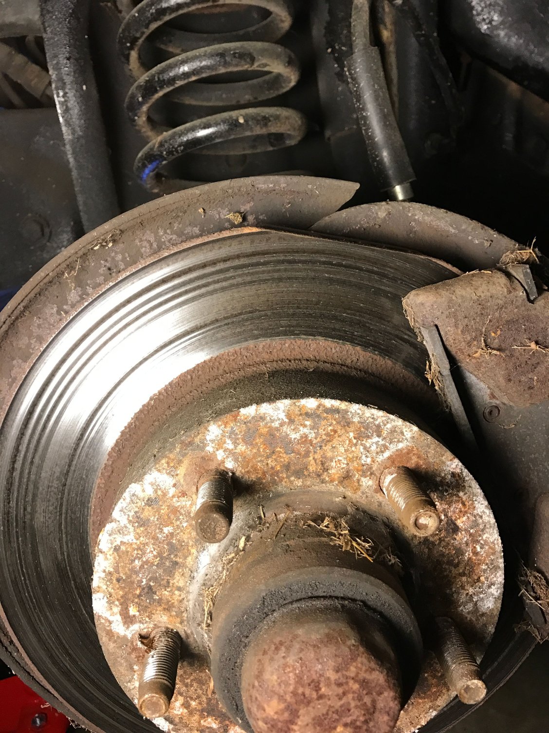

Oh and I wanted to share the rotor on the driver side. How would the flattening happen? Just curious...

Rotor got flat spotted when the wheel fell off and the truck skidded down the road.
