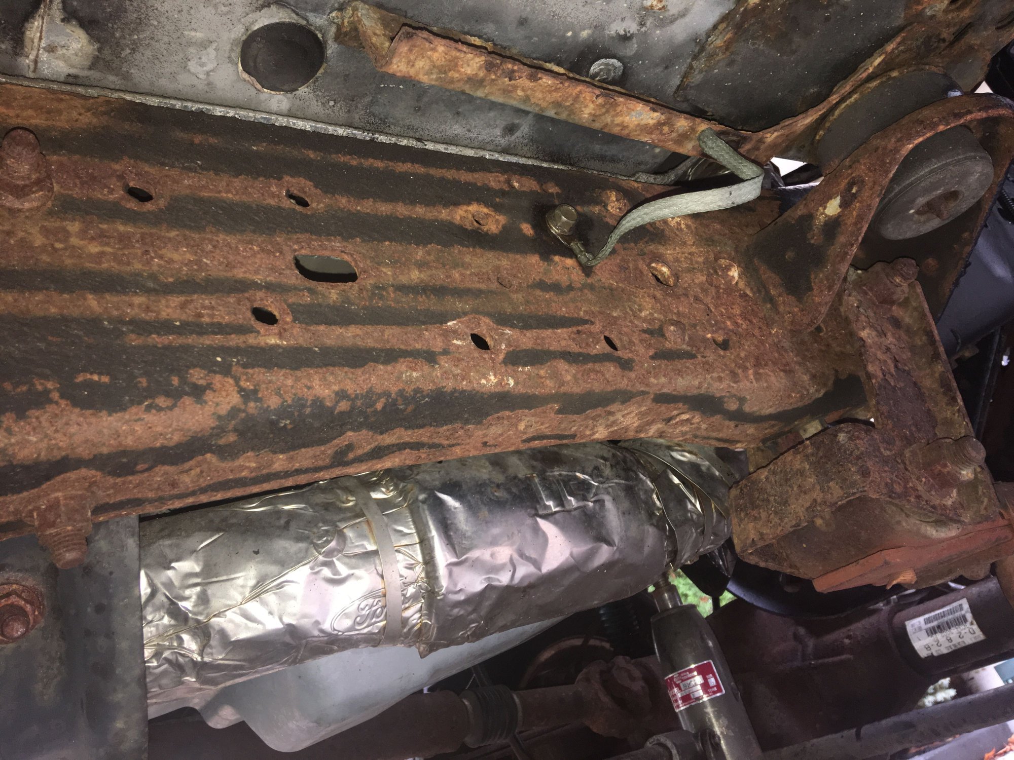

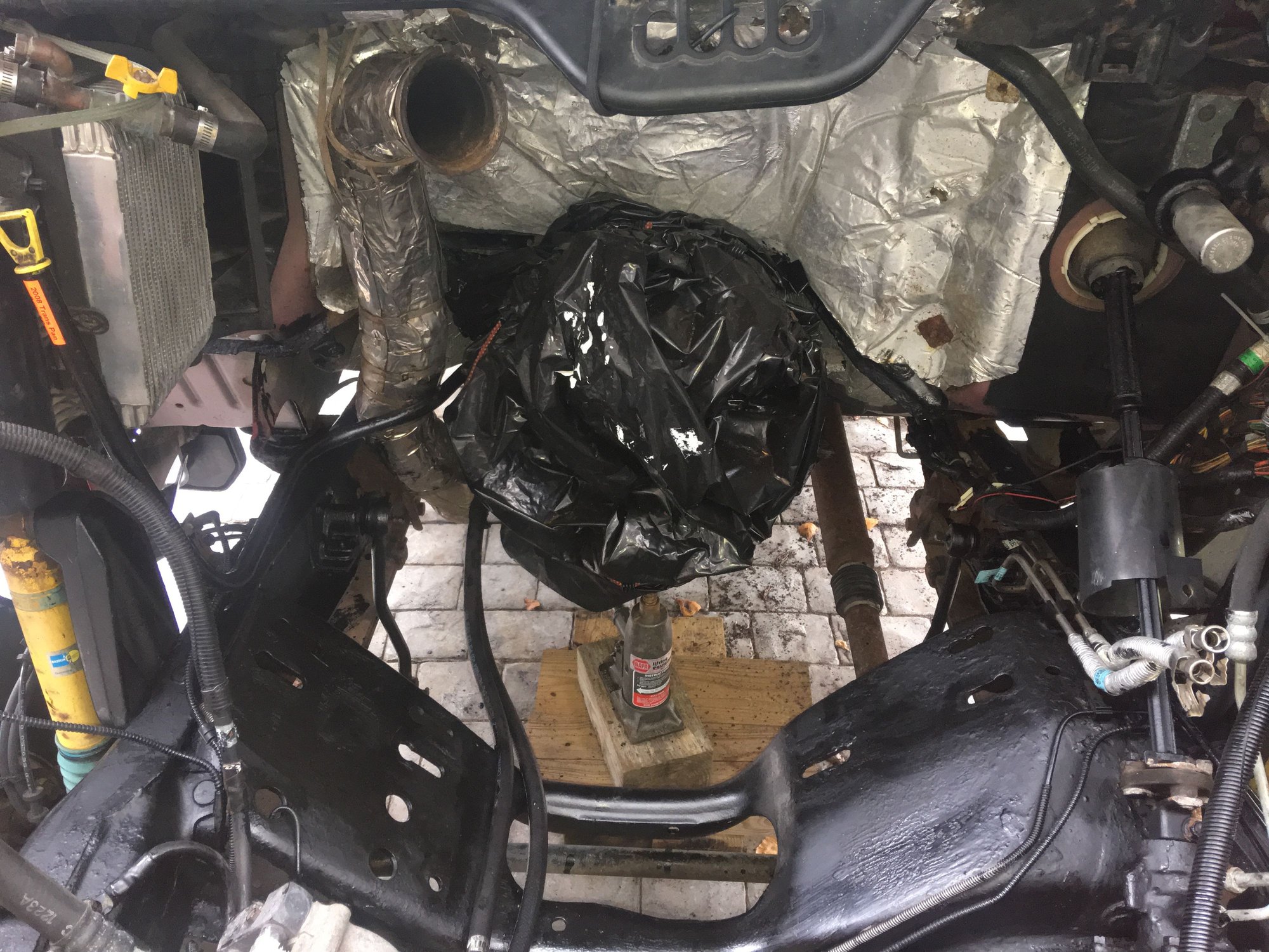

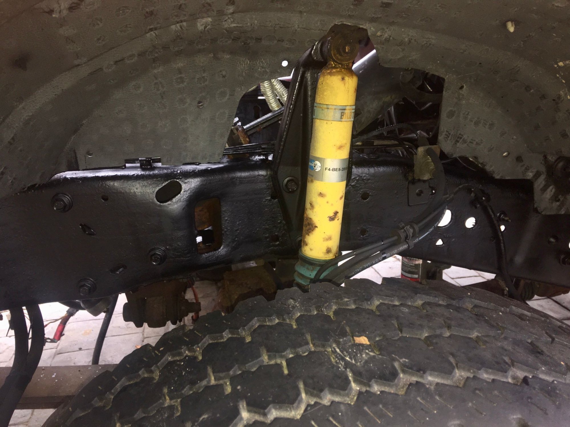

You had to show the underside of your truck.
This Jersey truck has the crusty, thick flake rust in capturing areas like many northern, and especially Jersey Shore trucks. No time to get real deep into it, but while the motors out .....
"While you are there ....."
As with many Jersey Shore trucks of this age (unless you had the forethought of Fluid Film) strong rust with deep flakey component. But the electrical connection is good!
Needle scaler, wire brush of die grinder a little (need the rust for POR 15), Zep degreaser, power wash, degreaser, power wash, let rust form on bare areas for two days. What didn't have a rust base for the POR will get Eastwood Encapsulator. All the rusk flakes that came off are on the driveway.
Internal frame and other areas may get done in the spring. For me, semi-gloss black is correct for a frame, especially when it's not smooth.
Probably put an hour or so into it total.

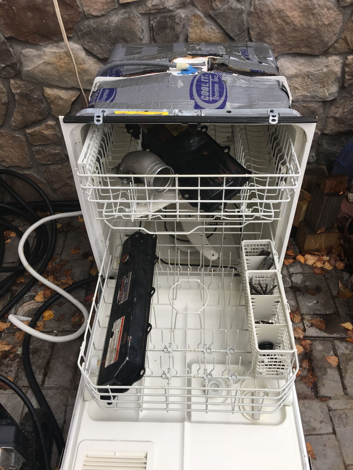

We replaced out old GE dishwasher with a Bosch a while back. I rebuilt the GE about 4 times, soundproofed it, but it was time. However, I couldn't put it to the curbside.
Meet my outdoors parts washer. In this corner I've got electricity, garden hose, and sewer clean-out.
Nuts, bolts and other parts that need degreasing, or degreasing before acid bath, and the other funky things you're going to paint.
What's proper for a Powerstroke? Pots and Pans, sanitize, I wonder if they make an automotive appropriate replacement front plate .... depends on the parts, plastic or metal.

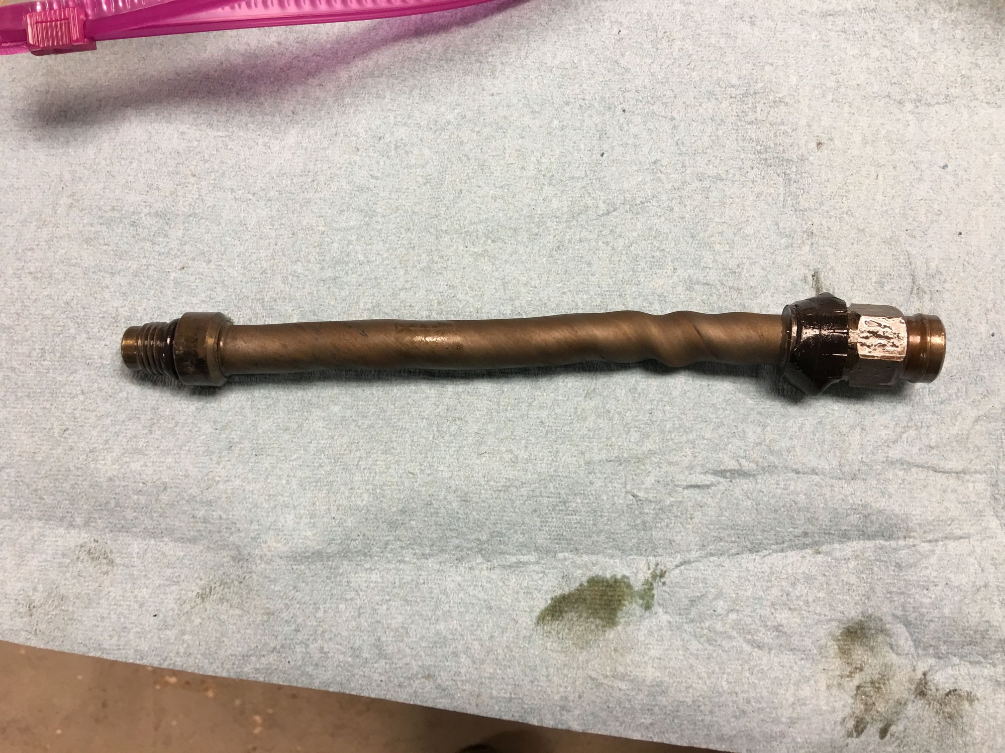

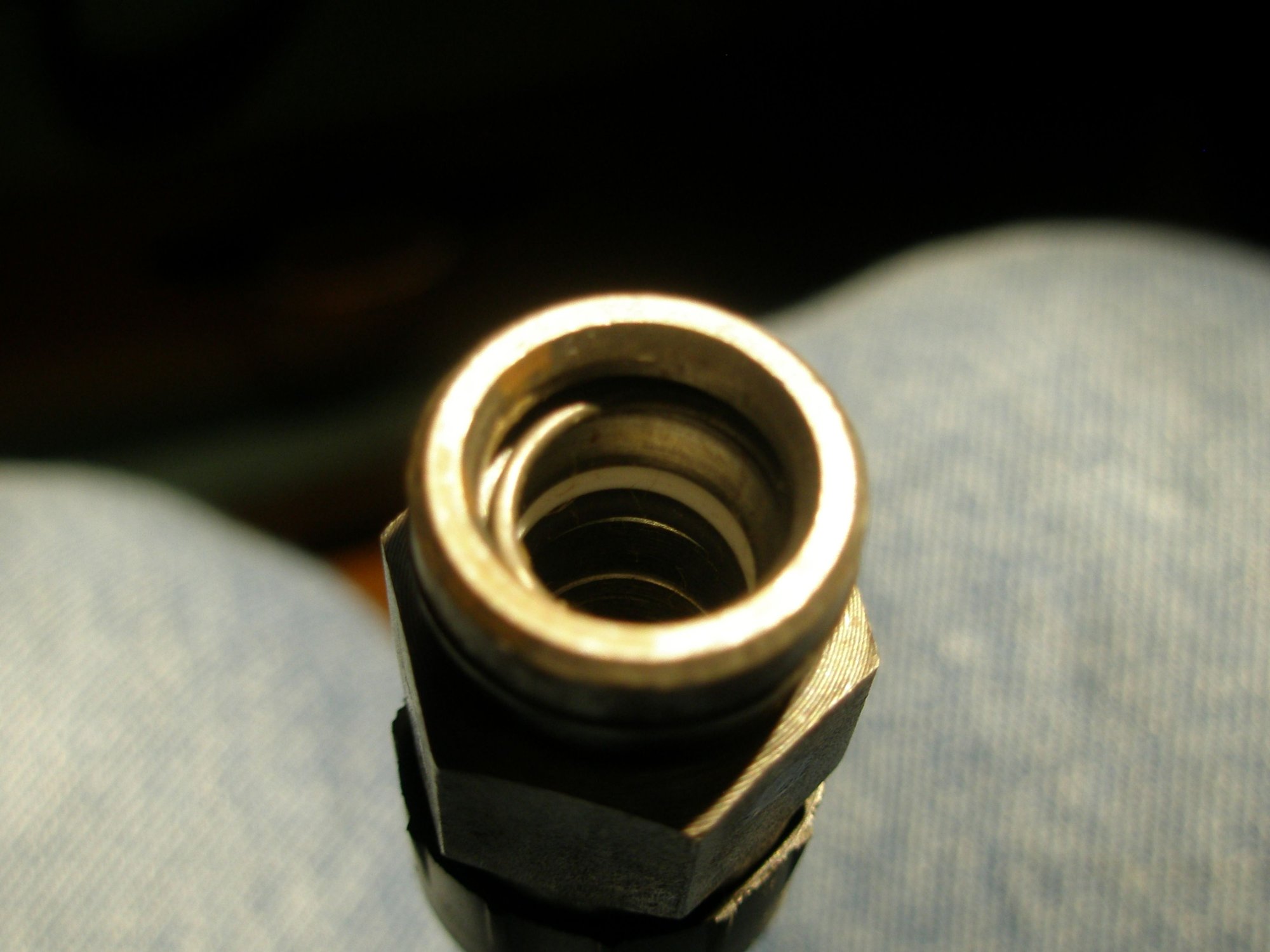

As much as I thought the driver's side stand tube was tough to break free, it had nothing on the pass side. I know I have about half the strength I had two years ago, but this was nuts for a O-Ringed connection.

Damn Jack!!! I would have hated to cross you two years ago. . The way you twisted that up I would still hate to cross ya.

Jack, if you're wondering, I've seen them come out hard too. The last 03 that we pulled heads both tubes twisted. It was a factory original virgin with popped gaskets with 78k miles IIRC.
Looks a little past the TTY point.
EDIT: You should clean that up and frame it.

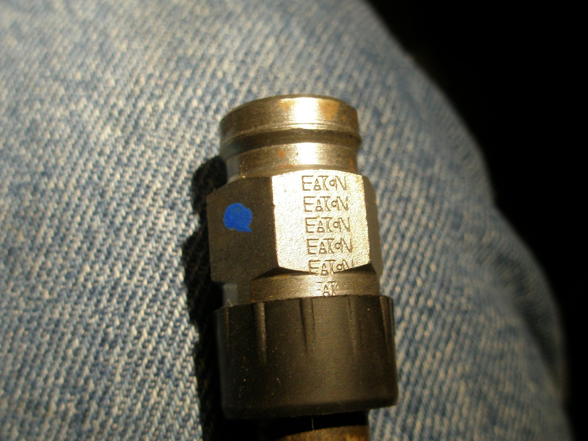

Fel-Pro has these tubes. I'm using them right now. They're made by Eaton. The old Ford ones I took out were the same. It's stamped on the hex. Fraction of the cost of Ford. You may want to look in to them.

Bill, thanks. I was looking to buy those but RA one had one left on a closeout for $20 so I went to ANWB at $78 each. While that sounds stupid, I wasn’t sure of the source and wanted both the same.
The aftermarket has a lot of parts that are from the OE supplier. There are very little parts that companies even like Ford make today and even with aftermarket parts are cross sold to remarketers where it’s too expensive to tool up. Mostly in the car lines it’s motors and trans that the parent makes, and a lot of internals are sourced. Went you get to commercial trucks it’s even less. We once had our quarterly Sales/R&D meetings at our SC plant so we visited the Freightliner assembly plant. Those in the group who were not motorheads afterwards were astonished and kept talking about “All they do is assemble parts”.
Eaton was one of the best companies I ever worked with. I understand they were the original suppliers of our lifters, then shut that down and they were OE sourced from Delphi. That may be the “8” change in the part number.
Danny, long breaker bar. And the stand was stable as hell.

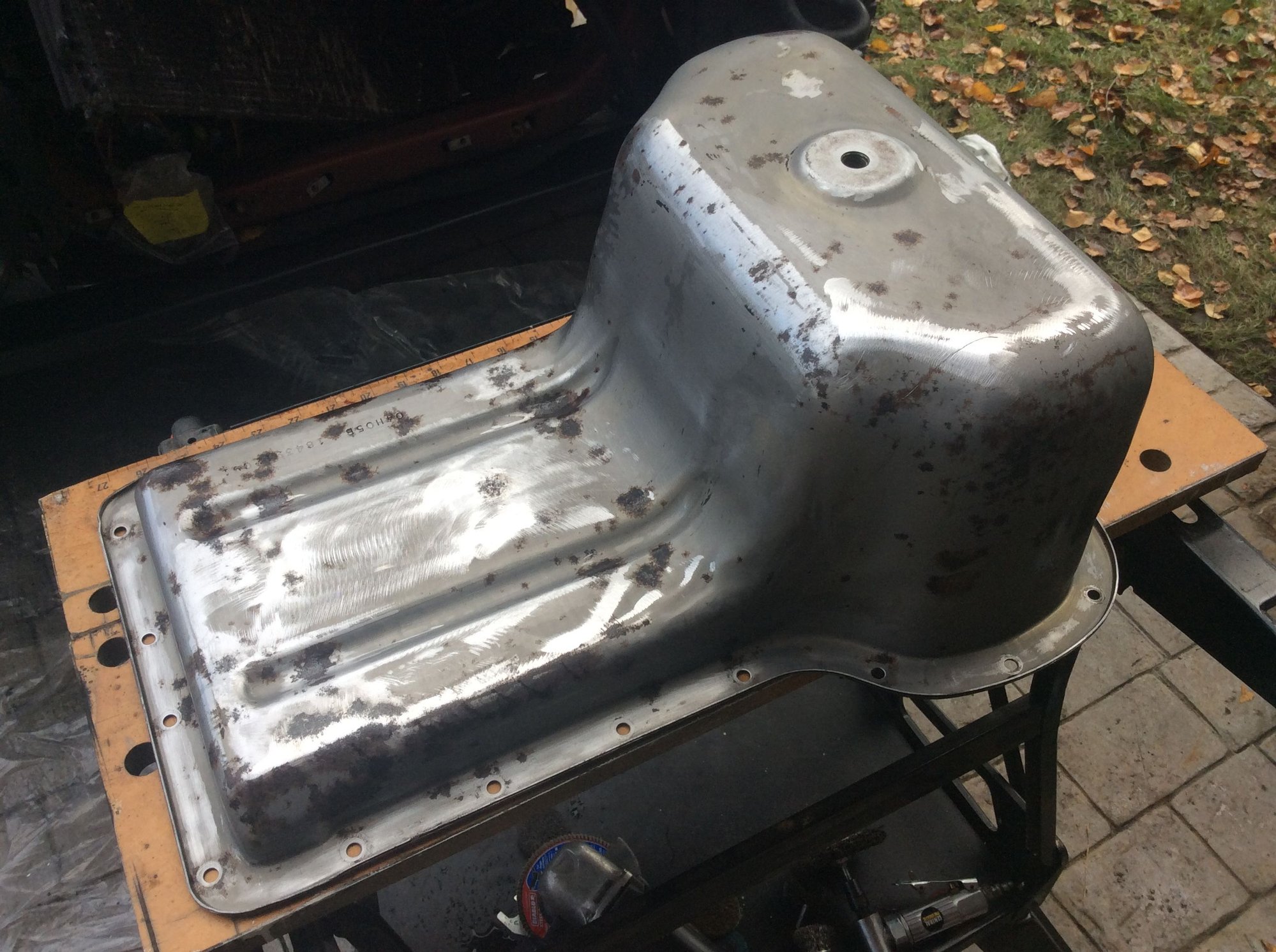

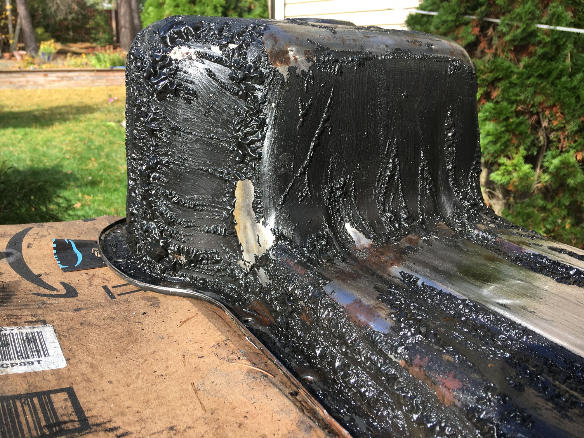

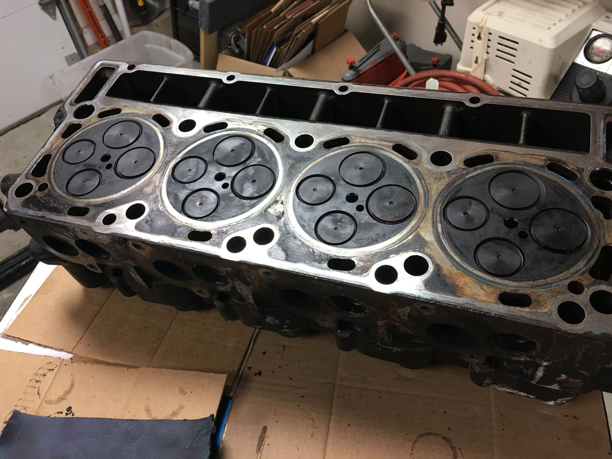

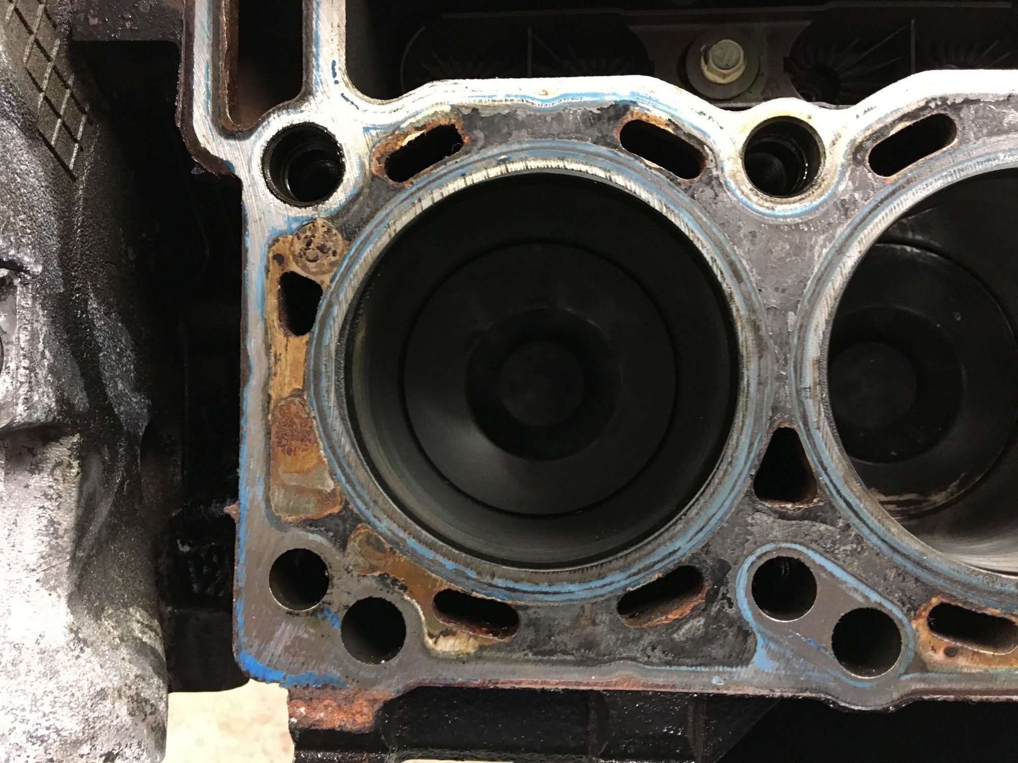

Thought I could just touch up rust spots on the oil pan, but when scratching up the heavy paint surface that the rebulider put on it became obvious that more rust was prevalent. So a 15 minute task became two hours.
Drivers side head off. I choose poorly. It needs 20mm head gaskets, I ordered 18mm for this 2003. I should have known as the Ford rebuilding brochure mentioned new heads, not remanufactured, and the 20s were in production.

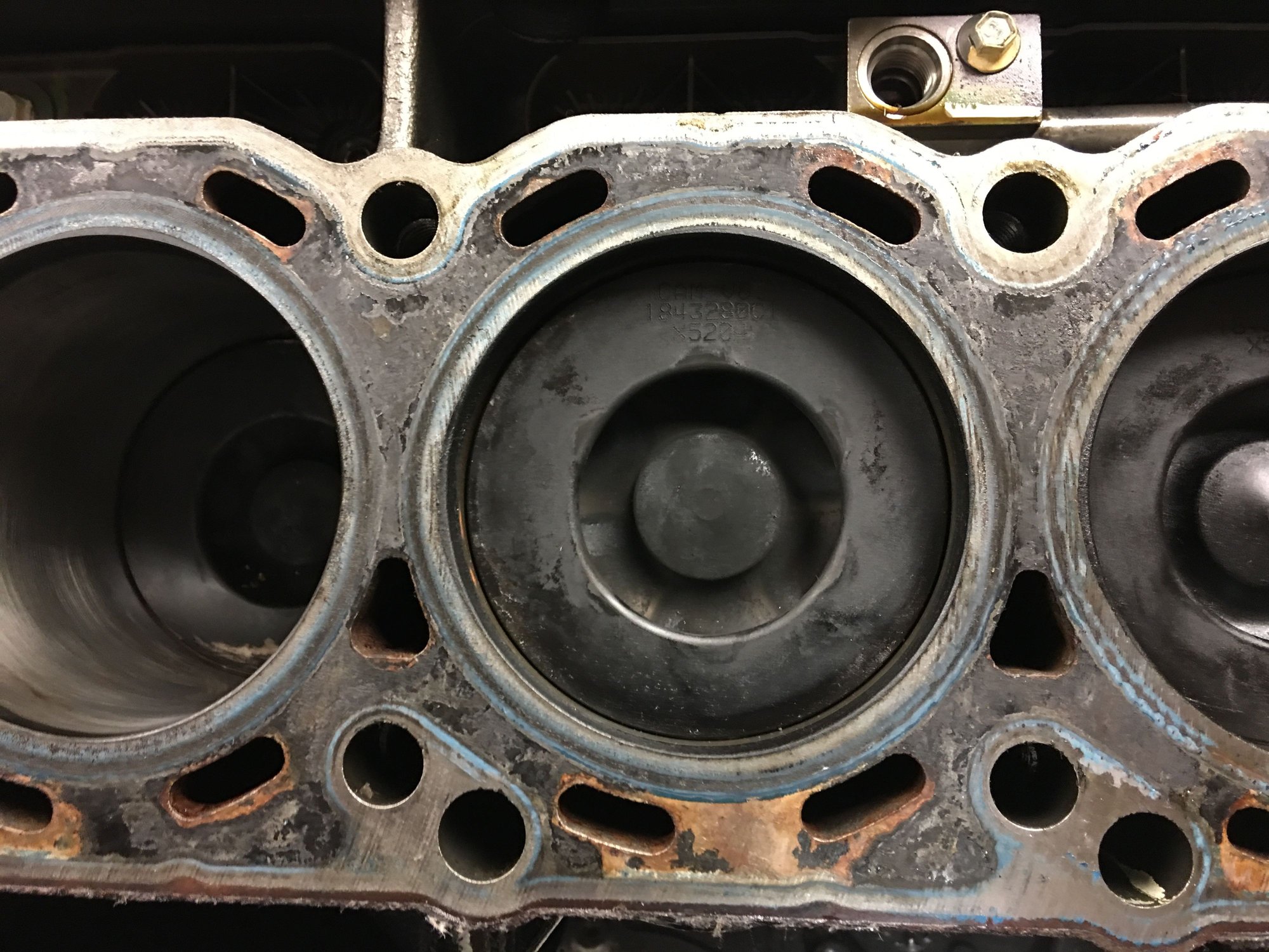

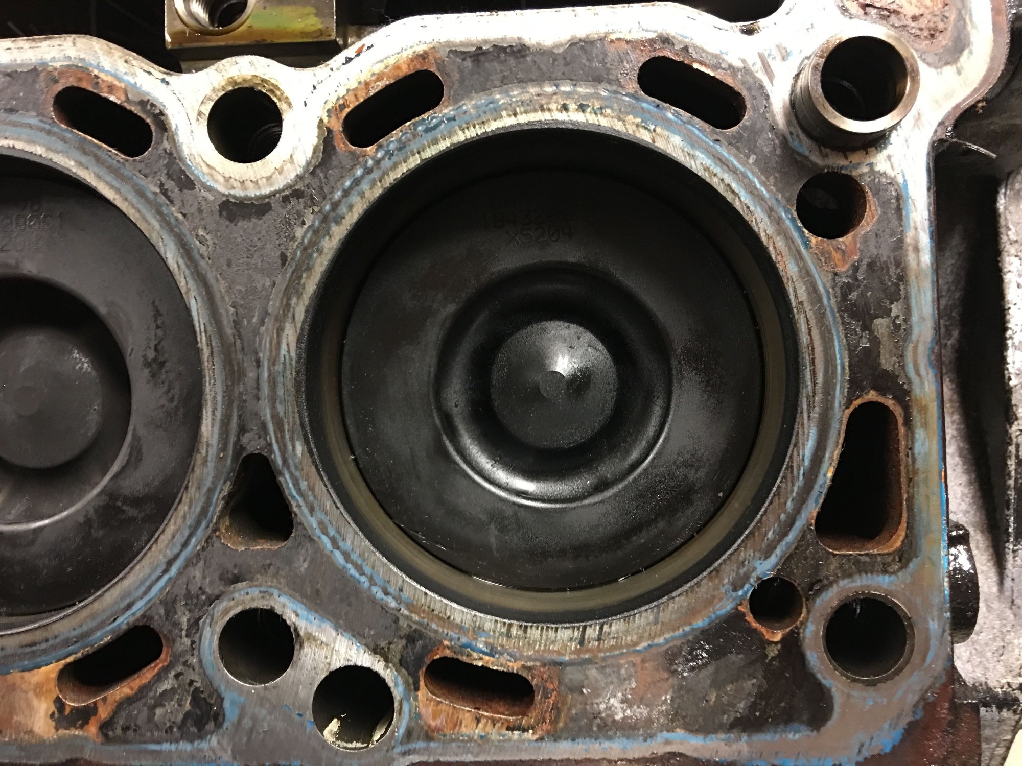

Cylinder 2
Cylinder 4
Cylinder 6
Cylinder 8

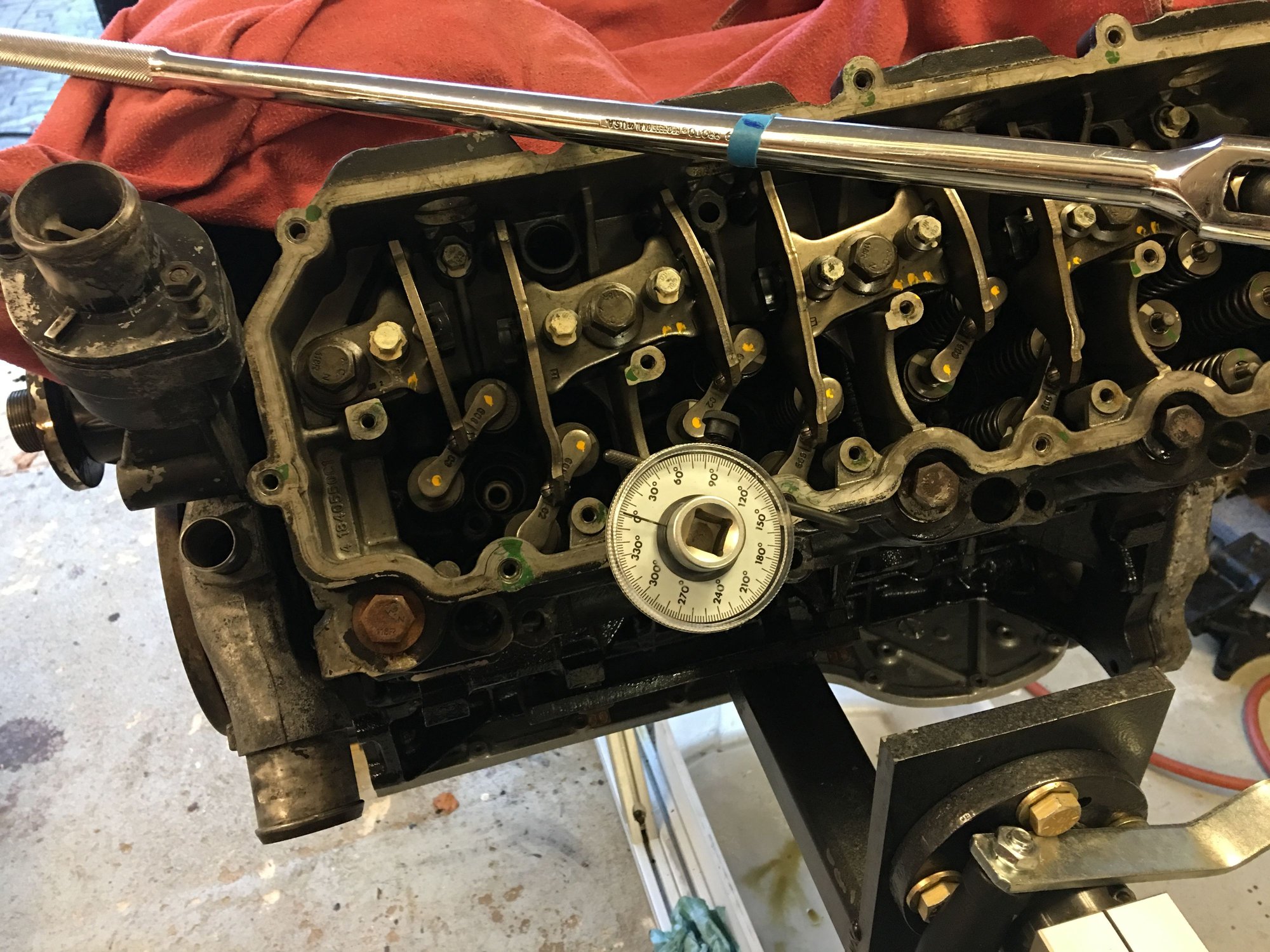

I've watched technicians vids, and I remember when a rebuilder got a motor back (Anthony returned?) they blow off the head bolts with an impact. That's not the way I ever did it, especially after we had measured rotor distortion from improper tightening procedures.
So when I pulled these, just like I've done on 289s, I back off 45 degrees per bolt in the opposite sequence of the install, then another 45, ....... It's not all about the even clamping force between the bolts, but also compressive stress across the head. I'd rather remove them evenly. At least in my doing the work.
So a question for you guys who have been into the 6.0s. In the service manual it states to toss the dowels and replace. I've never come across that before.
