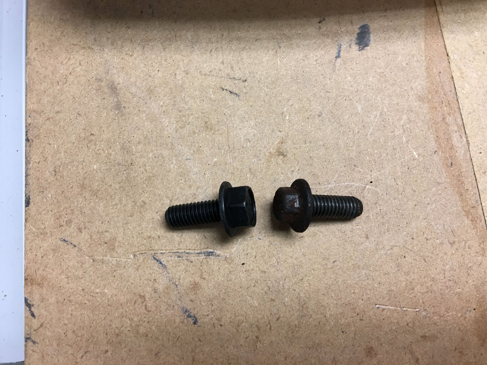

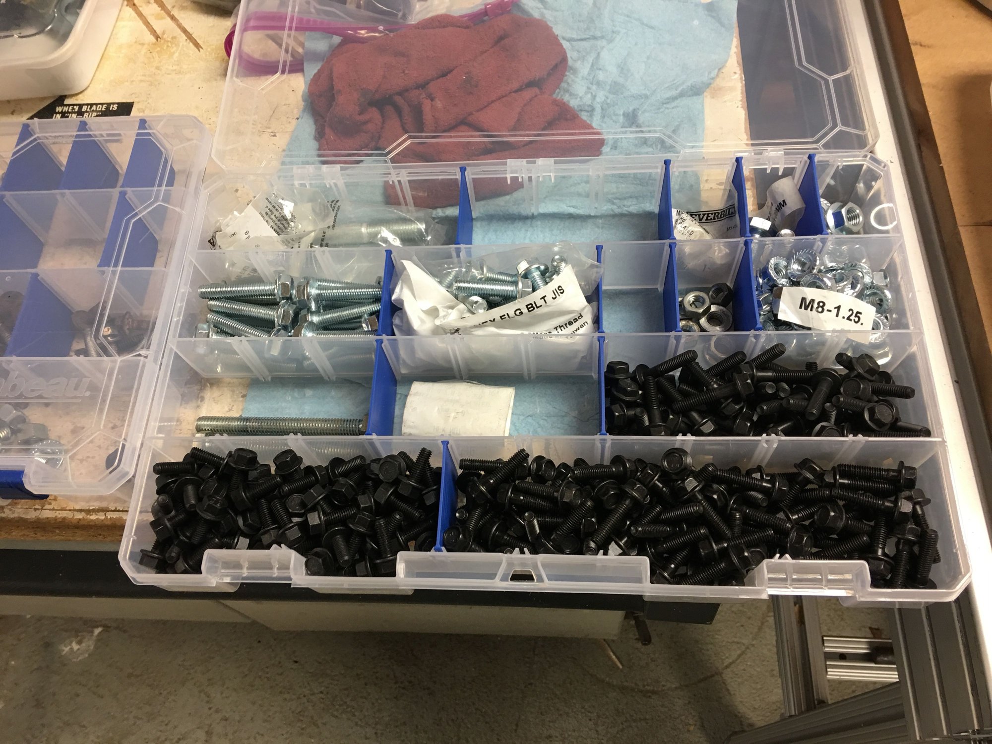

The oil pan bolts are pretty rusted on this truck, along with a few other. If you really wanted to stay OE it would cost a fortune to replace bolts. There is always something a dealer is going to have to sell you, but in cases like this I buy a package of bolts from sources like McMaster. 50 bolts cost what 10 would at the dealer, and I can live with one size up on the hex.
Your not kidding on that. I needed to replace the nuts that the bed bolts went into on a 1988 Ranger 2.9 EFI.
Dealer wanted $12.00+ each. I stopped at the local industrial fastener supply house and got all 6 for about
a total of $7.00 + sales tax. The real kicker was the nut that the dealer was supplying me with was not even
the J-nut type. It was just a regular 10mm or 12mm flange nut. That was way back in 2001. So it was not even
like I was using something with a different hex size. What the dealer pulled out to show me looked like something
you would find at Lowes or Home Depot if they had stuff that large in metric stock.

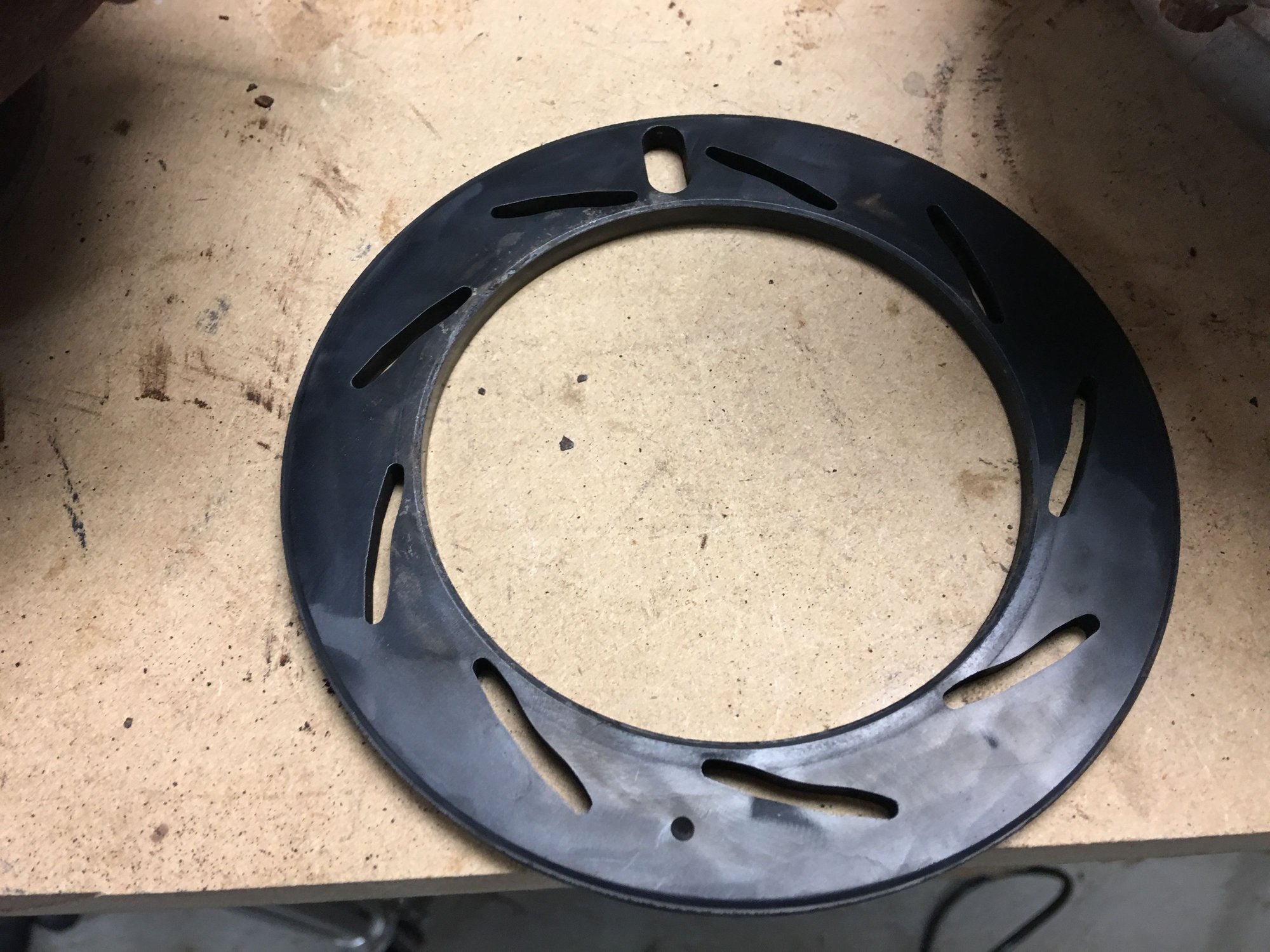

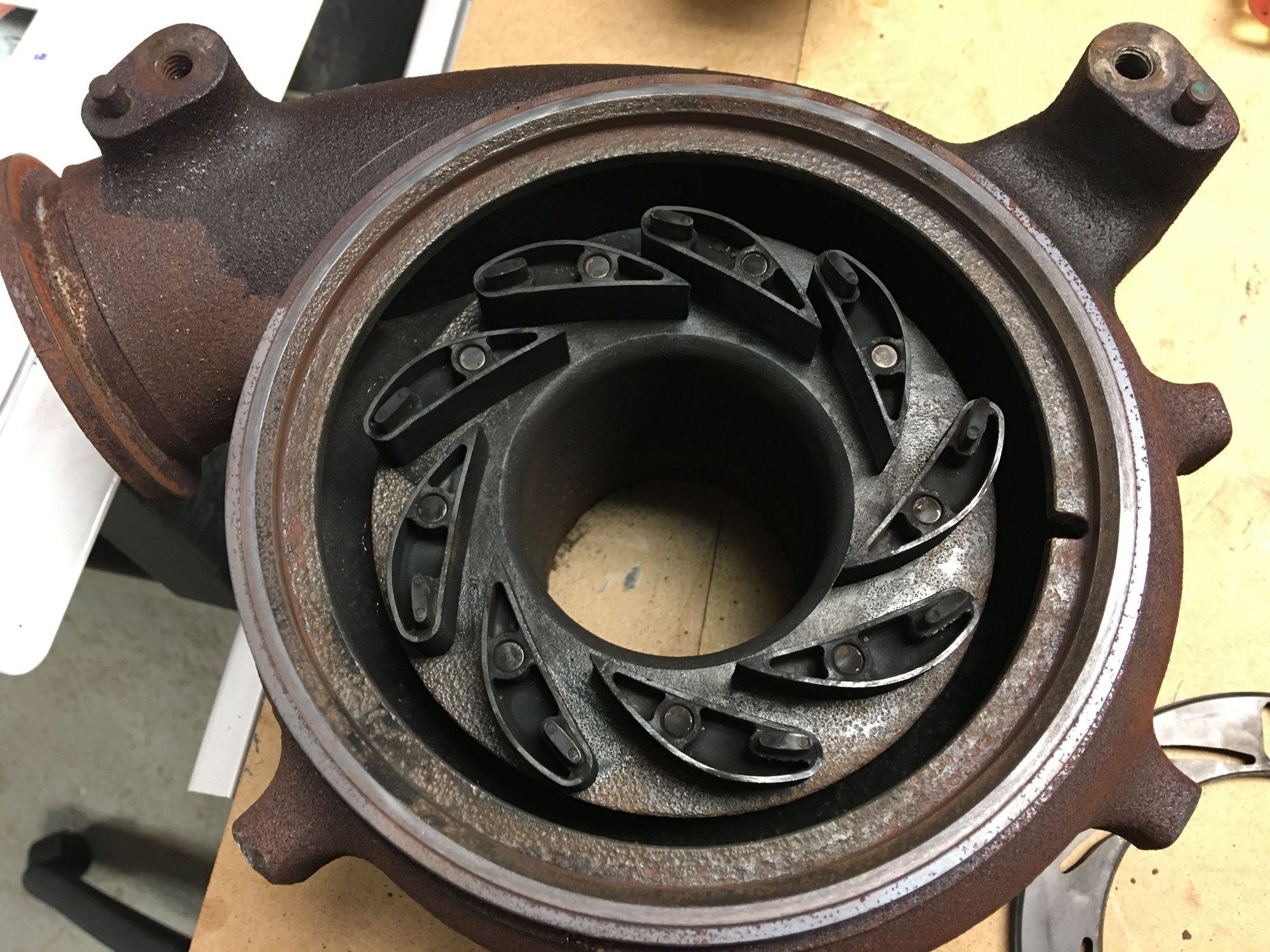

Since the turbo sat unspun for 6-8 months thought I should open it to check for corrosion. This turbo was put in 2 years ago when I though the injector smoke was turbo seal smoke. Anyway, it was free and just touched up with wire wheel lightly after the picture.

Jack you just gave me a thought. A person that knows that a truck is going to
sit night benefit from a can of fogging oil into places like the turbo. But they
would have to pull a pipe to get into the exhaust side of the turbo.

What I thought was interesting is this was a wet summer for us, plus for my roof size our gutter is a tad undersize. When we get a heavy rail it spills over right in front of the truck. I really thought it was going to be a problem going back on so I pulled it down.
Anyway, thought I'd show it's interior for that reason, there's plenty of turbo cleaning threads out there.

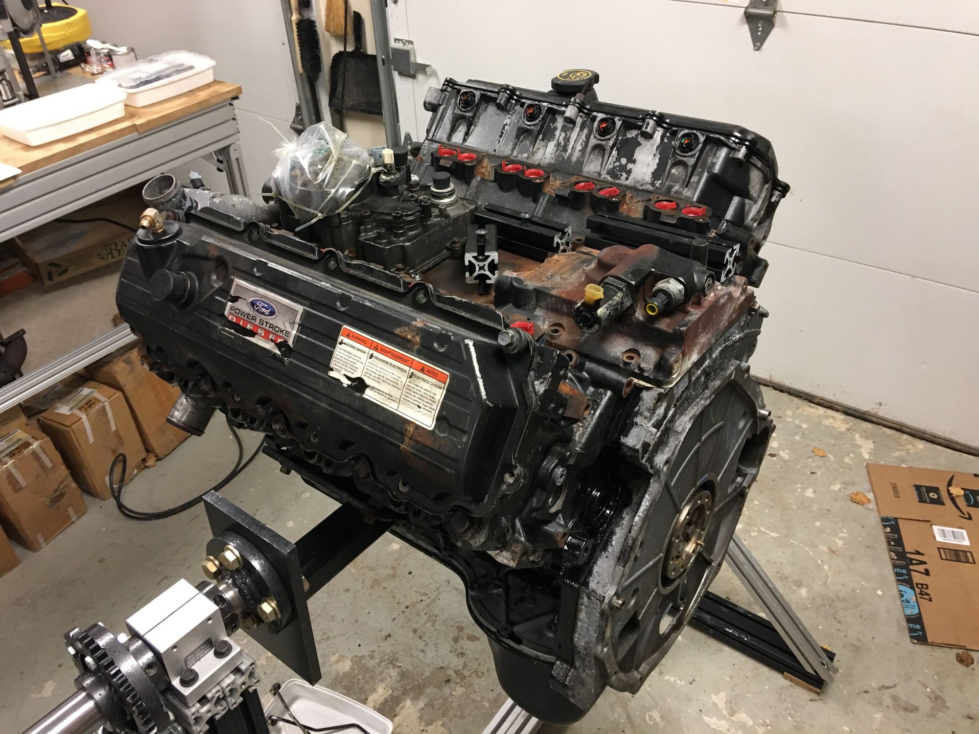

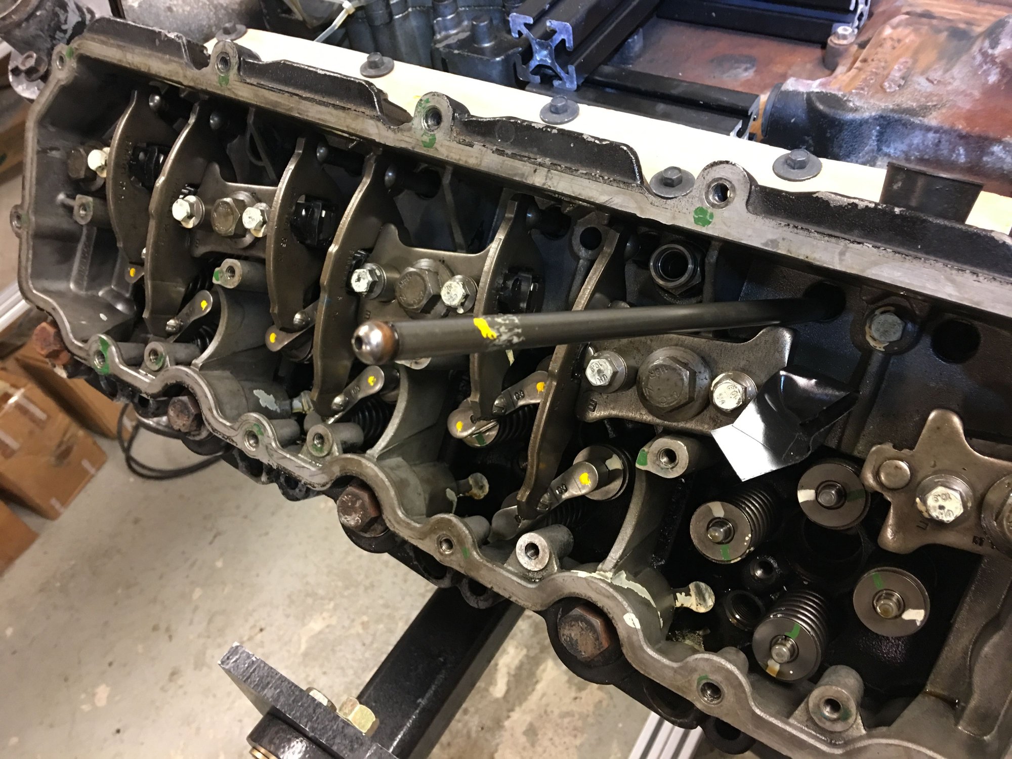

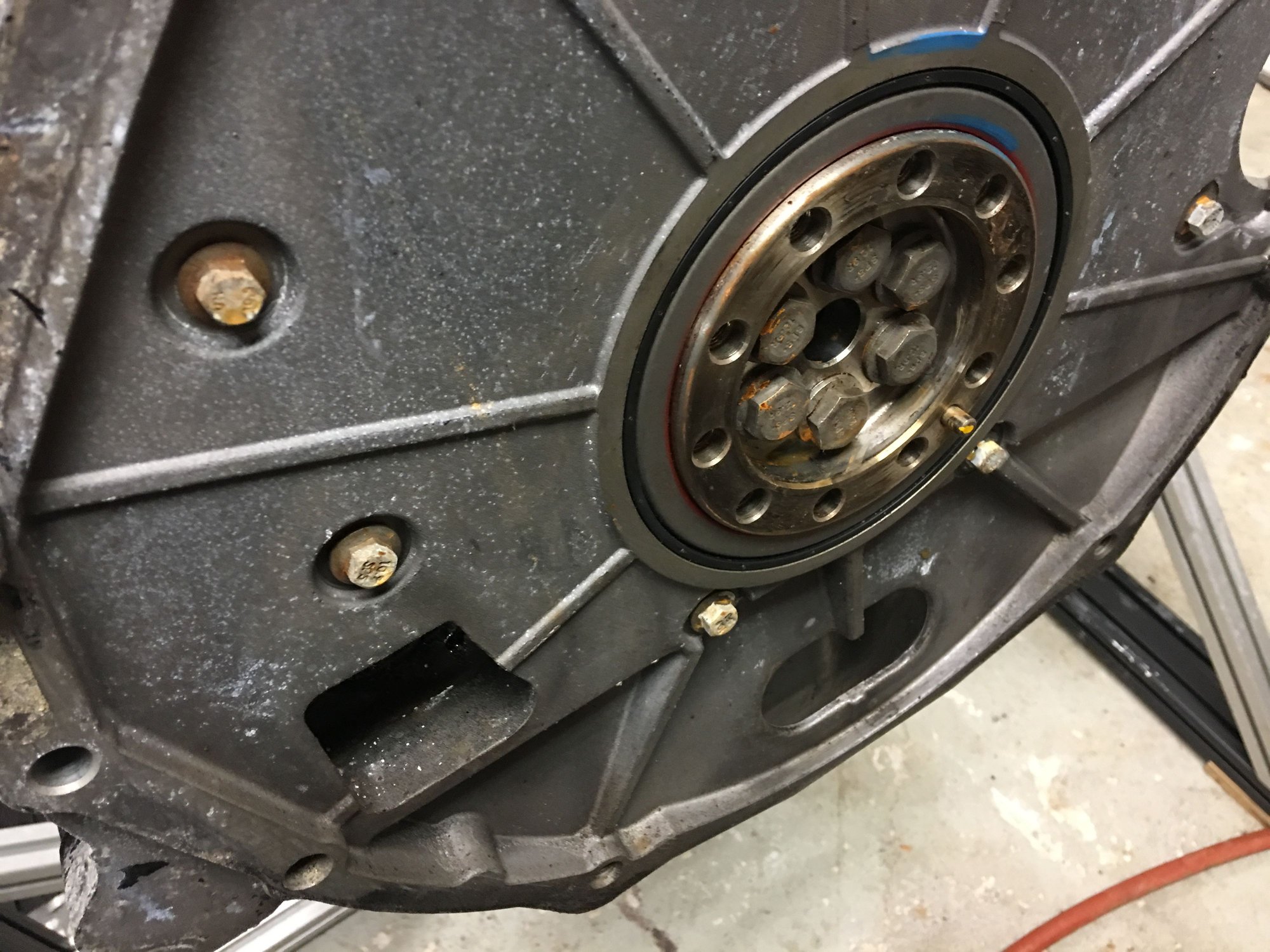

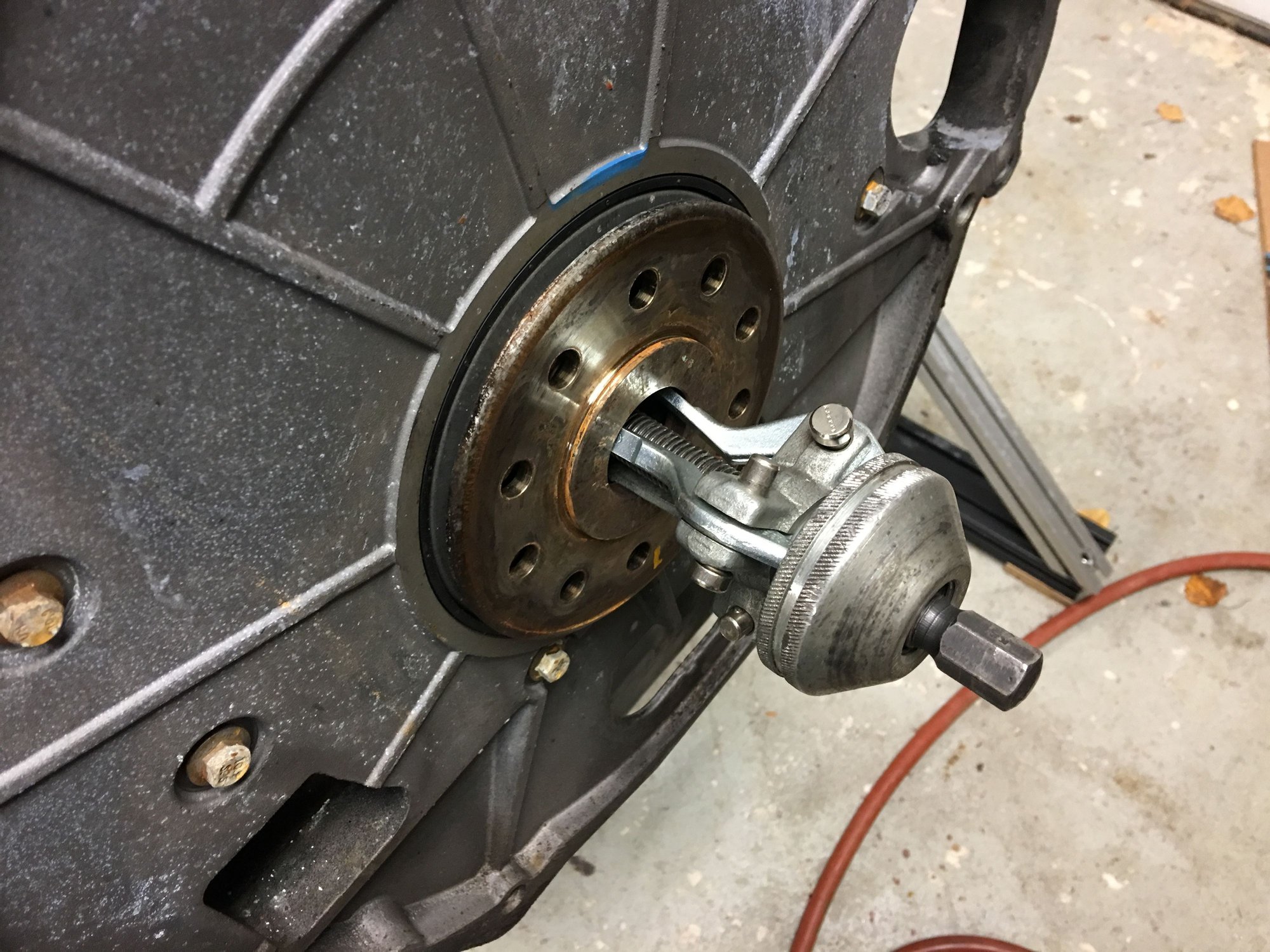

All these parts keep coming out ....
and it don't look any different. (Gets closed up for the night).
Popped the cork.
This poor seal for it's 75k miles of service never leaked. It's life was too short......

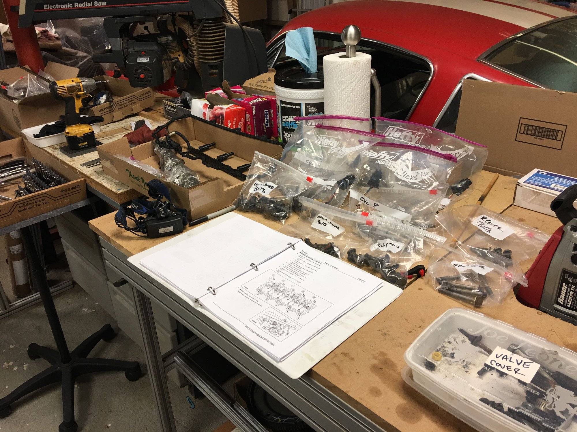

Everything gets labeled or dotted yellow (white and green was builder) and photo'd so if I run out of CoQ10 I can put it back together. Items for each cylinder get their own baggy and labeled.

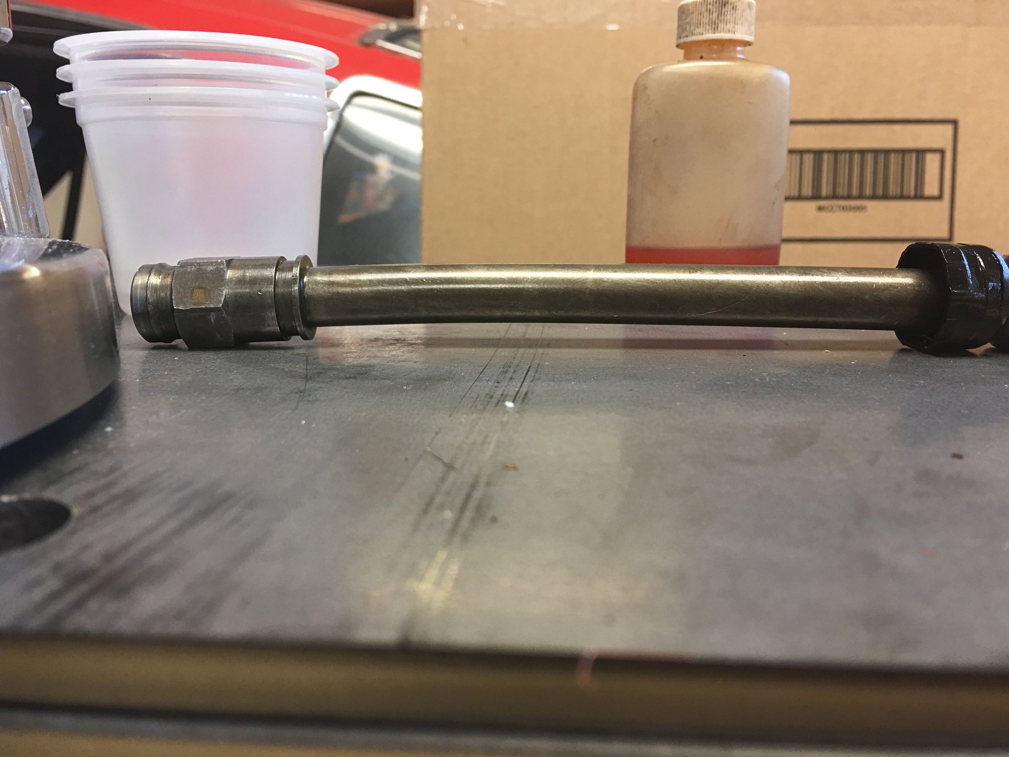

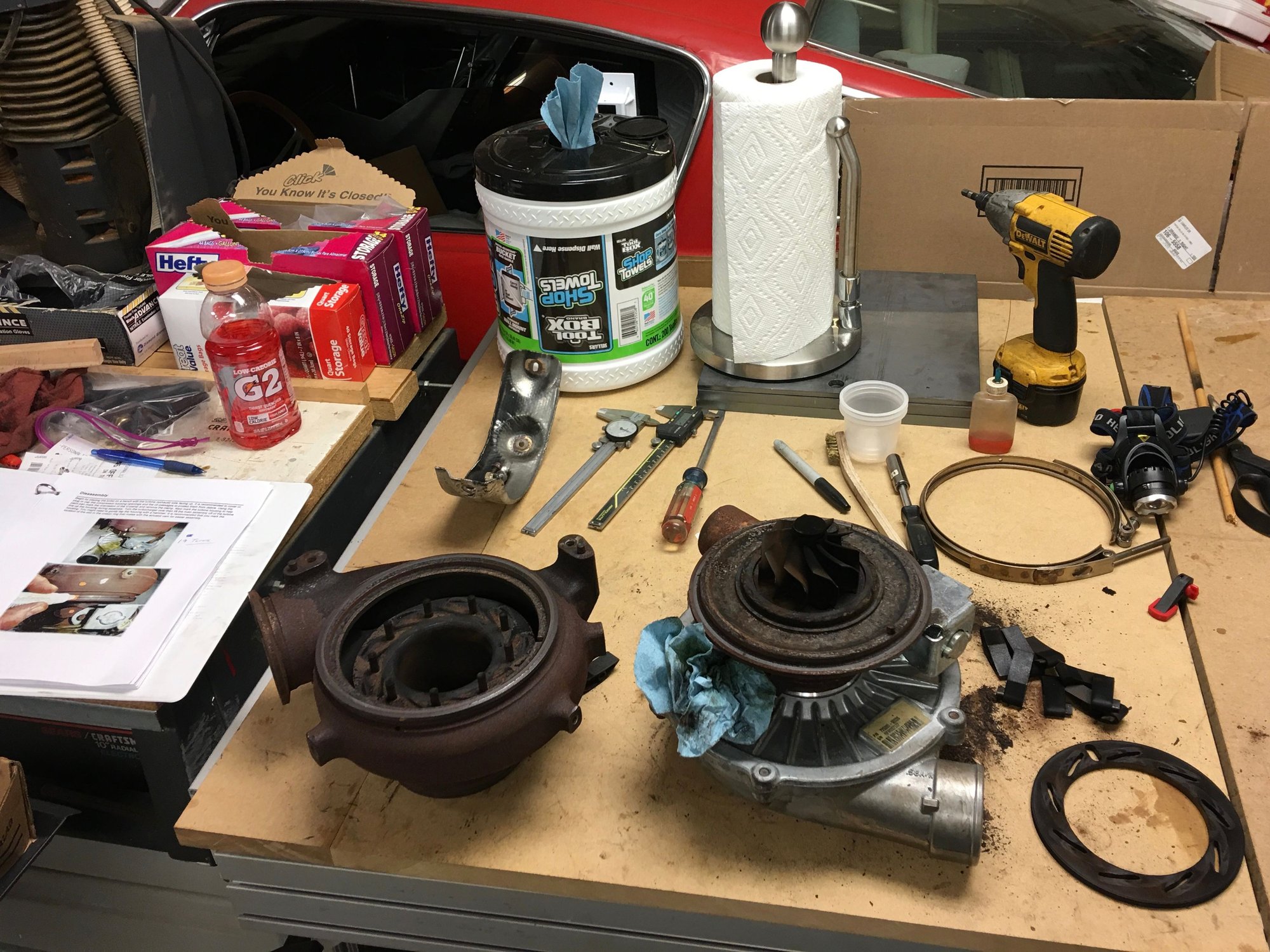

Sitting on one of my calibration weights .... Yeah, the tube got a little torqued coming out.

Any way you can get that workbench with all the crap all over it, out of the way of what would be a nice picture?!

Well, it's a little cramped here, I've got stuff hanging from the ceiling. I prefer a more spacious area to spread everything out.
And ain't got time for meticulousness.
