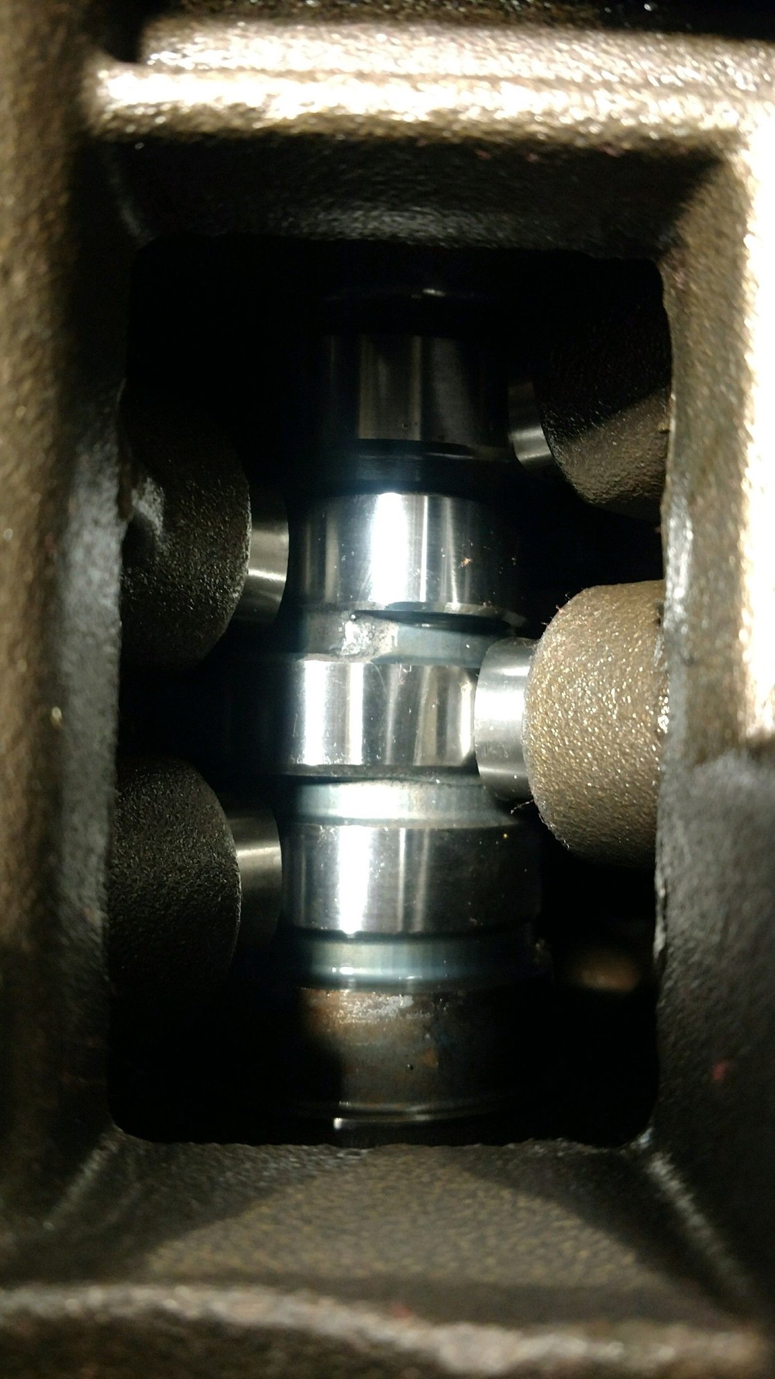

cam
I just went out to check my engine, both lobes are easy to see on #8 with the HP pump removed.

Just a comment Jack: So it looks like you could both see the cam lobe for wear and see if the lifter roller is rolling (with someone's help). What was disturbing in the other thread on lifters was the play Anthony was showing in the roller bearings for the lifter... I don't think you could tell the extent of that play w/o pulling the lifter...
I don't know if both looked good, I think I'd go with a longer pushrod and maybe start some oil analysis and just drive it...

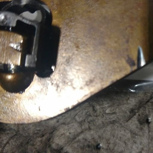

rocker ball
rub
I found a few pics of 6.0 rocker problems I found if you haven't pulled yours yet. The ball on the end of the rocker was frozen crooked, this pushed it off center on the valve bridge and had a little rub problem.
