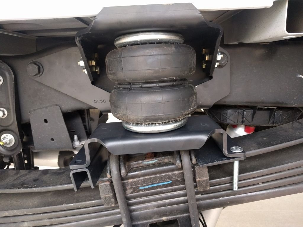

Originally Posted by Tricon
I don't know what you're looking at, but the Firestone bags definitely install over the leaf. I know, I've installed them.
Same here.
I installed this setup on my '17 months ago and just yesterday helped my son install them on his '18.
It was a good day of work on his '18, Firestone 2600 bags, Air Lift wireless compressor, and a 40" curved LED in-the-bumper light bar all installed in about 4 hours.

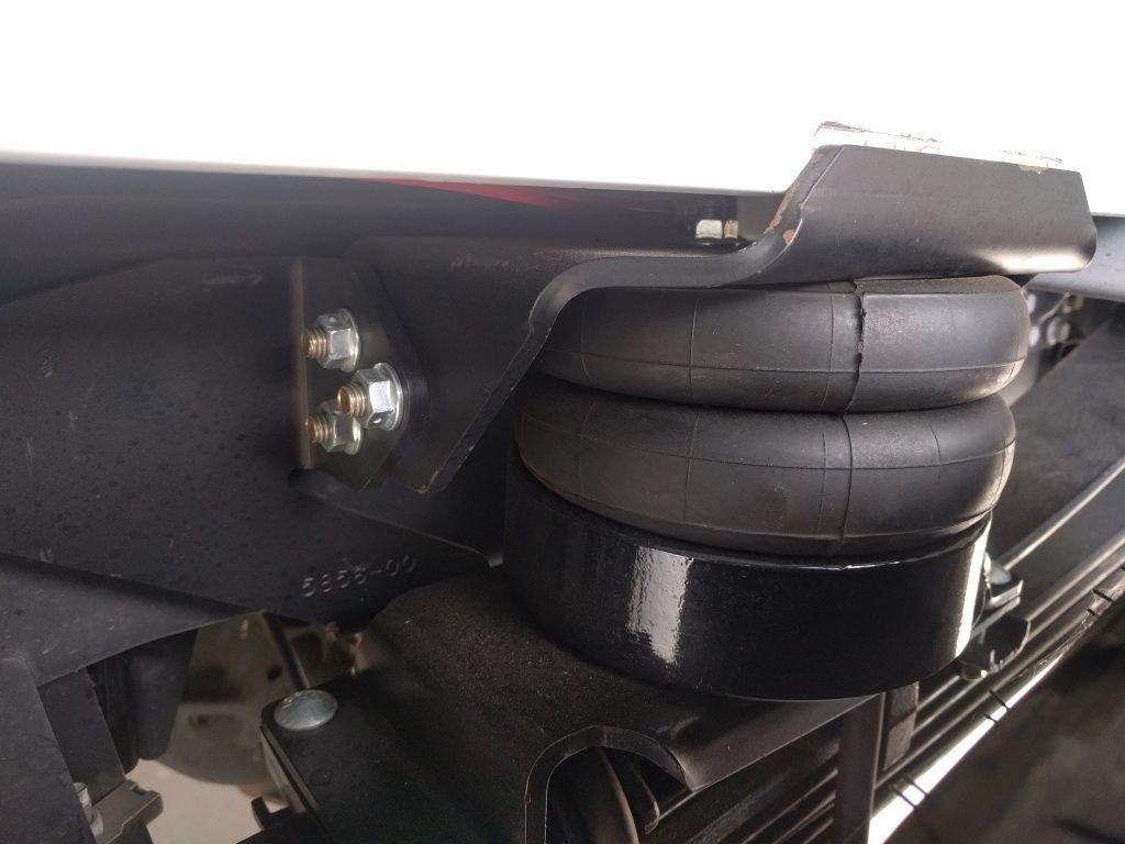

I installed Firestone bags with Daystar cradles on my 350. With the bed empty the bags just touch the lower mount.
The cradles are about 3/4" thick at the base. I was concerned (probably needlessly) the I might pinch the bags if I hit a big bump with my camper loaded.
I sectioned the rear leg of the lower mount and made a new spacer for the front. The bags just touch the cradle base now.
2 things to note. The upper mount rubs the bed seam so I need to bend it back a bit. And a Mityvac tool is great for sucking the air out of the bag to slide the cradle in and align it.
Oh, and I wish Tricon had posted his find before I bought the Firestone's. That's a hell of a deal!
This is at it sits with 3200 Lbs of camper @20 psi.
Thanks for the pics- nice & clean install. I have new floor mats, 42” curved LED, and just ordered the Firestone’s, Daystar cradle and Anderson 3” WDH. Finally getting somewhere with the new truck. Next major purchase- leveling kit (Carli). Then I can relax and keep the wife off my back for ordering parts. Well, until the next round of goodies becomes necessary (cameras, wheels, tires, cantilevered roof rack, bumpers, winch)
Thanks for the pics- better to see then try to visualize!
