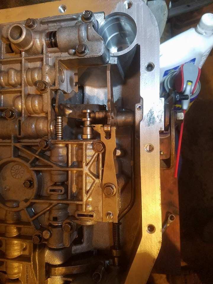

I just got done with the transgo AOD-HP kit. Browsing pics and write ups it seems there is supposed to be something that sits in the "vee" of the separator plate. Also, there is a machined bore in the front of the case that looks suspiciously empty. Im not a trans expert, in fact, this is the first time ive had the pan off an auto in probably 10+ years, and then it was only to change a filter. Its a 91 AOD from a lincoln town car im told (again). It does have the 'A' OD servo

There is a return spring for the throttle valve linkage that sits in the "V" groove in the plate.
The empty bore is for the 3-4 accumulator, this was eliminated in the 89 and later AOD and the holes that feed this are missing in the later plate.

Thanks a ton James, was getting kinda worried. Mine did never have anything there when i pulled the pan. The kit came with a stiffer TV return spring, so i imagine i should be good to go. Ill finish buttoning up the pan and get her stuffed under the car. Thanks again.
