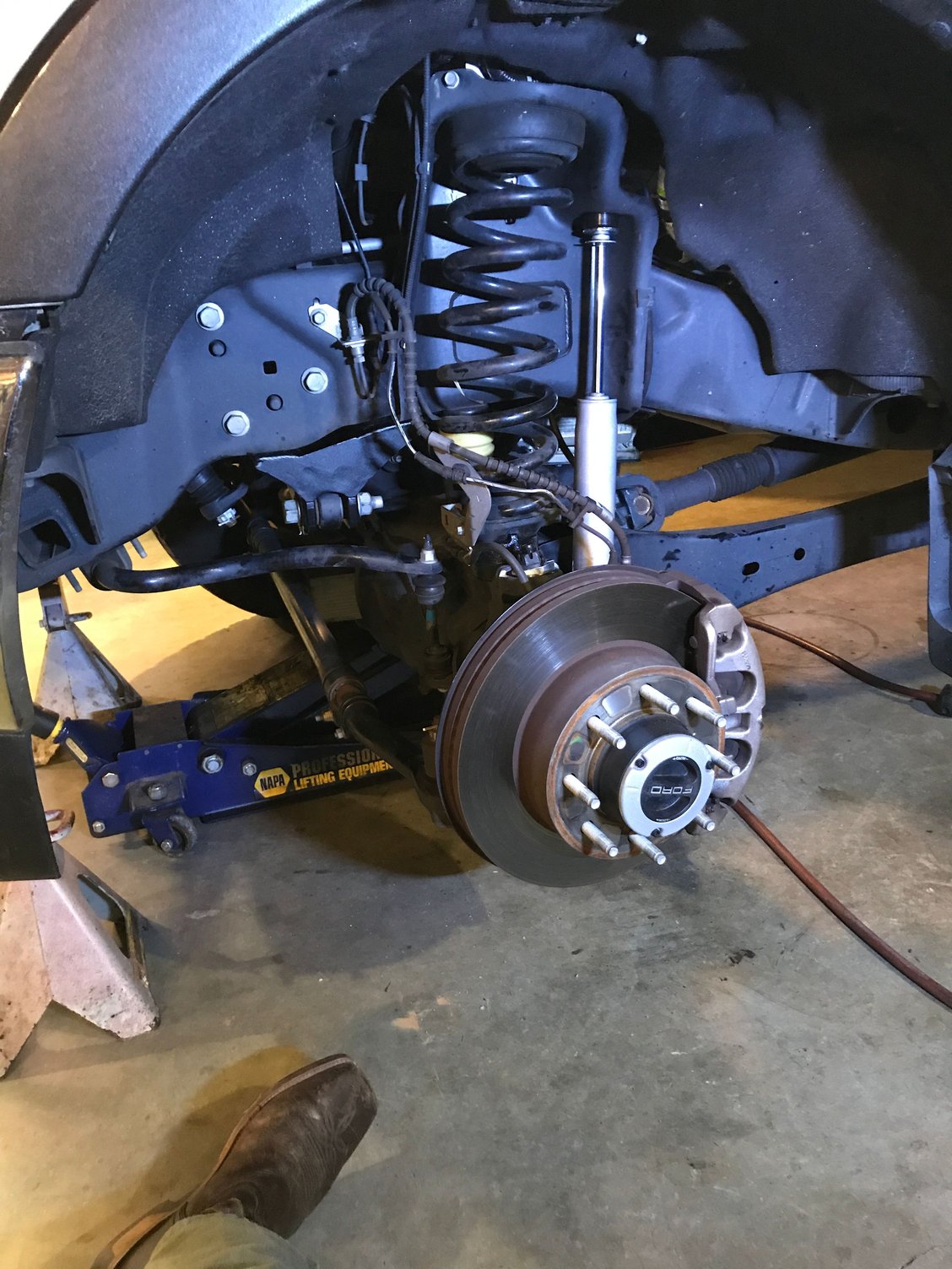

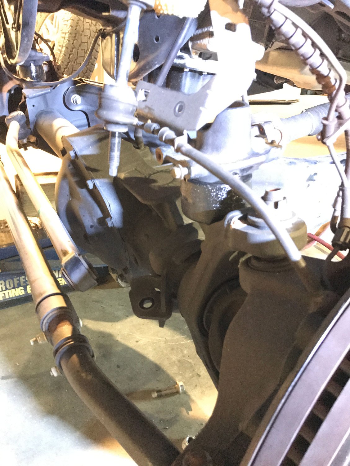

Step 1
Pleased with the quality of bds kit.
Top balljoint nuts seemed to break loose way to easy considering they get torqued to 120-ish
I was surprised how easy i got the dreaded 400ft lb track bar bolt loose. Jack handle and 3/4 drive breaker bar first try. I was nervous after hearing the horror stories. Everything was straight forward and simple.
Ready for step 2

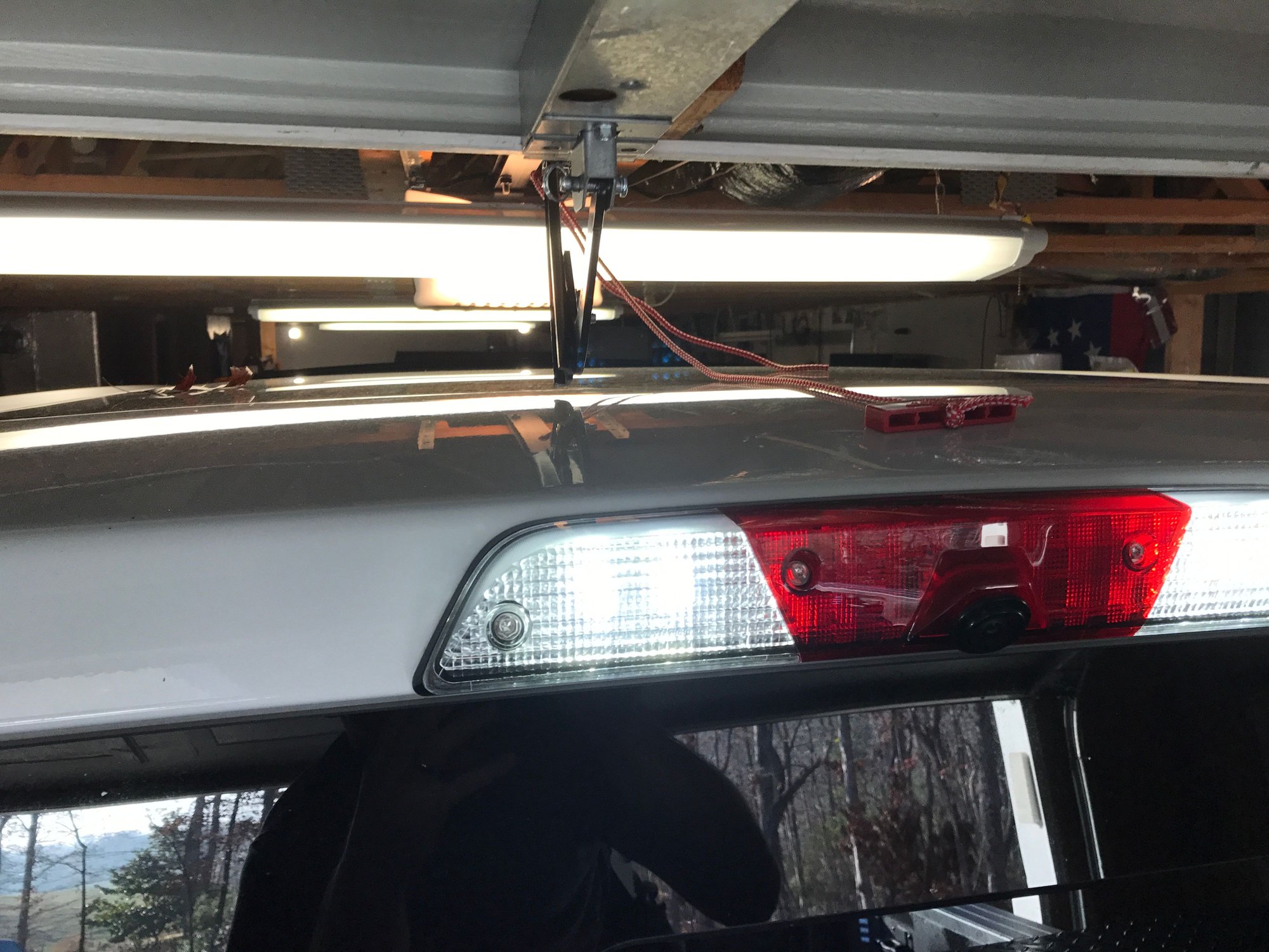

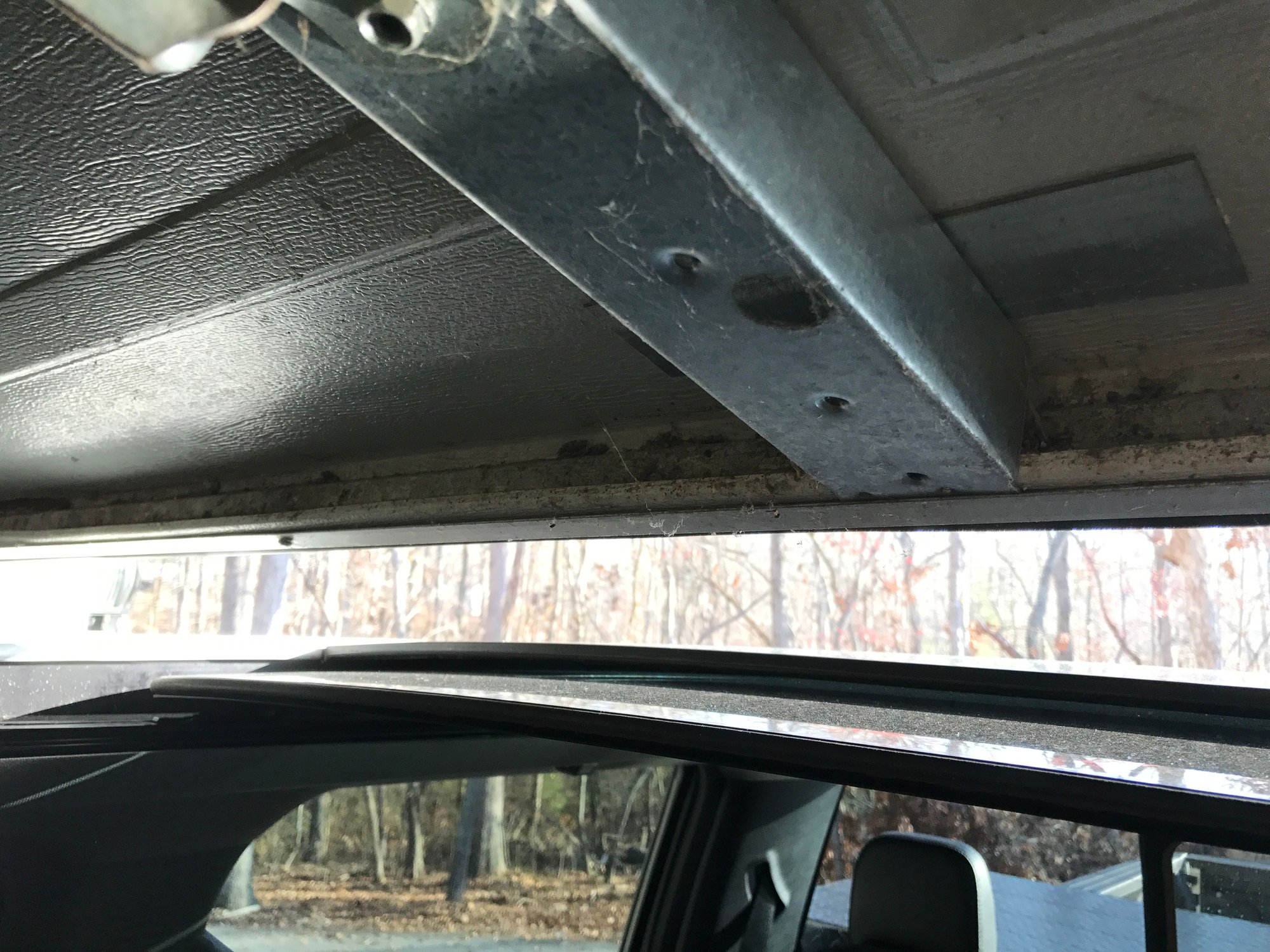

So I thought i was going to have to air the tires down to get it out of the shop, as you can see it barely fit with that arm trimmed. If not for the immediate down hill slope after the shop slab the cab would not have fit thru the door. Sun roof comes in handy for checking clearance, LOL. My new garage is going to have an 8' door, looking forward to not puckering every time i pull in.
Ok, now i see what all the buzz about shocks are. Even these mid grade bds shocks are night and dayy difference over the factory ride, and the factory shocks were still in good shape, i would call them...Mushy.
I figured out why my tires have been feathering in the front. From the factory the alignment was way off, to the tune of 3/8" toe -in, thats right, not 3/16, 3/8"!!!! Its a wonder my tires have worn as good as they have. I got it as close to 1/16-1/8" as i could with my trusted tape measure for now, as well as straightened the steering wheel back by extending the drag link.
Adjusted my head lights down 3 turns, this was a little to low to i came back up 1 turn, seems very close to factory.
Truck drives great, feels like it did at stock height, only better with the new shocks. Before level i had 2-3/4" rake exactly. Now i have exactly 3/4", just what i wanted. Now if the damned tires would ever show up!
