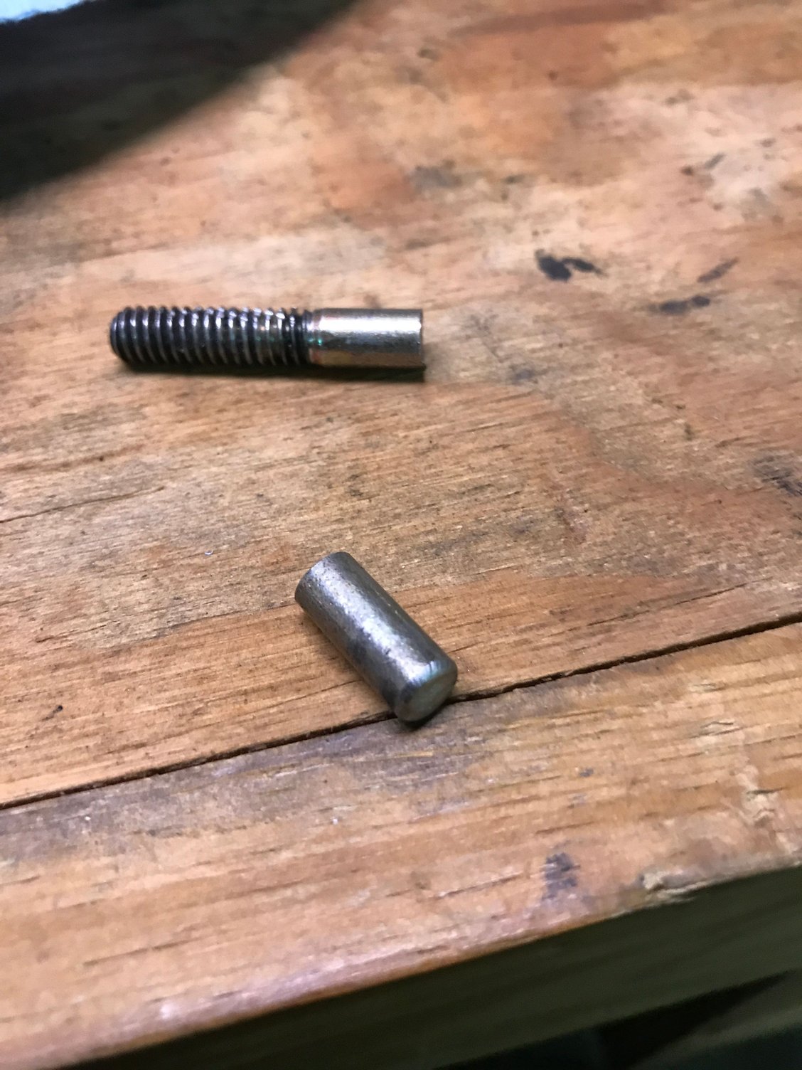

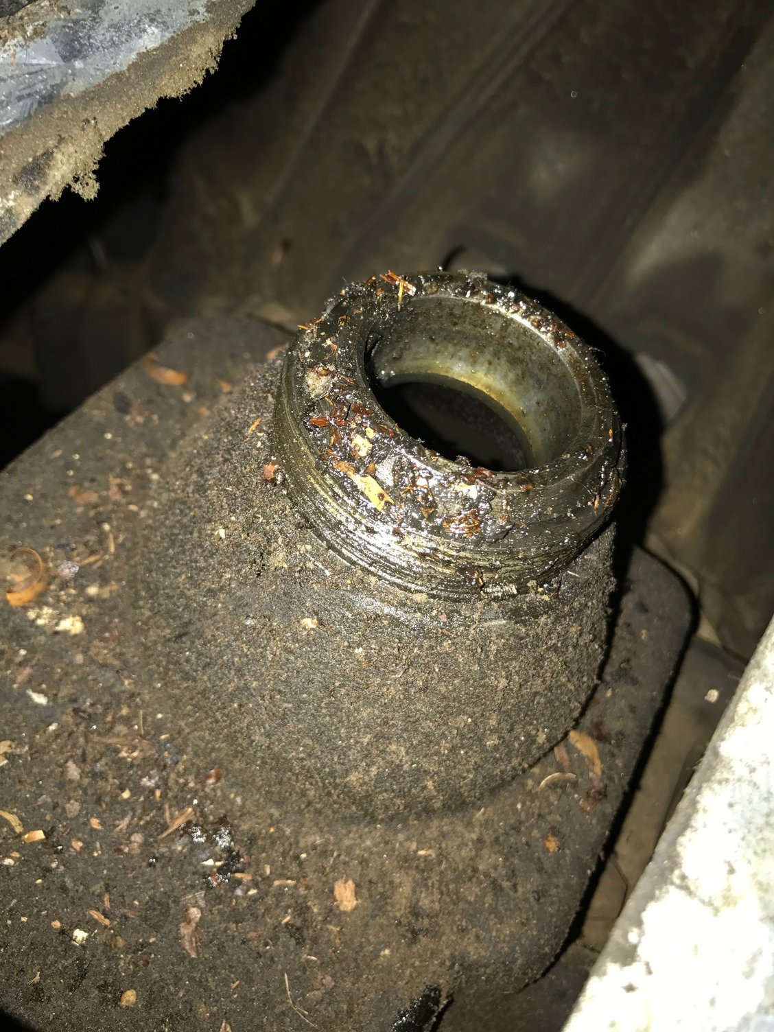

Looks like the body twisted and motor push top of trans into shifter hold down . Maybe? i dont really see anything but a minor mark on the Cap. Looks like it may have been loosened up for awhile judging by the debris on the threads. Looking for a needle bearing to replace the missing detent pin . Good news it i have all my gears.

Fabbed pin out of grade 8 bolt cleaned and lubed shift tower and shifter assembly.
Got her back together, shifter feels tighter than before
