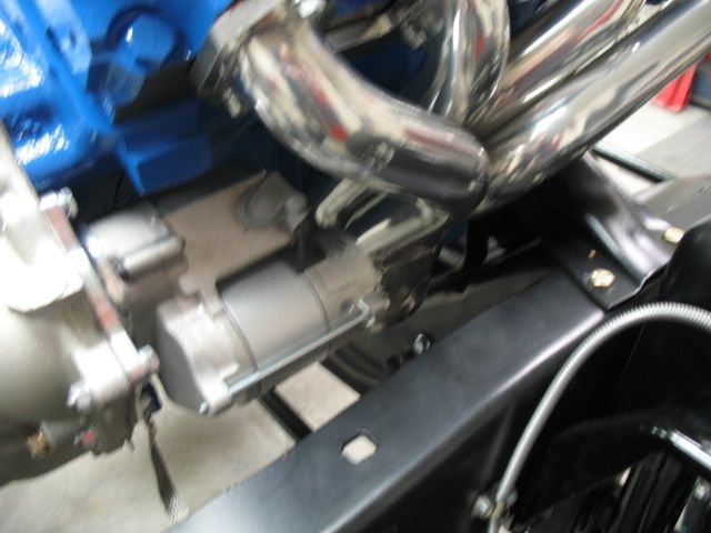

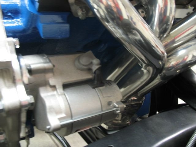

It seems as though everyone has a different opinion. Nice to have options. I went with the Sanderson. Am pleased with the fit, starter clearance and appearance. I installed a compact starter and it doesn't require header removal to install or replace.

I sure am glad you posted your engine picks Eric. Sure is a beautiful job. I was going to mention your work but figured you'd do it when you decided.
With that said, the Sandersons that Eric installed are the only ones I would consider using on a 65-66 F-100. They are perfect for that application and everything clears perfect. They are NOT cheap, but you pay for what you get. Cut corners elsewhere.

Thanks for all the help guys, What model # Sanderson headers are the ones pictured, resonateur? I'll have to look into the new starter as well.

Those are the FF427, ceramic coated. That's the only one Sanderson sells for our trucks. (in either plain steel or ceramic). Their list is $575.00, but I was able to get a deal at an NSRA National meet. They had them at $100.00 off plus free shipping....couldn't pass it up.
