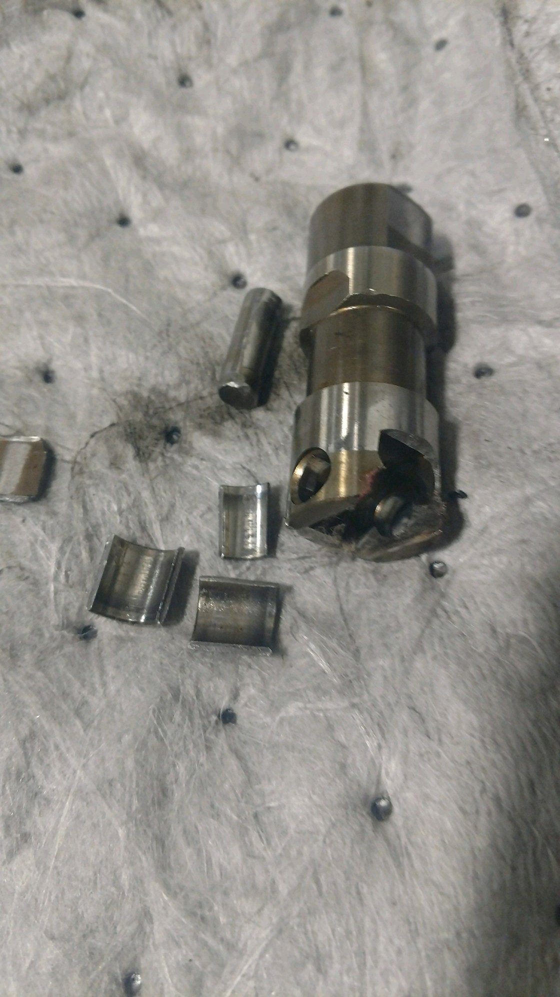

Lifter
Here Ill make you feel better, this is the issue on the van im doing. Just a small problem with #1 cyl.

Originally Posted by 163junk
Lifter
That doesn't look good. Is it a lifter or a piston pin? How long did it take to get the engine out?

Posts: 398
From: Western NY
Pic is # 1 exhaust lifter. No lift needed to get engine out. Im working in the stepchild flat bay. It took about 14 hours to remove it, no im not flat rate. Had a little extra time because this one has a BPD remote oil cooler and had a few oil pain bolts round off on me.

why did the lifter blow? That's a lot of work. Did it come out the front or did you lift the cab?

Came out the front. Ive done a bunch of vans. Just be glad you don't have a limo bus with dual ac compressors and dual alts, they are worse. The lifter went quick, I got lucky, no bearings in low pressure oil pump. I had this engine out 4 years ago. Heads, studs, bored 0.20 over, new con rods etc. But guess who didn't do lifters.
