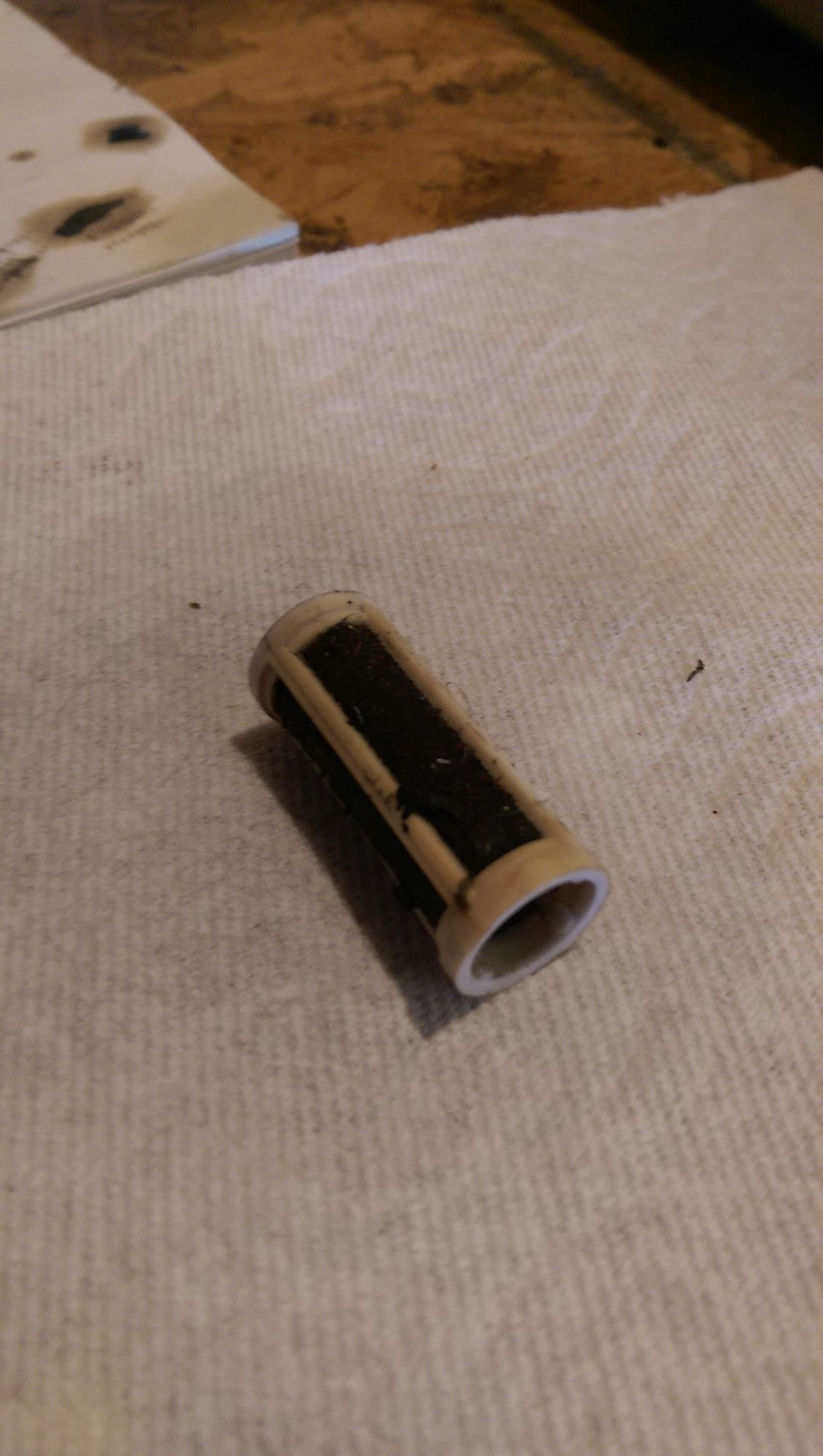

About 30k miles ago I did the Hutch mod and installed an inline filter behind the frame-mounted pump. I figured this was a good time to see how the filter was doing. I was surprised to see how dirty it was:
I'll have to remember to check it every 30k from now.
