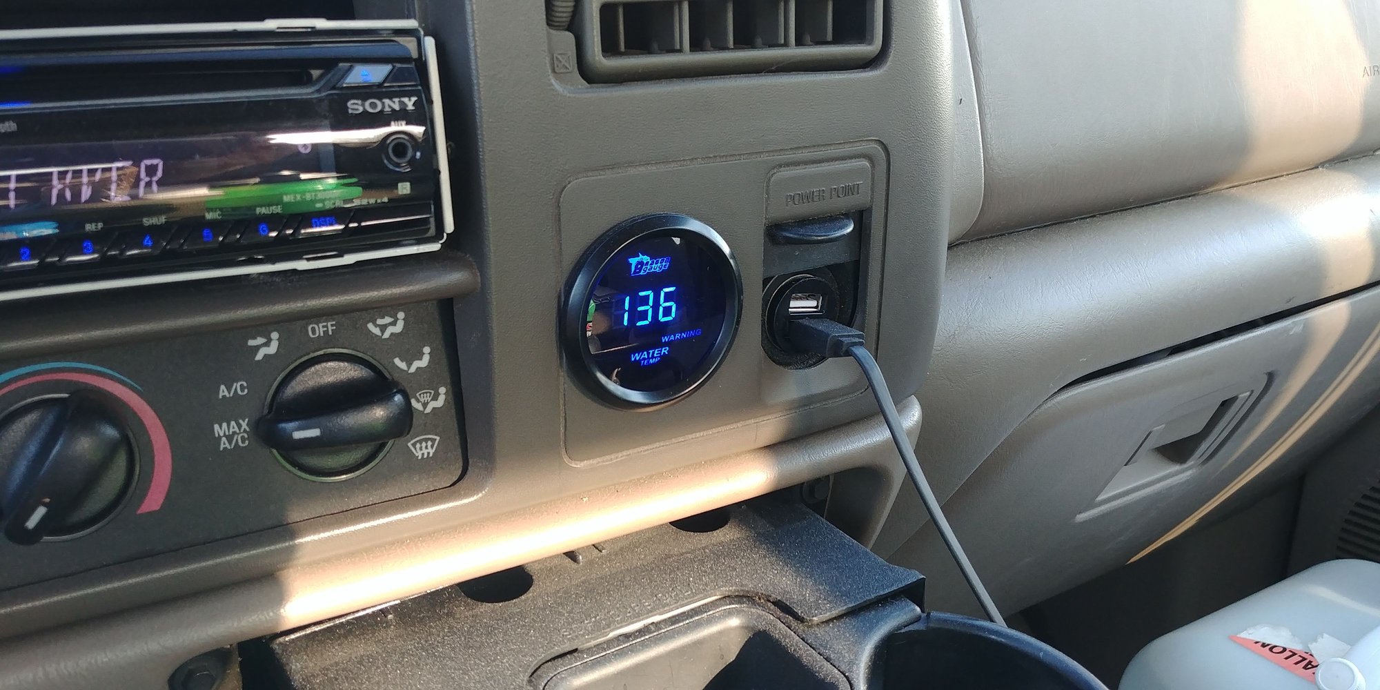

Finally got around to installing gauges to monitor the rebuilt engine. On top I'm running egt, boost, engine coolant and engine oil:
Below trans temp:

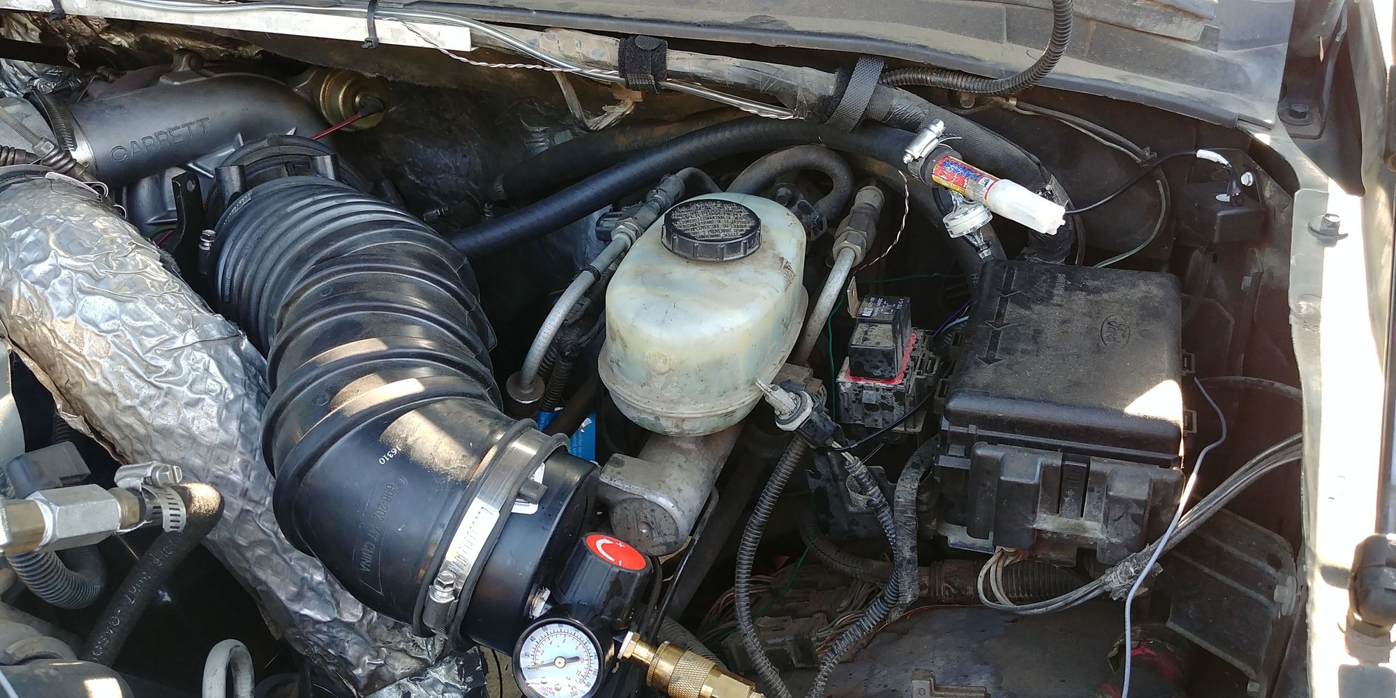

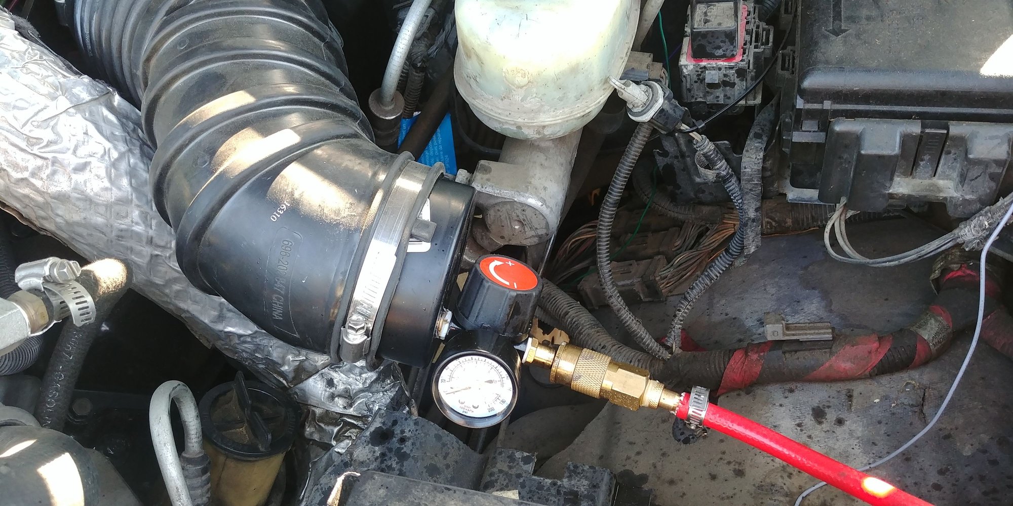

Time to test for leaks. I set up a smoke tester first using a paint sprayer from Harbor Freight and a cotton rag soaked in baby oil and lit on fire:
An ABS end cap at the intake and the PCV hose blocked off:
I immediately saw smoke coming somewhere from the valley below the drivers-side IC pipe.
I disconnected the smoker (the smoke smelled deadly) and got out the spray bottle. I see leaks at the the spider-to-manifold boots and the IC boot at the spider.
Time to order all new boots and clamps from RiffRaff. I should have done this as part of the rebuild.
