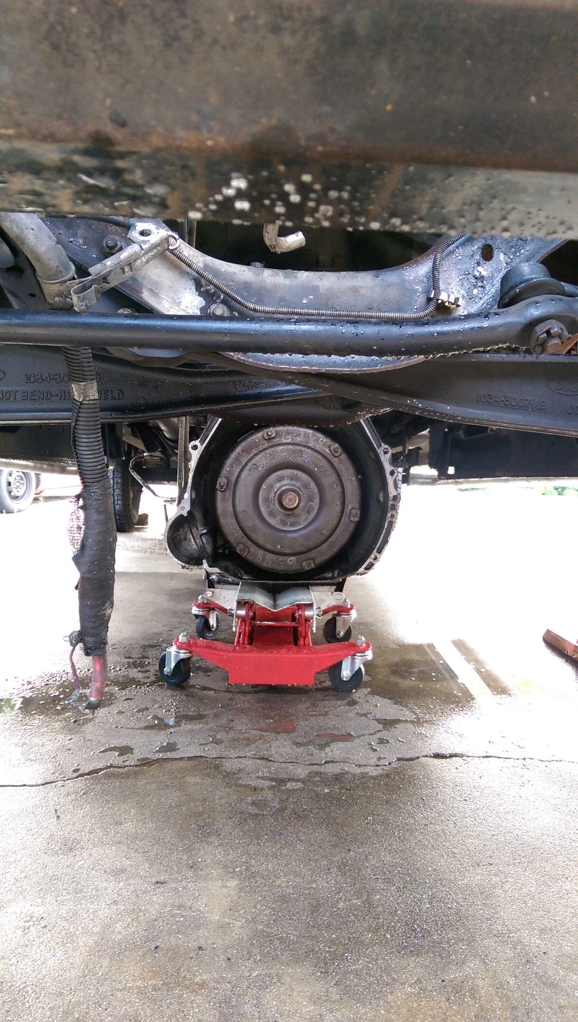

I'm in the midst of rebuilding my engine: https://www.ford-trucks.com/forums/1...build-log.html. The engine's out and I've hit a problem I anticipated but am not sure how to tackle. I want to get the trans out from under the truck, but of course it won't just slide under the front cross member. The trans is about 4 inches too tall on the jack:
My truck is stock height. I might be able to jack it up another 2 inches with the equipment I have. I might then be able to jack the rear of the trans up enough that the front just fits under the cross member.
I'm also considering hoisting the trans through the engine bay with my engine crane. Is this a bad idea? Would I risk warping the front of the trans if I connected the crane to the holes that bolt up to the engine?
Any advice/suggestions are much appreciated.

If it were me, I'd just use some cribbing under the floor jack to get the added height you need. Just make sure it's solid and you have floor jack to handle the extra height.

I'd slide it off the jack onto a piece of plywood with a disposable blanket for protection. Then slide it out. Been done many times.

Carefully roll trans off jack and onto plywood/cardboard/blankets/something and slide it out?

Two ratchet straps to cradle the transmission between the frame rails. I have done it countless times.
Just make sure to start with some strap on the reel so you can slowly let the transmission down to the floor.
Then you can use the same method to raise the transmission enough to get the jack under the transmission on reassembly.

I would use Stewart H's method but I didn't know that the stuff I used to hiked the jack up was called cribbing. If you have two jacks it's real easy to do.

Thanks for the tips. I'm going to try to build a low dolly this week that I can put under the trans and wheel it out. I'll post some pics of what I come up with.
