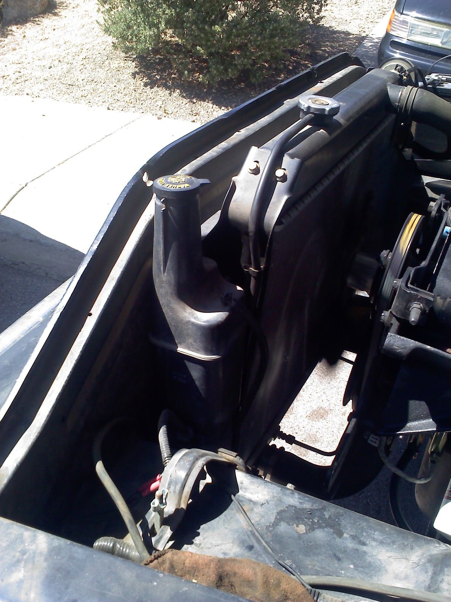

If your rad overflow reservoir isn't mounted to the left of your rad, you may be able to mount a 1997 Cougar/T-bird wiper reservoir there like I did. It has a pump mounted to the bottom of it I spliced in to the original Bump's pump wiring. Also a low fluid sensor I have not hooked up yet. 94/96 Cougar/T-bird tank may be similar. I used the 97 Cougar dual horn set up and mounted both on the right side. Note, this 97 tank is real tall so it goes all the way down the side of the radiator. My radiator core support does not have those extra reinforcement brackets down by where it mounts to the frame I've seen on other Bumps. Like Garrett's. So this 97 tank went all the way down and tucked up against the core support.
wiper bottle and motor assembly out of a 1997 T Bird/Cougar.

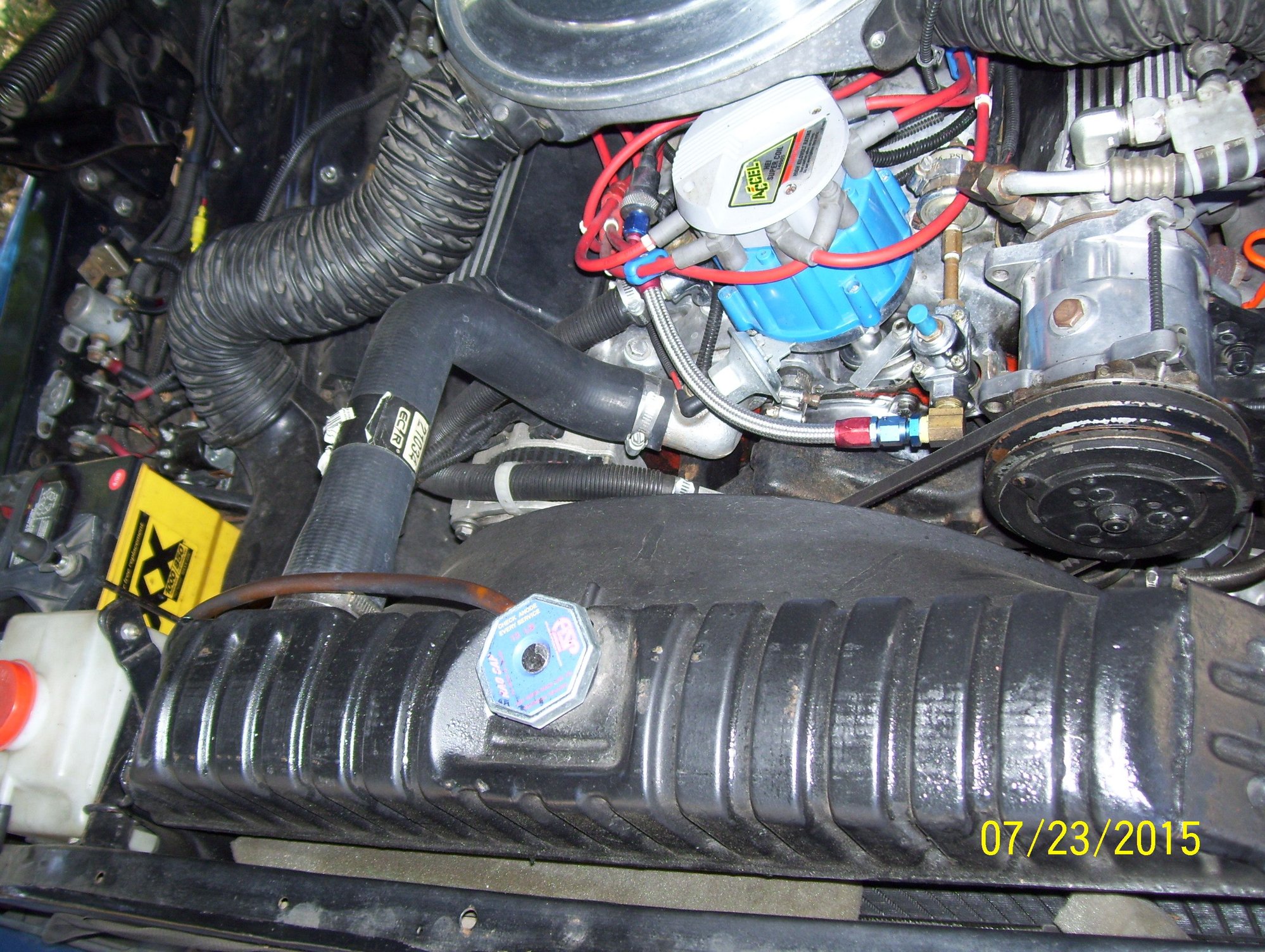

That a nice setup Jeff but I've got air intake ducked coming in on both side of my rad. I think if I move my washer tank the Fitach fuel cylinder com-tank will fit into that area. Then use an later dual rad & washer tank mounted on the right between the Batt. & Rad. would fit into that space.
But still thinking about running the line back to my in cab tank tho.
Which could be done about half the price as the fuel command tank.
I saw a forum when to fuel command tank pump had over heating issues. was boiling fuel out the vent tube that stalled the engine out.
That was later corrected.
So, I'll keep researching the best way to go.
Orich
The pics not to good for seeing my left side of rad.
