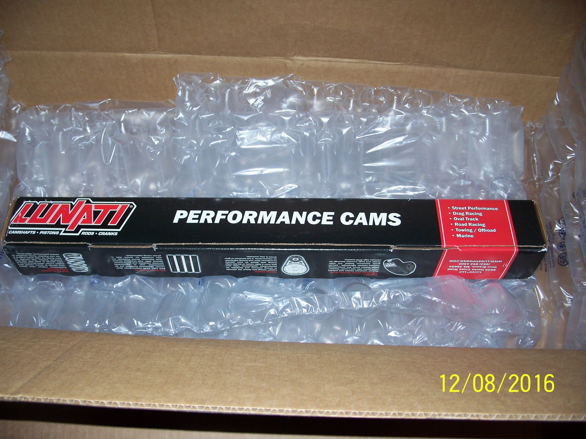

It must be the Monday hangovers or new personal who have been filling my online orders. Yesterday Santa made a showing in brown slay. He's at my door with a big box 30"x14" x8" and, I asked Santa you sure that's for me, Yep!
So I am opening carefully as I don't remember placing an order of any item that would come in a big azz box this size.
Holy hell, it's a Camshaft bouncing inside this bubble pack box, at least it was in a smaller cam box.
I Looked every where for an order invoice an none to be found.
An never got any email about this cam coming.

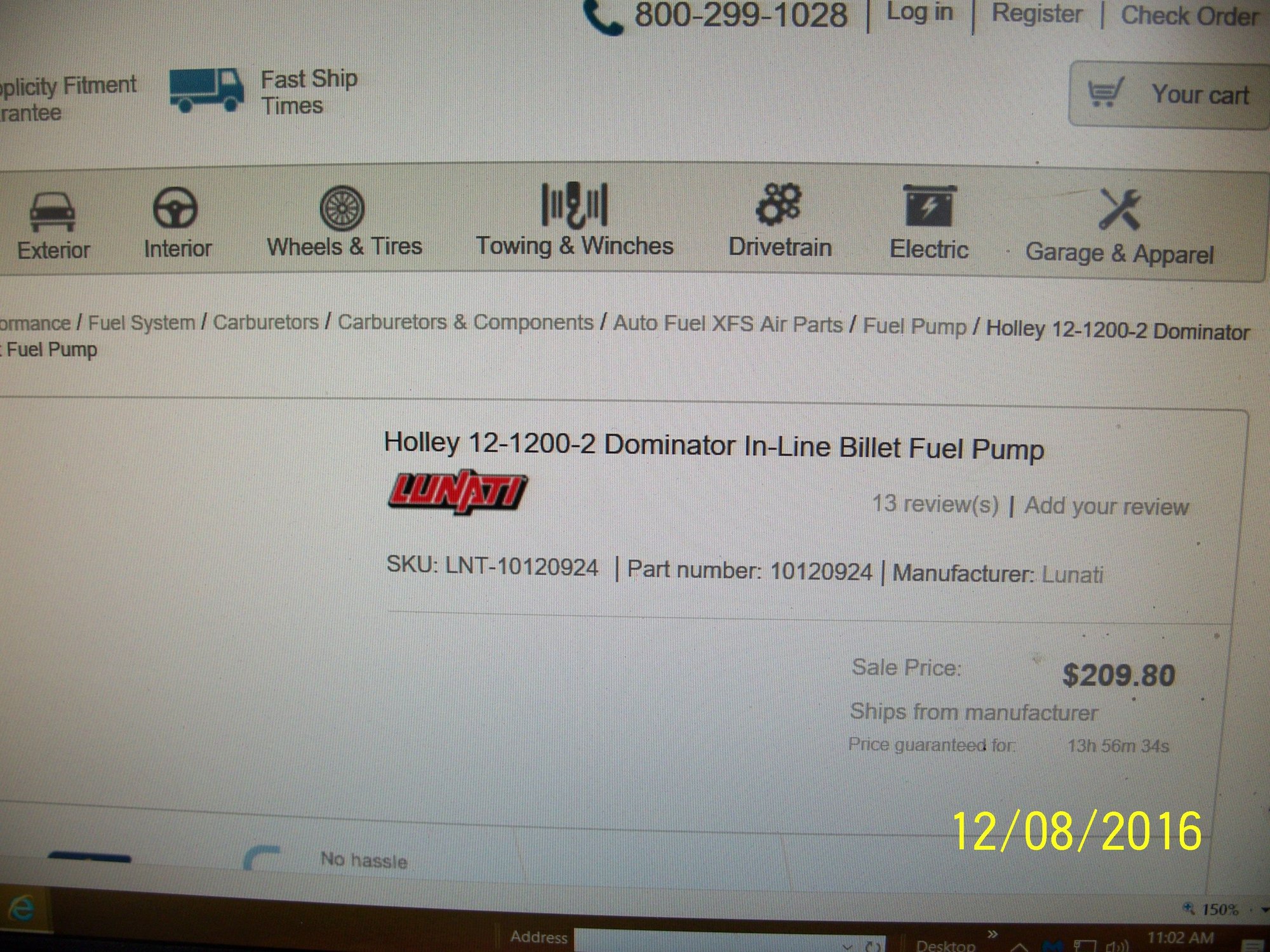

Here's a picture of the web page that now shows the camshaft listed just below the Holley pump that was not their when, I bought the pump last week.
No invoice
And the cam is for a sbc at that!

Boy that's a funny looking fuel pump. I think you need to dip into the eggnog and see if it looks different

Nice a Holley fuel pump with a Lunati sku number, someone made a mistake. I wouldn't be laughing at all, what a pain to have to deal with. Definitely time for eggnog.

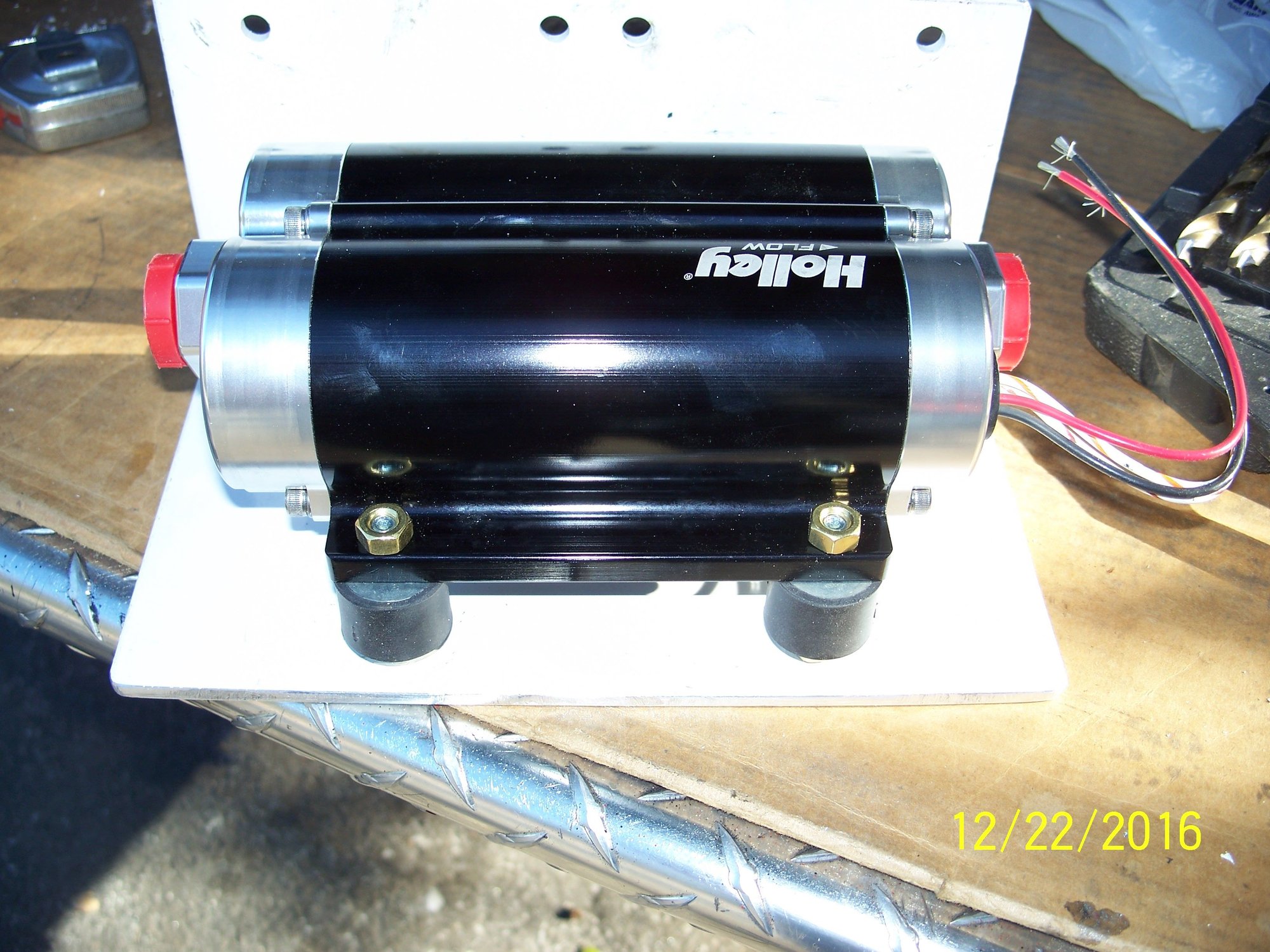

I'm pressed for more room to mounting the goodies in places in between other items, I've mounted things.
So, I finely decided where and how, I'll mount my efi fuel pump.
I drilled 6 mounting holes in the frame rail under the driver seat side.
I spent a couple of day looking everything over on where and how to mount stuff an run the in & return line building a mapped out plan in my head before, I jump into it.
Plus looked through my junk iron box to see what could be used for and how to mount double 6lbs pump. This pump has been tested up to 3000hrs and can be run as two or single stage pumsaaaaaaaaaaaaaaaaaaaaaaaaaaaaaaaaaaaaaaaaaaaaaa aaaaaaaaaaaaaaaaaaaaaaaaaaaaaaa
When, I made up my mine on the way, I wanted to do my fuel system, I selection a return fuel system that meant a lot more work then if , I had going with one of the fuel systems command centers systems.
So it will take a little more planning an routing two fuel lines not counting setting up the fuel tank for a return line.
I decided to use the L bracket mounted to the inside the inner frame rail so got all the holes drill in the frame. Here a picture of the way the pump will mount once bolted into the frame. This is a 1/4" aluminum L bracket that will be mounted with a 1/6th" piece of rubber glued to the back side between hopefully so the pump don't radiate to much noise
Also has been cold and rainy yesterday an windy as hell.

I mounted my pump in the same location. I used my factory line as the return line and then ran the supplied rubber Efi hose for the main line. Keep at it you'll be done in no time.
D

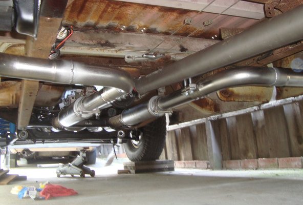

I still got the in-cab tank with the EFI but plan to install a rear-mounted 72-80 Scout II tank. It is currently set up with the pump direction pointing towards the back and the pressurized section runs to the rear, then across the crossmember, and then forward on the passenger side frame rail up to the throttle body. Adel (aka "cushion clamps") are used generously.
When the Scout II tank goes in, the pump will be moved in front of the tank on the crossmember. Hence, why the pressure hose is left long for now.
Below is a pic of where the pump is currently mounted... after of the leading edge of the bed so it stays out of the weather.

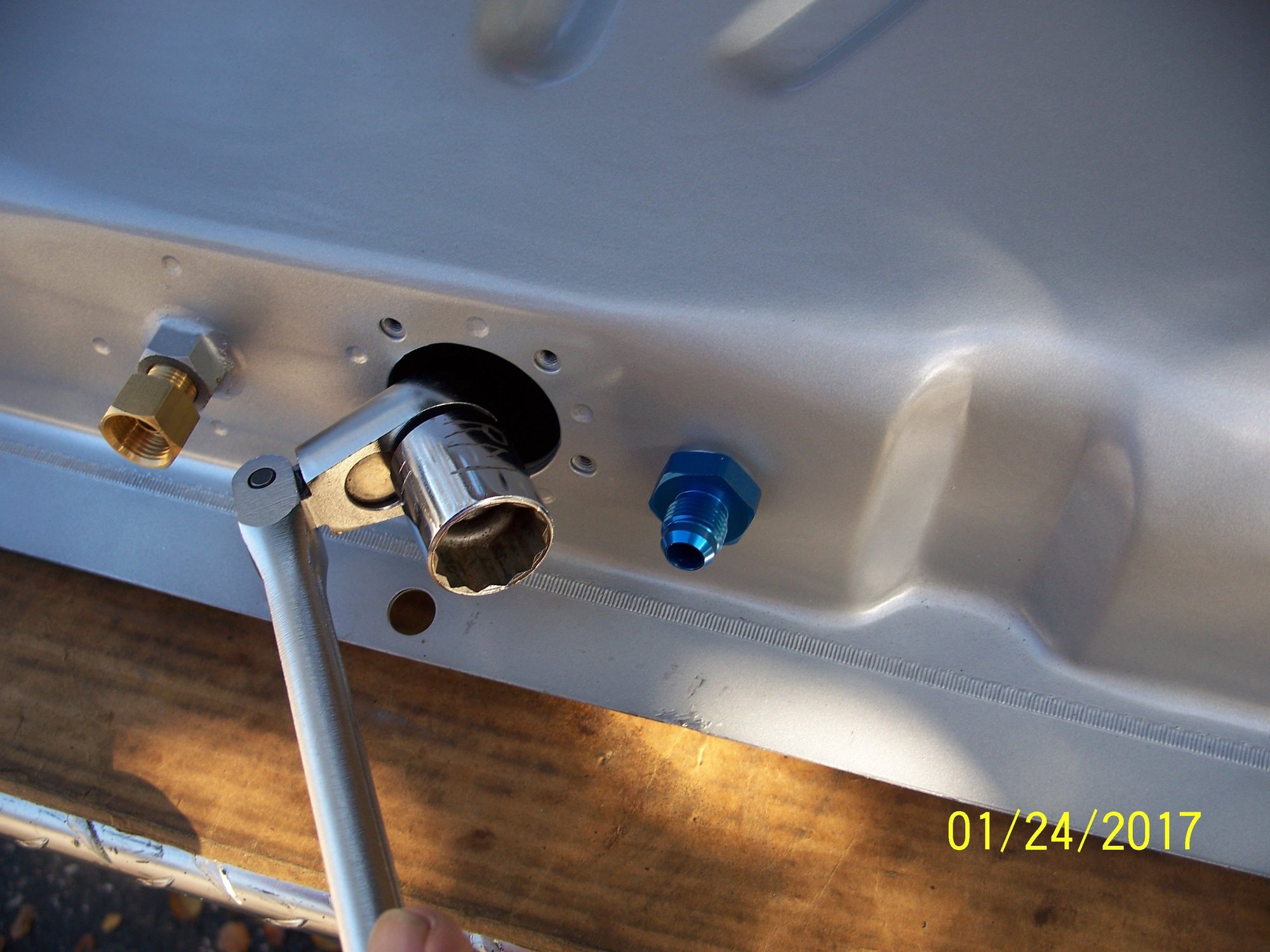

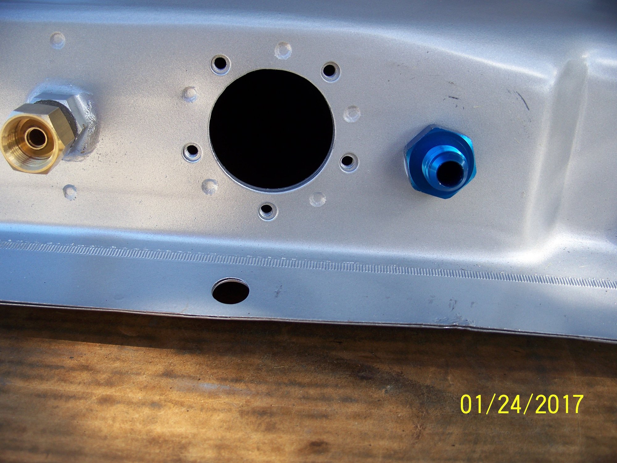

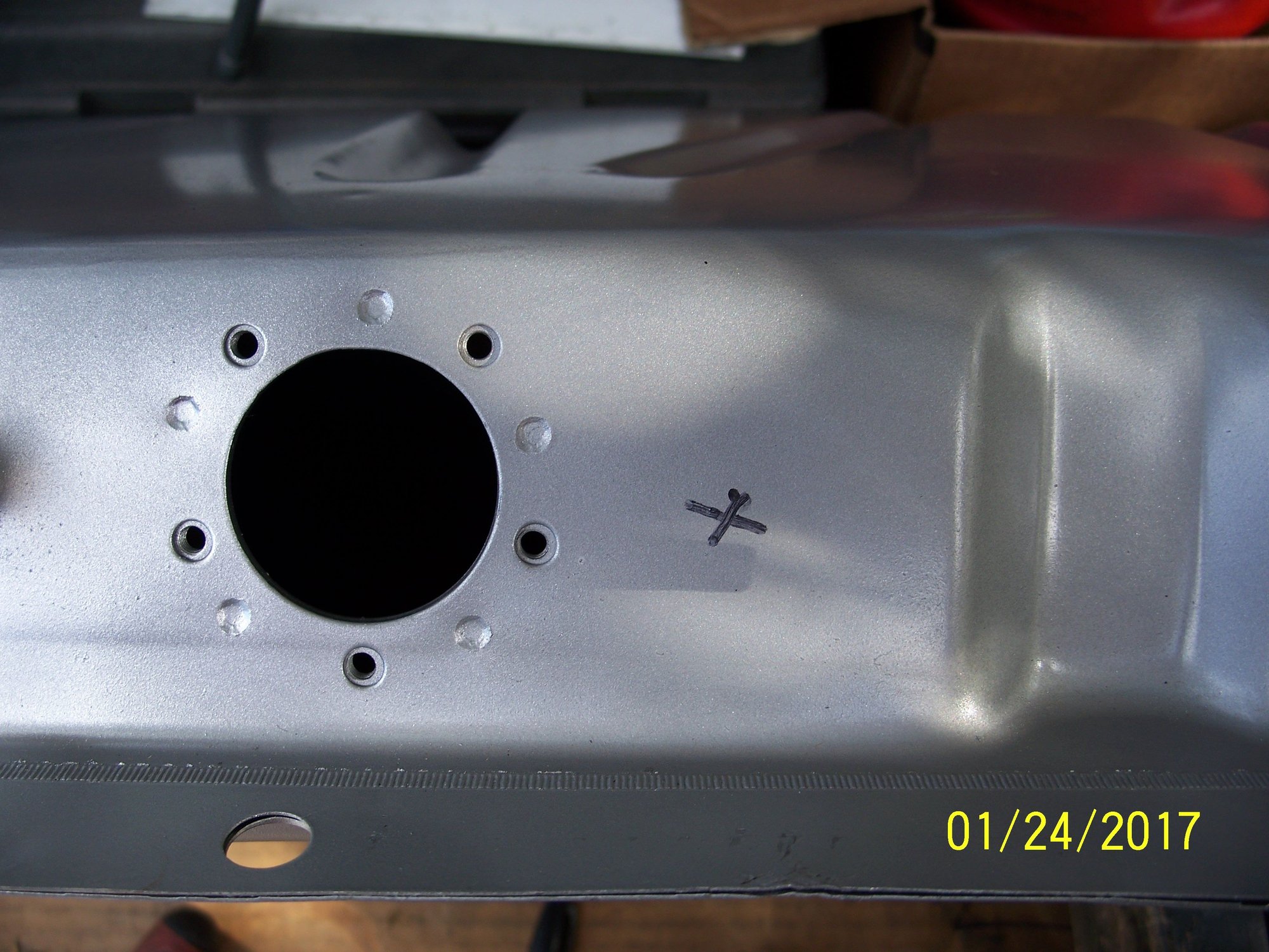

I got the fuel pump mounted finally the other day before it stated to rain.
Well been slowly tinkering with the fuel in & return lines getting them routed an mounted to the inside of the frame. My new tank showed up yesterday evening so stated back on it today an got the tank setup up for the return line.
An how do ya keep the inner lock nut from turning simple put a socket on an hold it while you tighten the outer nut.
No rain for a few day so, Ill try to get the new tank in and the return hooked up for now.
This his not where, I had planed to put it but my ratchet was a little to lagre with the socket into the filler pipe, so had to mount to near the sender. Doing the return line fittings in red& blue an the input fuel line in all black fittings to keep them from getting hooked up wrong.
