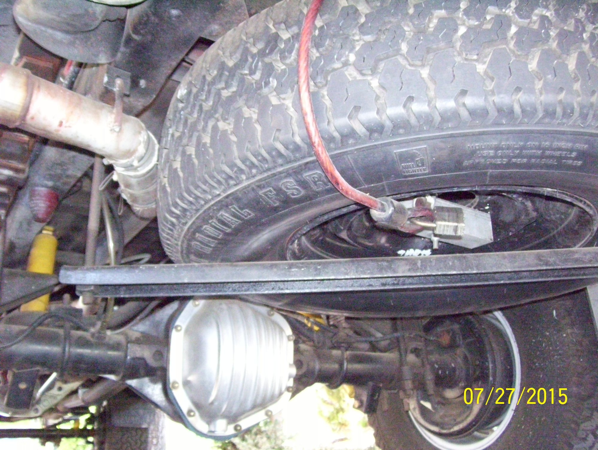

Originally Posted by Brian1971f100
So I keep wondering why not use a late 80's to 90's crown vic tank and electric in tank pump. Wouldn't this be a possible in cab conversion?
Ya but, I'm not willing to giving up my rear tire spare tire rear carrier.
And to have the tire in the bed no way not for me
Orich.
