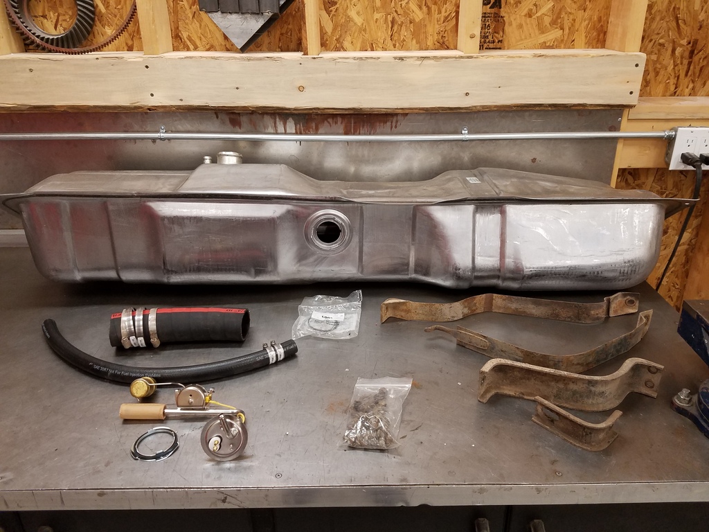

Originally Posted by smoky_diesel
Well I just went through this. PO had purchased a new tank. it is a spectra premium F25A
Link: ecat
They sell new for $130. Listed apps are for a dent. Only PN ref I found was D8TZ-9002-J
The vent tube is on the wrong side, but not a big issue to solve.
Sending unit is a D7TZ-9275-B from JBGY
1973-1979 Ford F Series Sending Unit, Side Mount-Broncograveyard.com
The tank straps were all bent and needed help so not sure how exactly close this should have fit. I did some hammering where the straps contact the tank, like the factory tank did and it fit but not perfectly. I replaced all rubber hoses with decent fuel rated hose from here:
Filler Neck Supply: Gas Filler Hose | Fuel Filler Necks
Overall these parts work, truck is back on the road.
Attachment 210483
