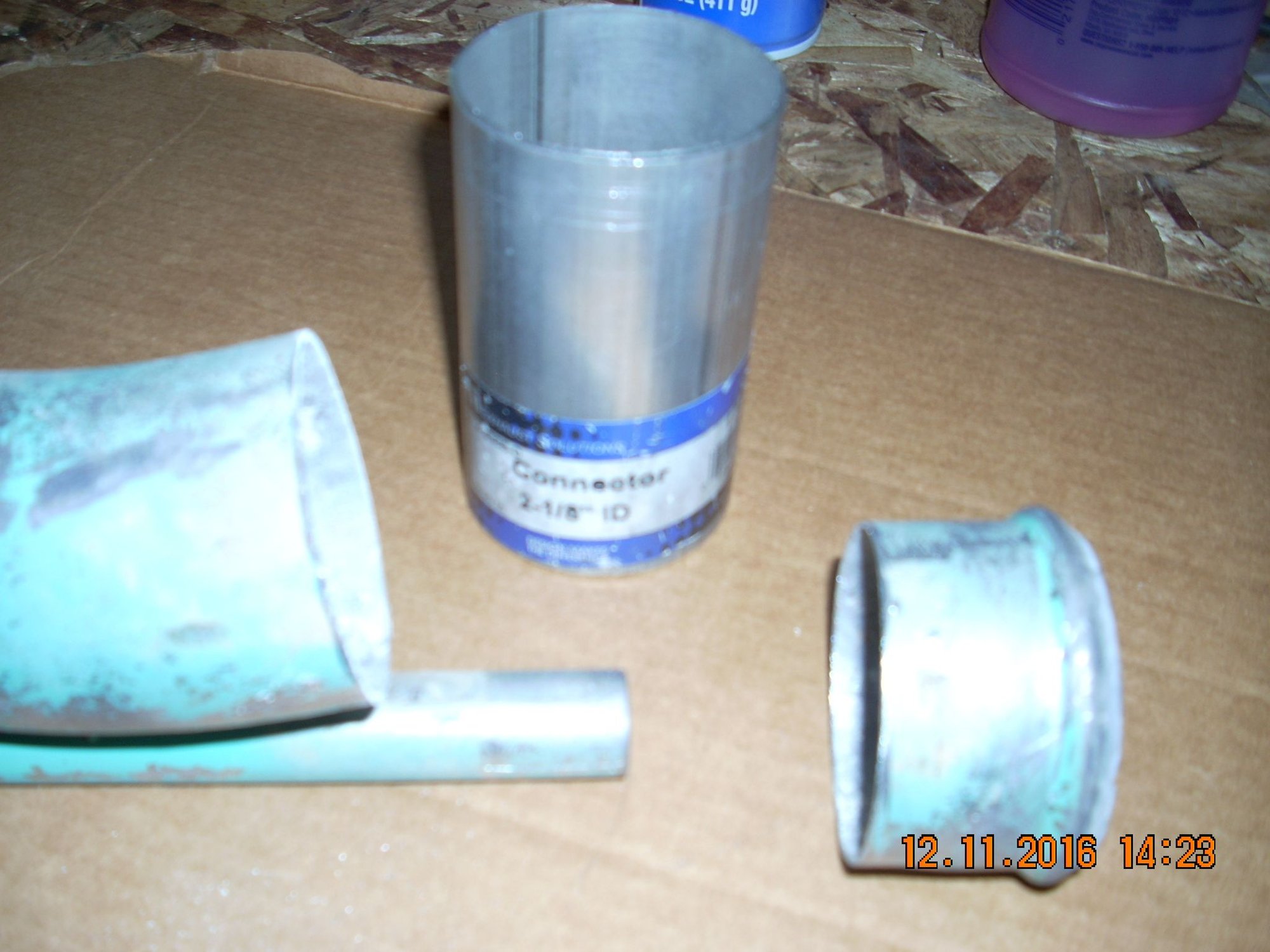

Finally got my auxiliary fuel tank filler neck extended. After getting a quote from an exhaust shop of 30.00 just to make an adapter for me, I went to Auto Zone and paid 2.99 for a 2 1/8 inch exhaust coupler. I cut the filler neck and added in about 2 inches. problem solved. It's always one more thing with this project. Now all I have to do is order a rubber grommet for where the filler neck goes through the bed side.
