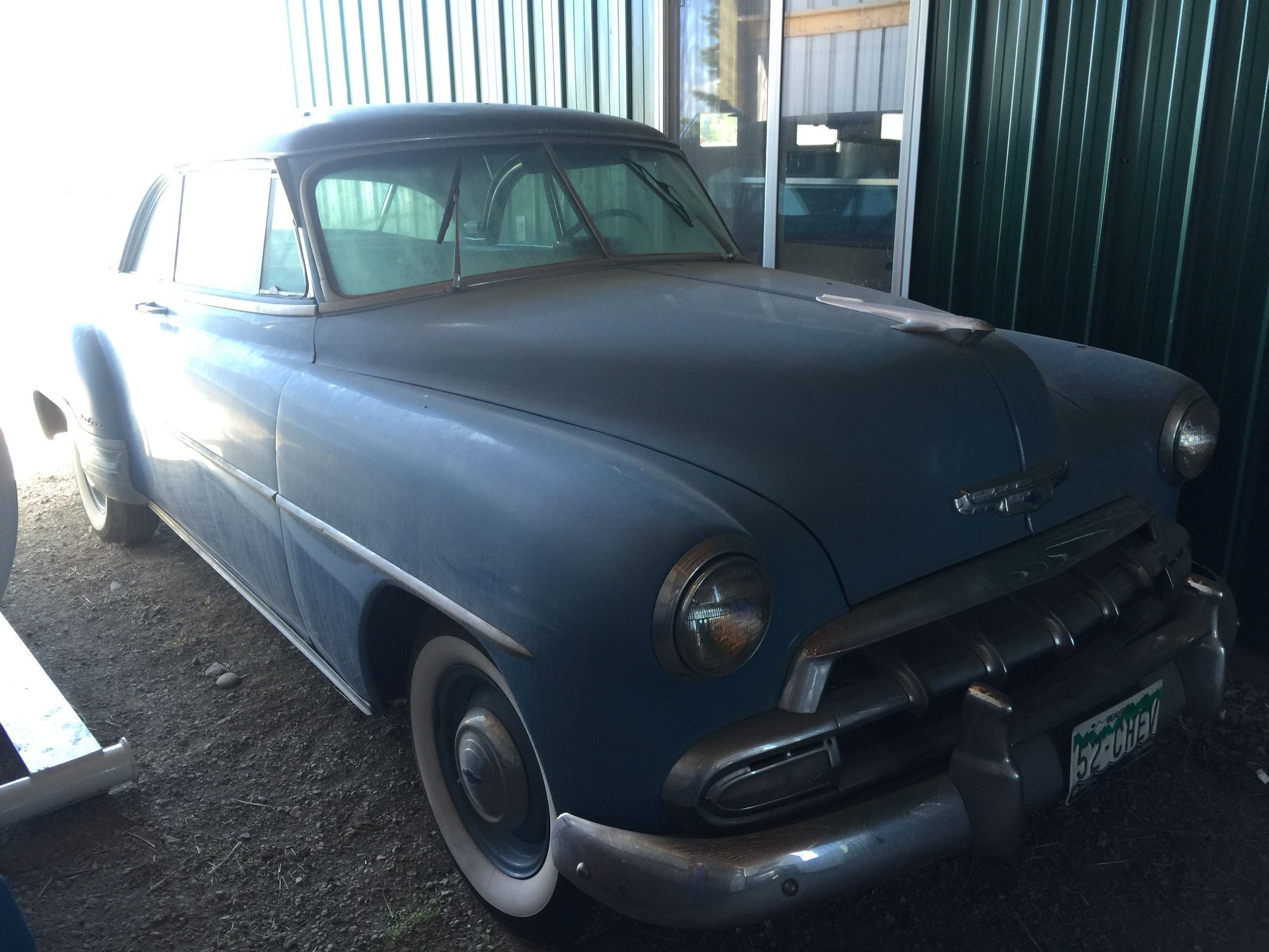

Talked with a few shops, no insight on why it's doing what it's doing, but they've offered tunes to try out. Not back home until next week, we will see how that goes. Need it drivable by Friday, taking a '52 chev for a 100% restore.
