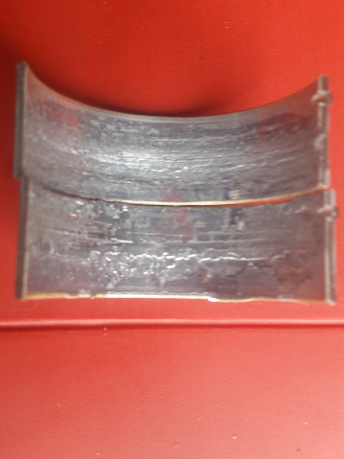

And the problem is identified.
Spent all day removing oil pan.
Everything "looked" good, rods not discolored, no abnormal play....but I went this far so I removed rod cap.
Forged crank is pristine and shiny, no marks on it at all....looks new.
Rod looks good bearing did not spin.....it melted or something.
See for your self.
Melted AL bearing.

What in the hell... Almost looks like there was insufficient oil clearance when machining was done on the main bores. Did you reassemble it using the existing bear shells and check it with some plasti-gauge? Would be interesting to see what the clearance is, especially if it ends up being a bit too tight and needs a smaller bear shell to prevent this from re-occurring.
What are your oil temps? That bearing looks delaminated due to heat, which is either insufficient clearance for an oil barrier OR your oil temps are astronomical. Babbit and other bearing material doesn't start to melt and smear until around 360-390*...

Photo of #6 rod bearing. Right next to #1
Did some looking on the net, seen a couple photos of bearings that look like #1.
Possible causes are detenation, and overloading. Piston hammering on rod causes a loss of oil film making the bearing melt and roll.
Also, cheap $3 AL bearings ford put in. I can buy these for about $4.50 each at summit.
I am going with tri metal for replacements due to the supercharger....supposed to be a better bearing. Costs $15 each.
Did not reassemble, there are pits and ridges in old bearing, no way to tell what the original clearances were.
#6 rod bearing....right next to #1.

I agree that the bearing is fatigued. Probably due to excessive heat. I would check the clearance before and after but also bar the engine over a few times by hand and the inspect the new bearing. If the rod is out of round enough, it will mark the new bearing. Make sure it's toques properly too. Hopefully the rod is still in spec. If it was heat, that may change the rod dimension. Hope that's not the case.

Well at least you found the cause of all the ruckus. I wonder if Vandervell offers bearings that'll fit... So long as the specs match up, it doesn't matter what they're listed for really. There's so many parts listed as engine and brand specific, when it all reality all that matters are specs and sizes.
I'd still be interested in the oil temps, given how things are going awry and off the charts in different areas it might not hurt to keep an eye on it instead of a dummy gauge with a broad sweep range.

All 10 rod bearings replaced, could have gotten by with just replacing #1 as all the rest looked perfect. Took the better part of 8 hours to replace all bearings and reassemble everything.
I am using 5W30 now since I have a tad more rod bearing clearance. Plus I took out the 195 degree thermostat, it's not the right one. It's supposed to be a 185. I installed a Ford Lightning thermostat it's a 180 degree unit.
I started it and smoooootttthhhhhhh. No knocking or tapping. All I hear is the motor running....cool.
