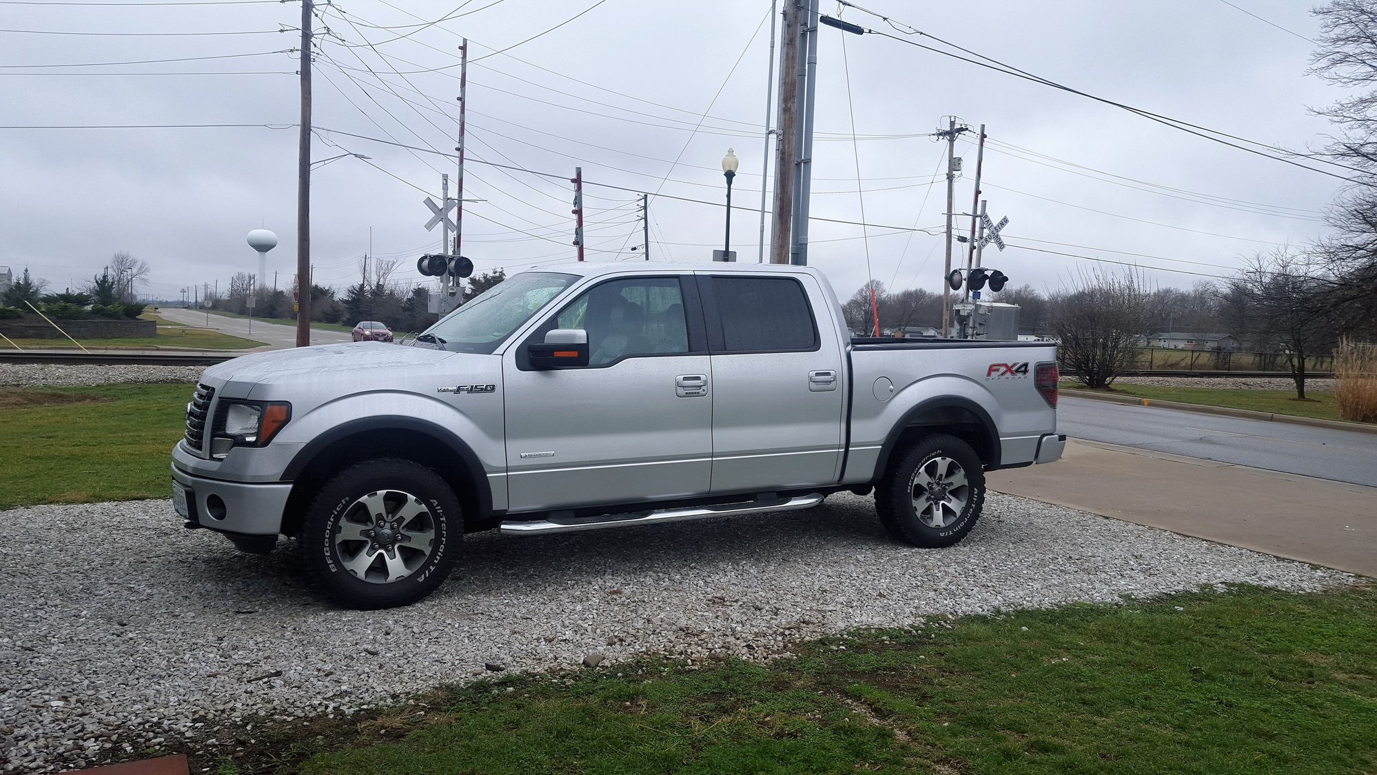

The Running boards had extra holes to mount to the brackets, I repositioned one of the brackets on each side and eliminated the middle bracket. (the middle bracket just would not line up)
By doing this I could mount the boards, no drilling needed.
Maybe a tad short, but for $85 (had to buy the clips)... I wear them for awhile.

Looks good, glad you were able to make them work.
