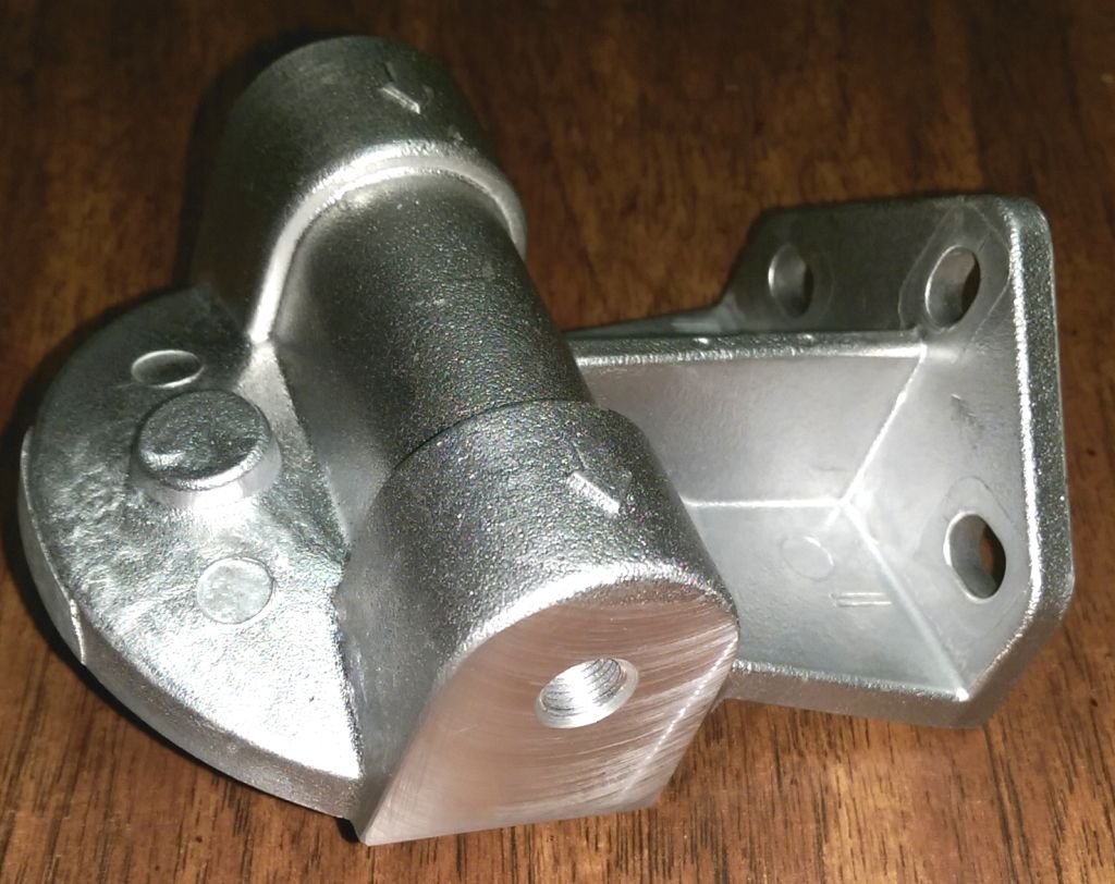

Picking up where we left off
Okay, as I'm working on some of our heavy equipment, I look over the hydraulics and my mind turns to the oil bypass filter stuff still in a box.
Where does the time go?
So in the interest of getting things started again, here is some oil p*rn to enjoy
Note the hole in the bypass filter is NOT offcenter. It is centered on a plug recessed about 1/2"-3/4" down the hole. Optical illusion
Oh...and found out that even a PIC with the word "bypass" and "hole" as one word gets filtered out when run together So it's renamed now, LOL

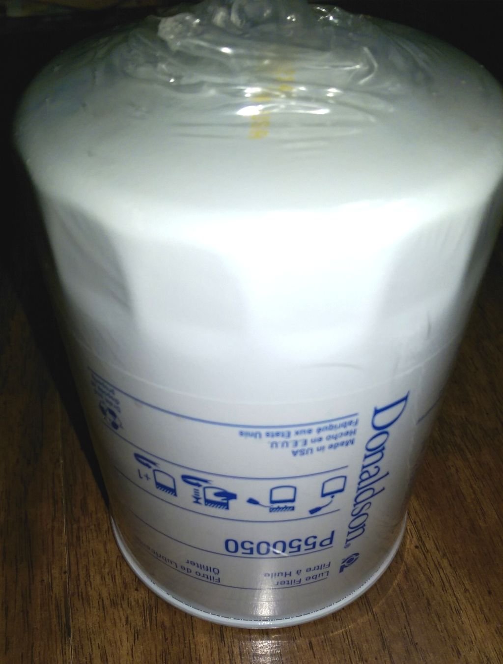

What micron rating was that filter again John?
99% at 45 microns. And I had bought a couple of them because they were cross referenced to the B50
P550050 - LUBE FILTER, SPIN-ON BYPASS | Part Detail | Donaldson Toolbox
What do you think? Run them, or wasting my time and get the B50 instead?
