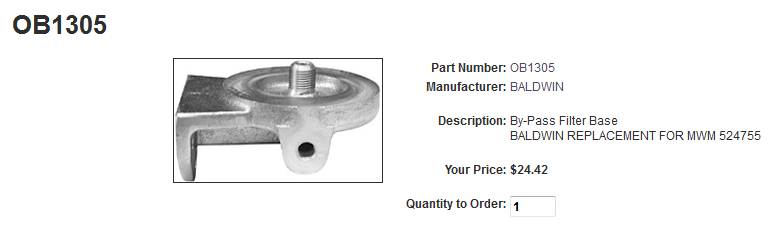

Started ordering
Update: Started ordering some items today.
I ordered these from Filter Products - equipment parts - Donaldson, Baldwin, Des-Case, Wilson, Ingersoll Rand - alternators, air & electrical starters, bag, engine & hydraulic filters, bearings
Be advised, shipping is spicy. Paid about $15. It was about $0.50 difference to go from 2 filters to 4, so that's why
This is the filter head
and so it begins....

Should be interesting to see...
Here is a bit of info on the filter... wonder why such a difference from the Baldwin B50?
https://dynamic.donaldson.com/WebSto...tml?item=11794
P550050, P550050 filter, P550050 donaldson, P550050 filters, filter donaldson P550050, filter P550050
Understanding Filter Beta Ratios
Is there a difference? It's listed as a replacement for the Baldwin.
Please explain and feel free to act like I'm clueless. I won't say I'm in that place, but I can probably see it from here
