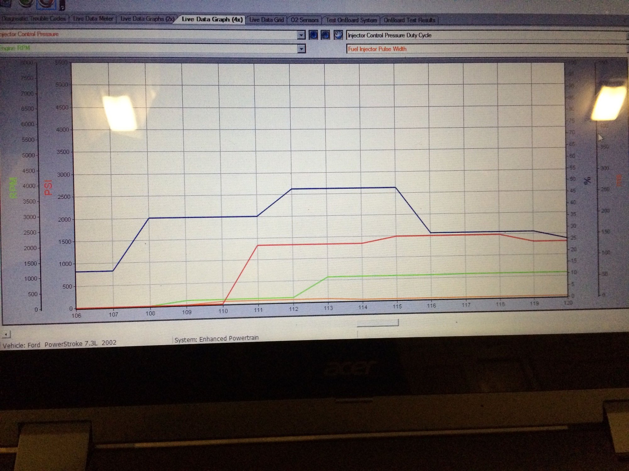

I have now replaced hpop, injectors, cups, gpr, batteries, uvch on both sides, icp and ipr on my 2002 F550 and it still has a long crank to start.
It has been driven about 1,000 miles since then and no change. I have no codes except buzz test produced a high to low 1272 1274 1276 1278 one time. Cannot get that to happen again.
It is taking 4 seconds of cranking to start consistently hot or cold. It aways starts but cranks for what seems like too long compared to my other 7.3s. I have included a screenshot of the data and am curious on what everyones thoughts are as I am out of things to look at!

It takes a long time to build ICP, even with a high IPR. Since the ICP doesn't "fade" in, but jumps in - I'll guess your HPOP reservoir is draining down, and it has to refill when starting.

It will not fire without the actual 500 PSI ICP. It's not the electrical signal that applies the fuel - it is the oil pressure. The correct Fuel Injector Pulse Width shows how long the oil valve is open in the injector. The Injector Control oil Pressure is the "thumb" that pushes the fuel out of the injectors like a super syringe.
This is HPO related - it's not there at all early in the crank. When air gets in the oil system by way of the HPOP reservoir, the lines, or the rails - ICP builds slowly over several seconds. In your graph, there's zero ICP for several seconds but plenty of IPR signal. Then... it's like the HPOP snaps to and says "Uh? You talkin' to me?" Now that you've confirmed the HPOP reservoir is full, I really suspect your IPR. I think either the little pin in there is stuck, the coil is failing, or that skinny nut on the end is missing to begin with. If the nut is in place, you can remove the IPR, clean it, and see if it rattles when you shake it.
