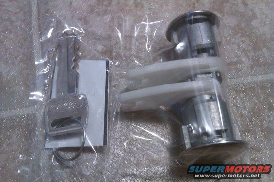

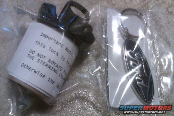

Originally Posted by warren561
I was able to purchase a keyed set of OE Ford door locks and ignition tumbler for about $80 on eBay two years ago from seller rocket-keys. They're supposedly OE Ford made by the "HURD Lock Company."
I got two door lock cylinders, an ignition tumbler, two plastic black handled keys with Ford stamped on the plastic, and two all metal keys with Ford stamped on them. The look great, fit great, and work great.
