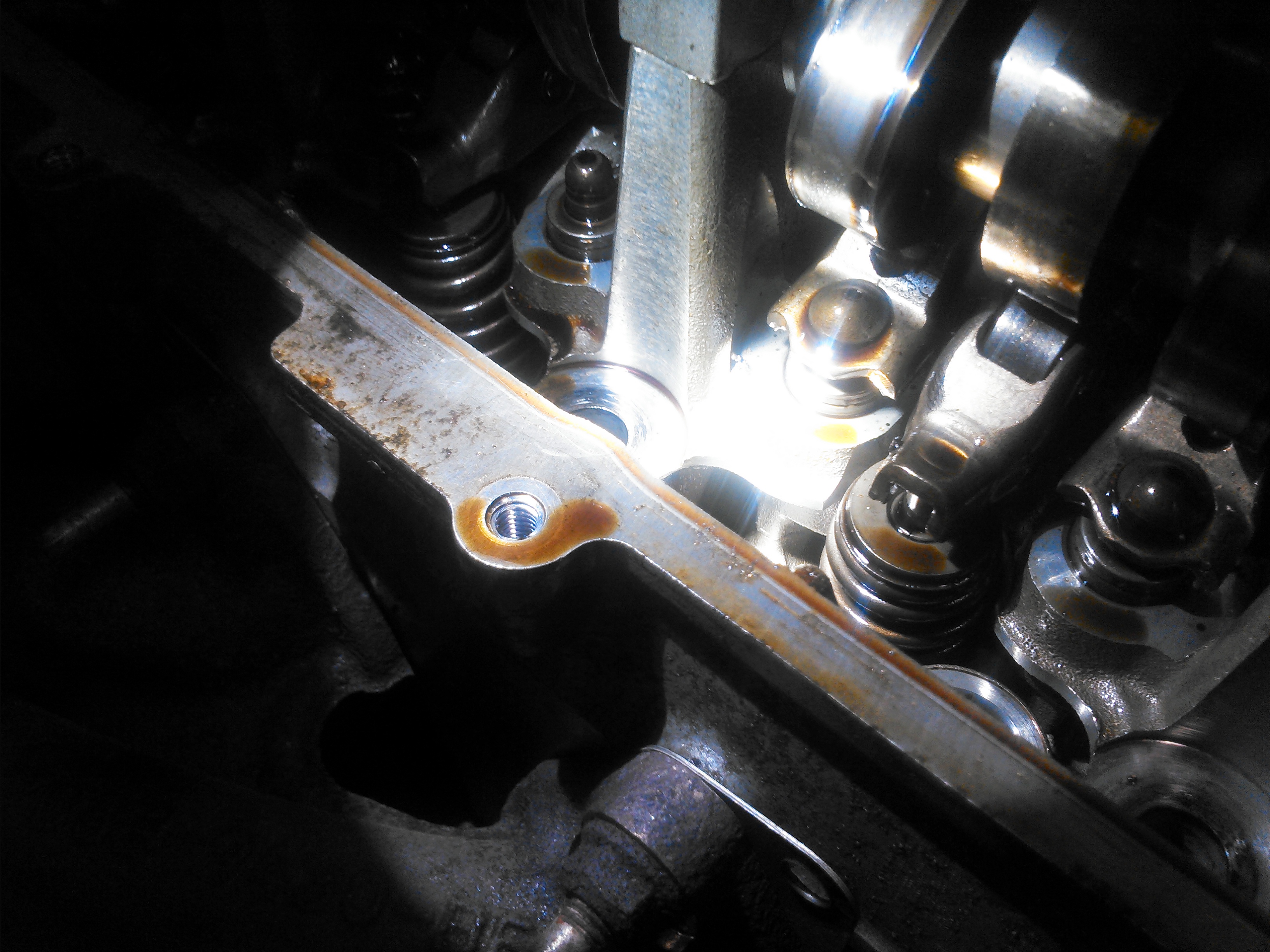

Originally Posted by redford
I'd like to see some pictures of the failed cam follower/ rocker.

Originally Posted by Fleetguy48138
In the last picture what is the cast peace with the bad seal?
And is it just the camera or maybe just me but are some of the other follower bearings bluish like they were hot?
That looks like a timing chain tensioner
I did some searching and it appears that that is exactly what it is and if the seal is compromised oil pressure to the cam and associated parts will be compromised.
Is this the common find on the engines????
Edit, I meant on Fleetguy48138's truck Engine problems...
This is what I'm thinking too after seeing that tensioner seal, unless it was damaged on removal. I wonder where the roller on that rocker arm went.

looking at the pics, here is my latest theory.
  • 90% of failures have been on the right side of the motor (end of the oil system).
  • These are high idle time (1200 rpm) units, which are already operating at the lower thresholds of oil pressure
  • Timing chain tensioner on that right side is leaking (end of the line).
  • This is causing a lack of lubrication, thus failure of the valve train, and if not caught in time, Catastrophic engine failure.
here is a pic of another leaking tensioner from today.
