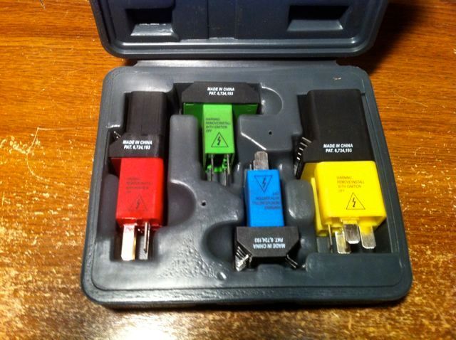

If IHateCommieCars has one of the small tool stores near by he might think about
about getting this tool set.
The cool thing about the set is you can also buy just the one you need and you can
use you meter to test or a jumper wire to close the connection so that what ever
uses that relay contacts will see the relay as activated.
U think that the YELLOW tool would cover all needs for you.
Here is the one of the kits that has the yellow in it. I think I paid less,but I was not in a hurry.
Relay Tester Test Jumper Kit Domestic and Import Automotive How to Test Relays | eBay
This is about what I paid
Lisle Service Tools Relay Test Jumper Kit Extender 56810 | eBay
Here is just the YELLOW one on Amazon.
Amazon.com: Lisle 56820 Relay Test Jumper, Yellow: Automotive Amazon.com: Lisle 56820 Relay Test Jumper, Yellow: Automotive
From Lisle Tools
Has a How To video
Lisle Corporation
