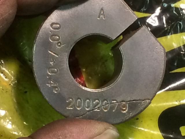

Even after soaking in Kroil and a few well placed "Love taps"
It's a sleeve and that one was a factory.

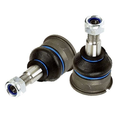

Ball joints and bushings...

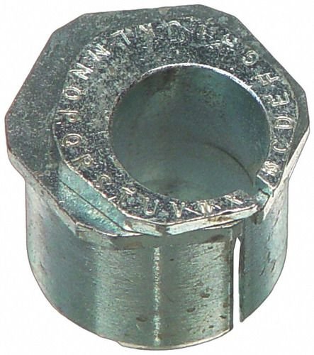

Adjustable bushing style shown...
