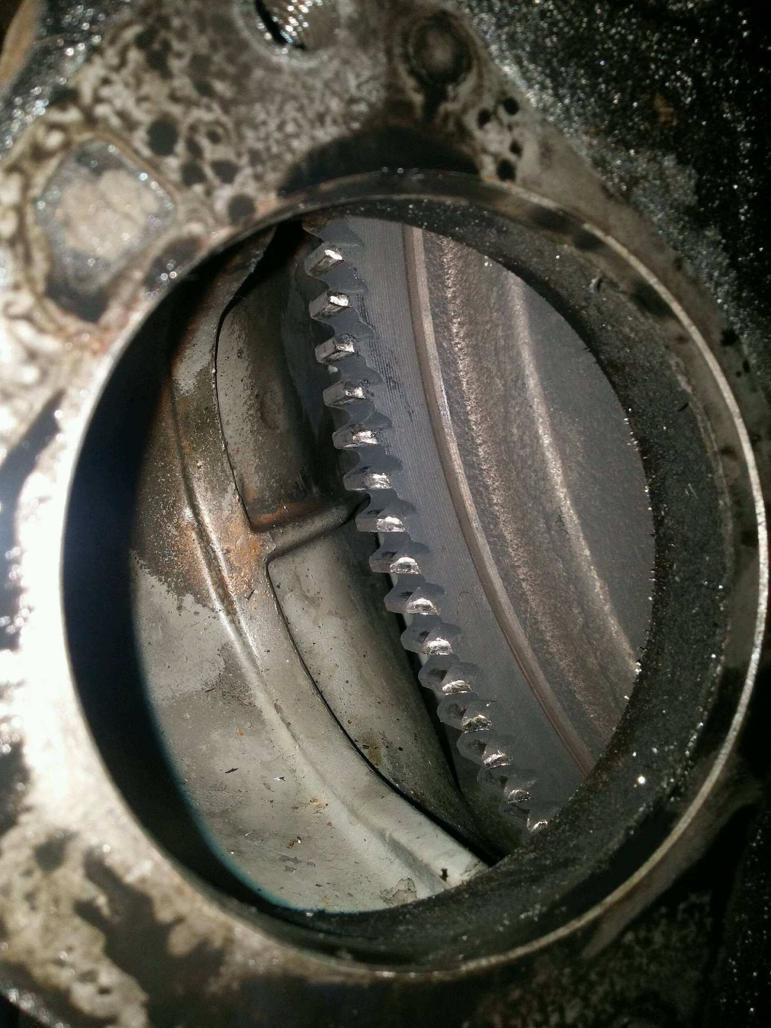

Replaced the starter again.
I finally had time to replace the starter. It was getting worse hard to catch the gear now. This is what the 2 week old starter did to the tranny/flywheel.
How bad is this? The new one is working fine so far. But how much damage did the "old" starter cause the truck?

Old Oct 4, 2015 | 11:01 AM
Macrobb's Avatar
Macrobb
Joined: Dec 2011
Posts: 3,860
If it's working... It's working!
As long as it's engaging every time, don't worry about it. If it occasionally doesn't, you may need to clean up whatever spot is causing trouble.
