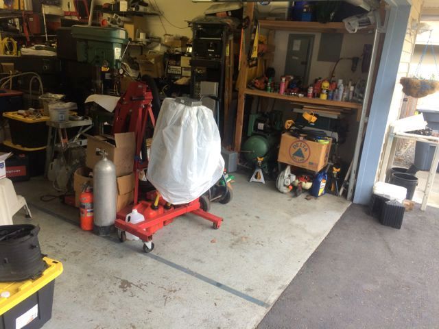

Ready for some fun? Been cleaning my little slice of the mess.
For some reason someone wants to park the Mini Cooper
in there> I can do that. BUT then she wants to take it out and
drive it. Now why do you have a garage if you can't fill it up?
If a car was meant to be parked under a roof it would come with
one when you signed the papers. Plus the Mini is so small it might
get lost in there with all the tools.
You know that you can almost get a car in there. Just don't let her know that

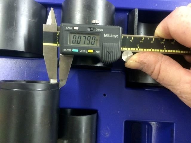

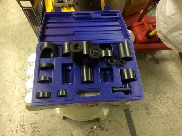

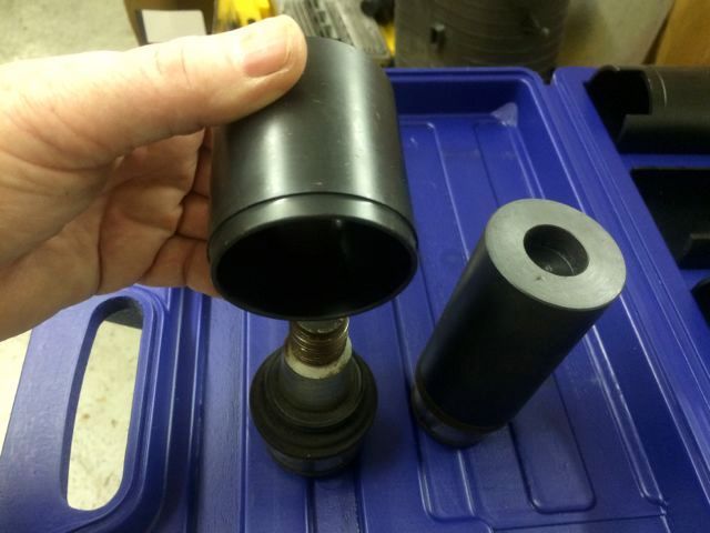

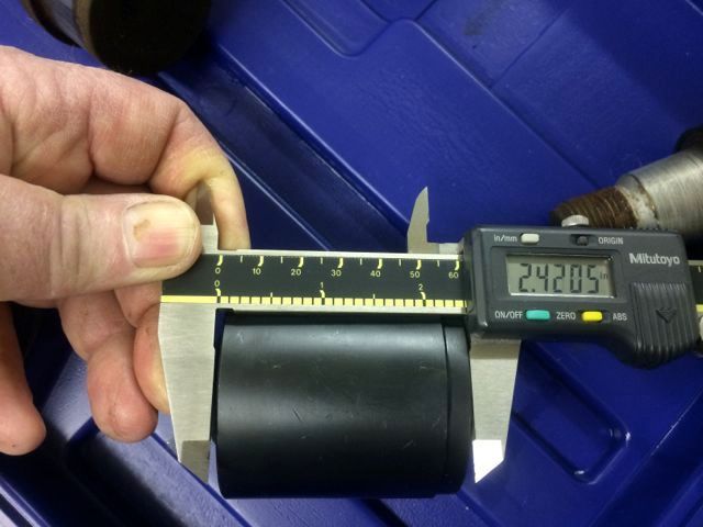

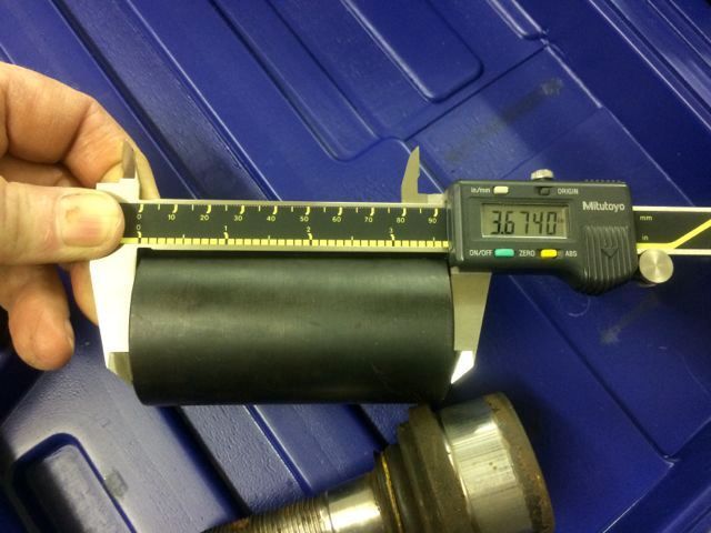

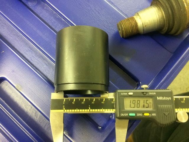

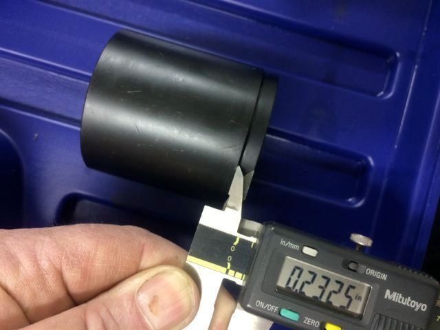

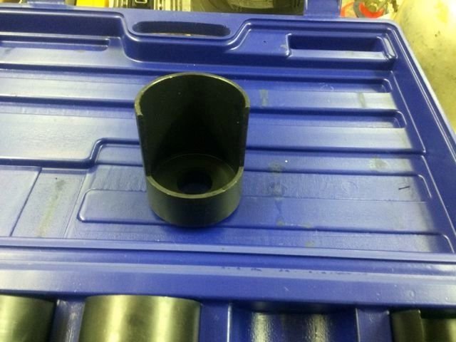

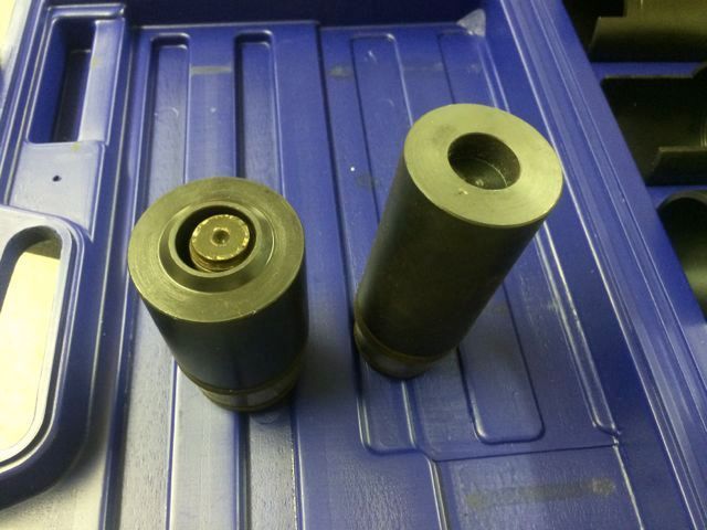

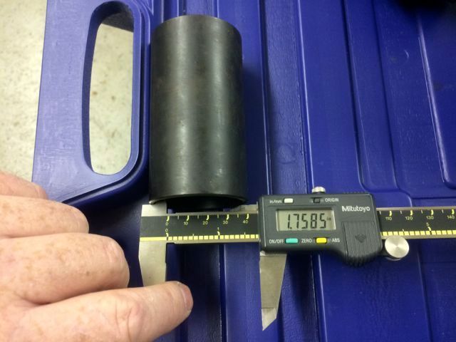

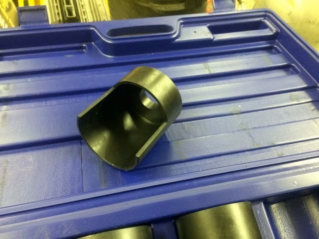

Now on to the job at hand. It's the lower ball joint that is the true PITA. The long smaller one is the upper
joint tool. The larger one with the recessed edge is the one for the lower joint.
The last two are the lower ball joint remover adaptor. The notch is so it will clear the edge of the knunkle
NOTE : I have one more tool to get my hands on. It is used for seating the newer dust seal . As soon as I
have it in my hands I'll post some info in this thread. then this weekend I get to beat up on my truck.
Hope this helps you and any others that happen to look.
