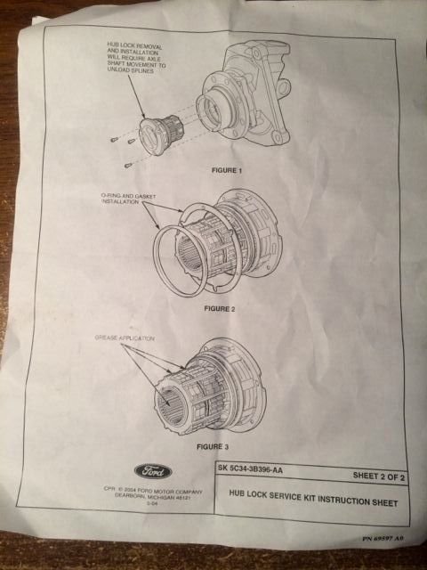

Here you go
Sean
6.0L Tech Folder

Well foot. Have to add this one to my list. I suppose that does just one side?
