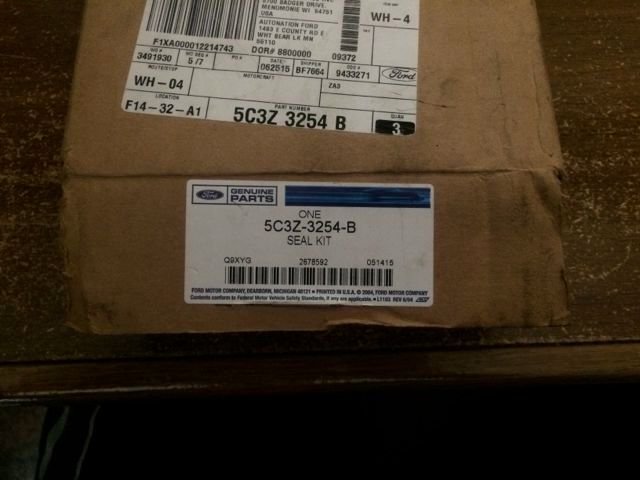

Old Sep 30, 2015 | 04:59 PM
  #59
KDAVID1's Avatar
KDAVID1
Joined: Feb 2013
Posts: 4,073
From: TX
Originally Posted by Yahiko
Here you go.
BTW a bit of heat will break the loctite loose. I use a MAPP torch and get them hot
enough but not till they are red. Just enough that you have to let them cool some.
I got to thinking that I should post the Ball Joint Service PDF.
I'll get that done a bit later today for you to enjoy.
While we are talking ball joints and such. I need to replace the tie rod ends alone with the drag link.
That one can get very $$$$! Do to the way Ford is in love with it. Anyone have a good replacement for the set?
Sean
6.0L Tech Folder
May be a duplicate question but what ALL is in that kit?
I have reverted all my stuff over to ficmrepair and will order from them except for the ball joints (going xrf) but want to make sure since I just told them im doing xxx and need xyz--didn't give part numbers--want to make sure I'm on the same page. oh and that kit is for one side only correct.
Old Sep 30, 2015 | 05:59 PM
  #60
Yahiko's Avatar
Yahiko
Joined: Apr 2012
Posts: 27,307
Likes: 549
From: Spanaway
Here you go
Sean
6.0L Tech Folder
Here you go.
Sean
6.0L Tech Folder
Everything in the kit is what is listed in the part list in that first page in the top quote.
The nice thing is you get 2 of the large yellow hub lock O-rings.
And yes I was lazy and just posted all the relevant quotes .
Sean
6.0L Tech Folder
EDIT : Let me know if you can't read the part numbers I am having a hard time myself.
I can repost them in a better format.
