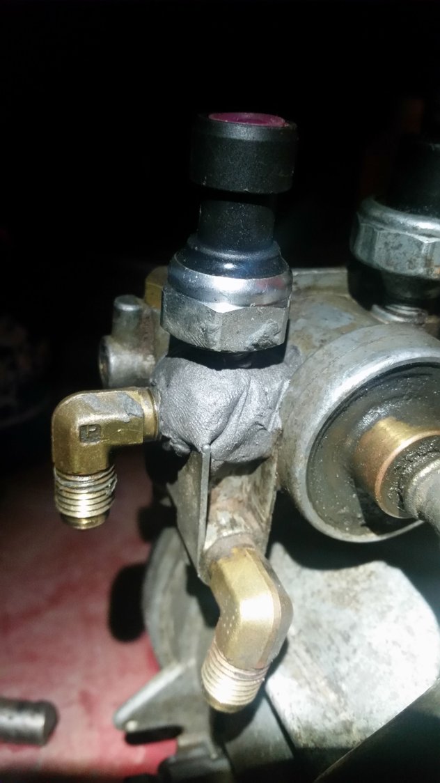

EDIT: IIRC that is a weak point in the FPR and it happens often if you over tighten the sensor.
is that a crack where the fps screws in? sorry i cant tell if thats from the cast or not.
if it is a crack, you can try jb weld. if you do take it off and clean it with soap and water then some type of surface prep so there isnt any oil that would mess the jb weld up. im not sure if welding that is a viable solution or go to a junkyard and buy a new to you one.

Yeah it's a crack in the seam of the casting. I'm pretty sure I over tightened the sensor. *face palm*
Went to O'Reilly's and they had this putty stuff I'm trying. Not sure how well it will work but it's worth a shot

like i said surface prep is key! also make sure you let it harden all the way.

Well I have the bowl out, cleaned and gooped up. I don't think it's going to work but it's worth a shot.

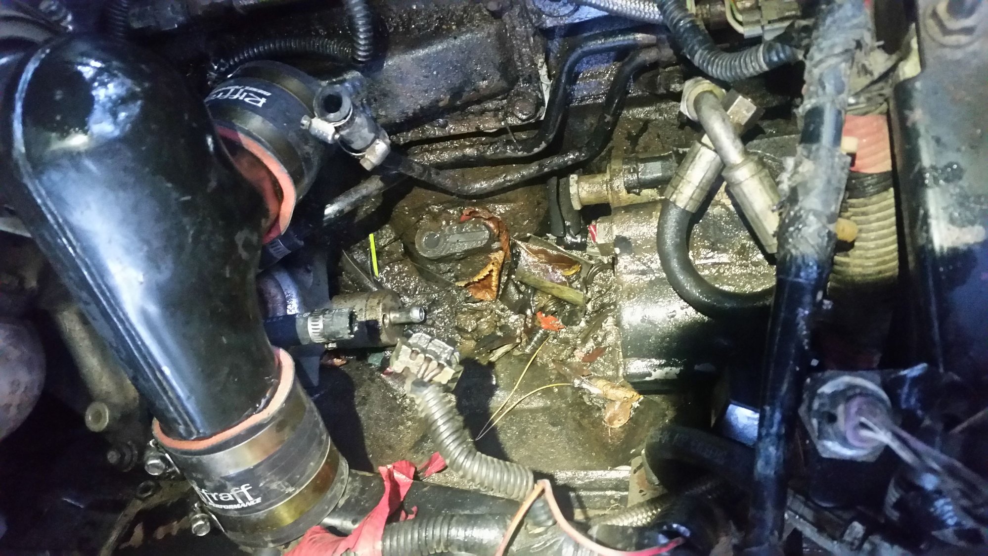

And now I know why it's called the valley of death lol... I found a socket I thought I had lost like a year ago... I'm also going to clean all these leaves and cracked fuel lines out before I reinstall the bowl.

So that's the putty stuff.. I'm going to go around the edges with some black rtv just to seal it up as well a possible. I really hope this works.. I need my truck!
This is a good time to clean this out too.. There's probably a good half inch of dirt and leaves down there...

If it helps any, I parked my truck on an incline sprayed the valley full of degreaser, let it sit for 15 minutes, and then power washed it out. There is not really much that can be hurt by doing this.

Yeah that's what I would do if I didn't have the fuel bowl out already.. Since I have easier access, I'll just shovel it out with my hand and then spray it down really well once I have everything hooked back up.
Lol I might be able to skip the degreaser step with all the diesel I already sprayed everywhere...
