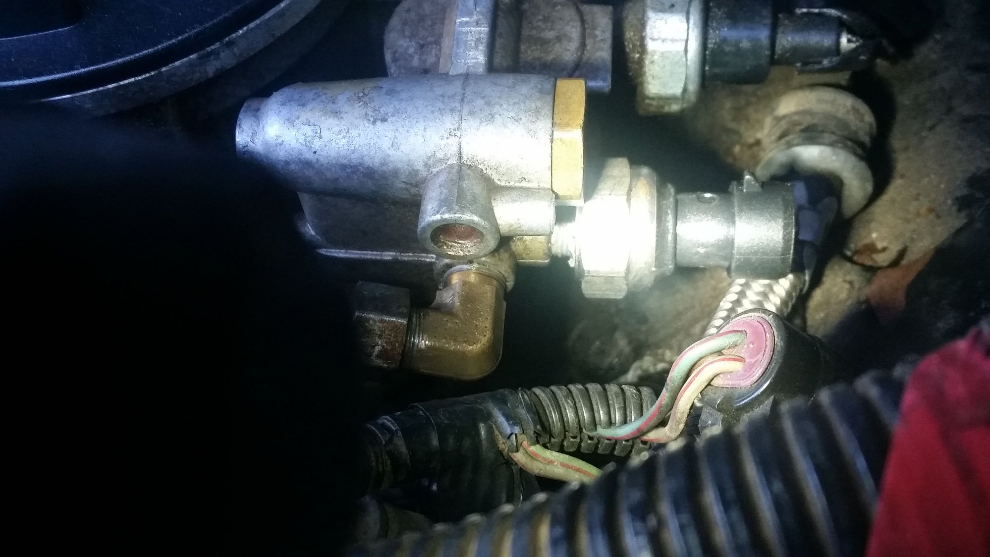

I pulled up to my buddy's house and smelled diesel.. Saw this...
Yes. That is a squirt of fuel out from around the fuel pressure sensor... I think. I might have cracked the housing.... I'll know tomorrow when I can see.
So... Any e fuel kit recommendations? I saw the air dog 2 kit on riffraff. I have done no research on it at all
Old Oct 12, 2015 | 10:52 PM
  #58
sean9049's Avatar
sean9049
Joined: May 2014
Posts: 432
From: Kentucky
wow that is quite the luck, hopefully that was the pressure problem and not something that just happened to rear its head now. the fitting looks kind of crooked but maybe thats just me... i built mine using Mark Fugazzatto's FPR and regulated return then made the rest my own. ended up being around 450+/-, building one yourself can be a pain and take longer but if anything goes wrong you know the ins and outs of your system.

As far as I could tell, it went in straight... Threaded in just fine, tightened it up, plugged it in, squirts galore.

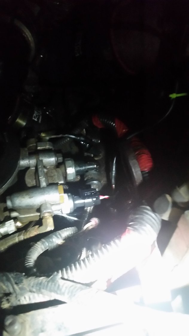

Well... I found the leak.. Probably worst case scenario
Jb weld? Until I can get Efuel here and installed
