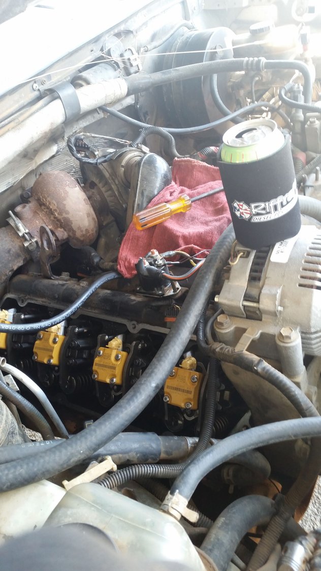

4 injectors down!

How it all came in

The contacts on the PCM might not be clean or the PO cleaned them to much.

Nice job Jarrett. I would think what Glenn said about the contacts. It should be seated ok since it runs. Do you have a way to get the codes that set?

Thanks Byron! I have the torque pro app but haven't played with it much yet. The cel turns off on restart so I think I'm ok.. It only comes on when I get into it in a hot tune.

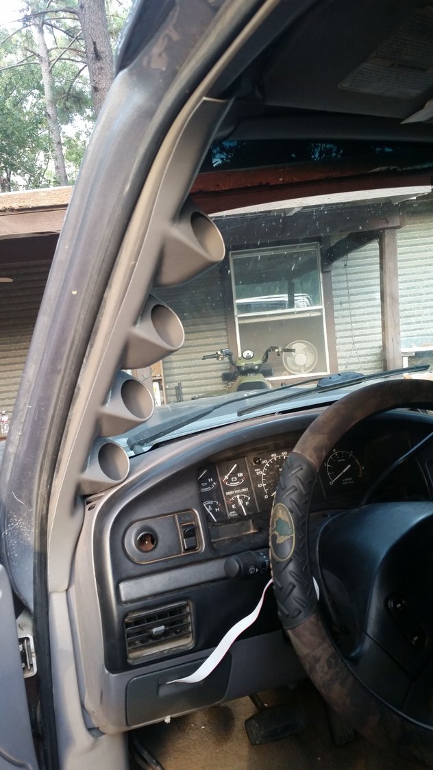

Ok so I made progress yesterday. After fixing my well pump (for now), I had just enough time to put my Pyro in and wire it temporarily. It's probably the saddest wiring job I've ever done, but it works and it was getting dark. Now, all I have to do is get the other three gauges in and I'll be cooking with Crisco!

Ok so I got all the gauges wired.. All I need to do is install the transmission probe and get a t for the boost gauge.
