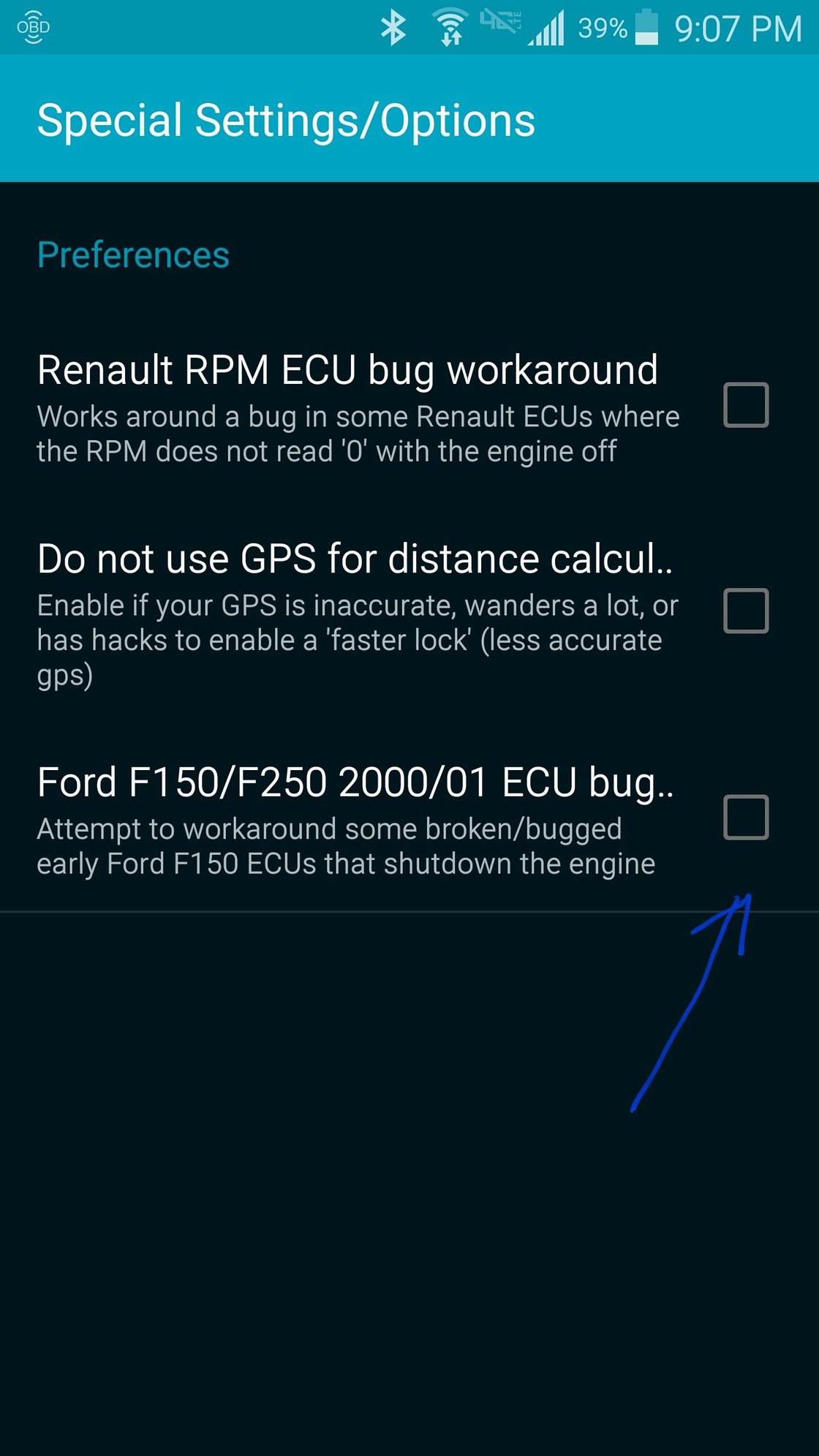

Should this box be checked? Where it include the F150, I'm wondering if its a gasser function...but ours have known to shut down too!

I checked that for a while, then unchecked it. The only difference I saw was a box with a check in it - or not. I do have a 2000 F250. It might be particular to specific PCMs - there are a lot of them.
next time I take Enigma out and use torqe pro ill tick that box and test it ot if you guys want...
