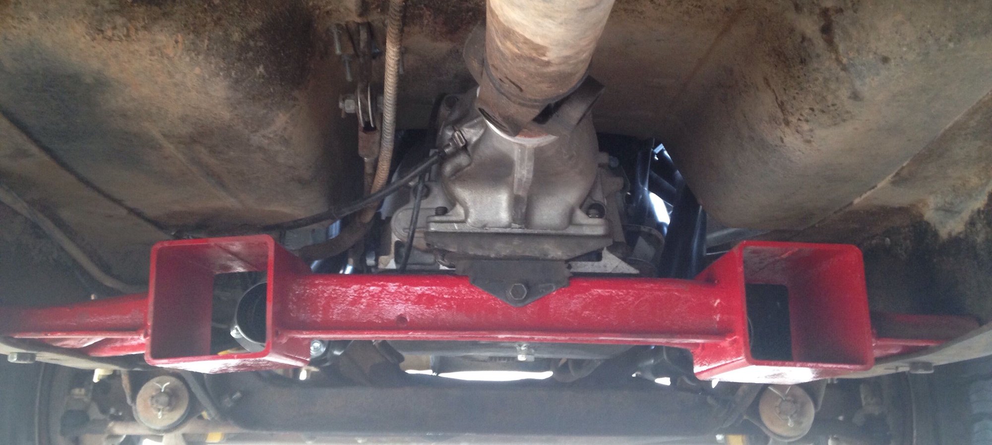

Got Er built! I used square tube since I had it laying around.
I painted it red cuz the new mufflers are red. I wanted it to kind of stand out to anyone who looks underneath.
No exhaust pipes built yet. I'll be working on that tomorrow afternoon. Should go pretty quickly.

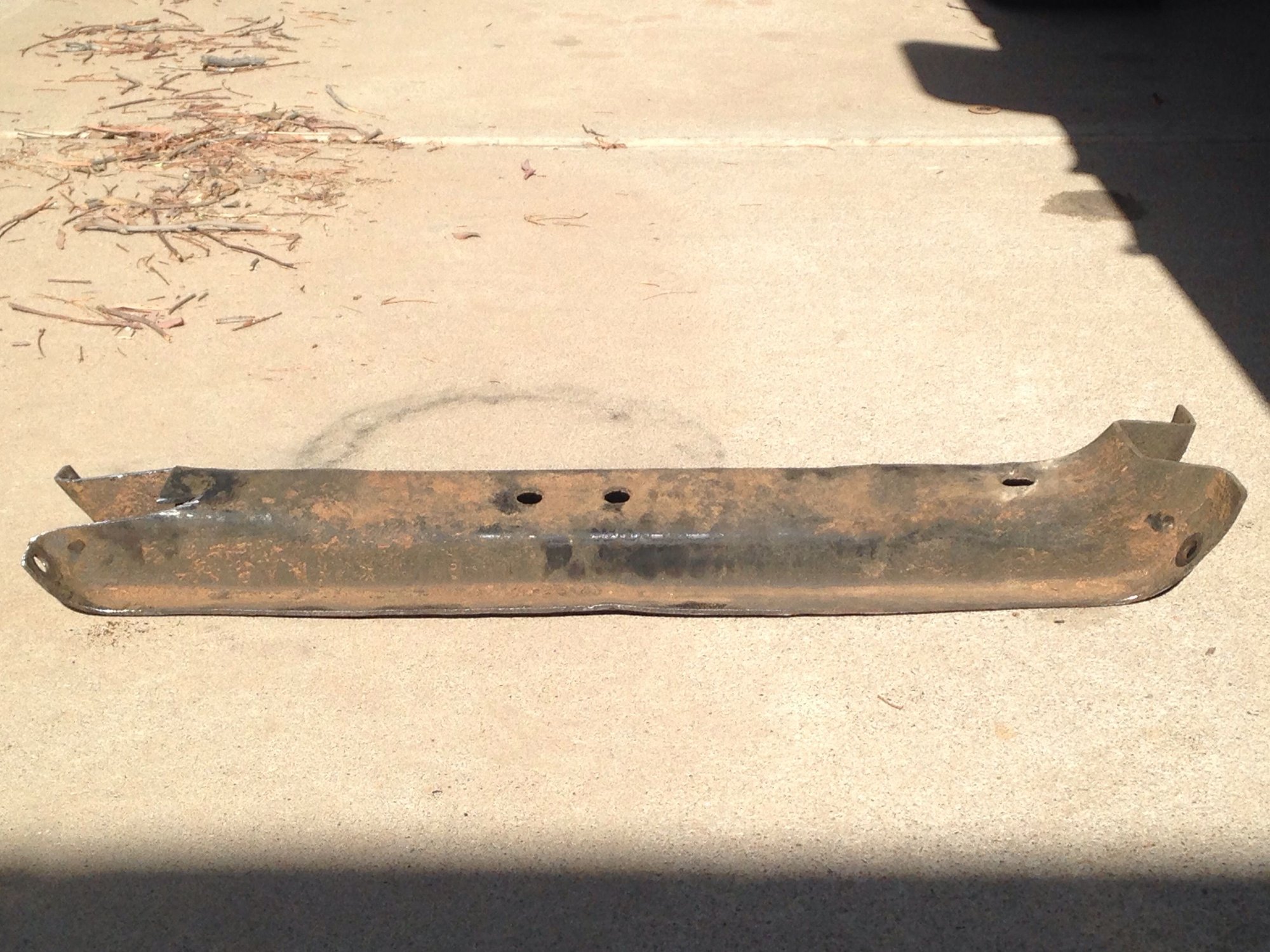

Originally Posted by JEFFFAFA
Ah. Good news. That means you got the right side header to fit also. Did you have to do any "messaging" to get it in?
I had to remove the front crossmember and trim it down even farther than I previously had. With it out it slipped right in. The driver side put itself on.
Notice the passenger side is cut down completely flat. As low as possible without compromising it.
