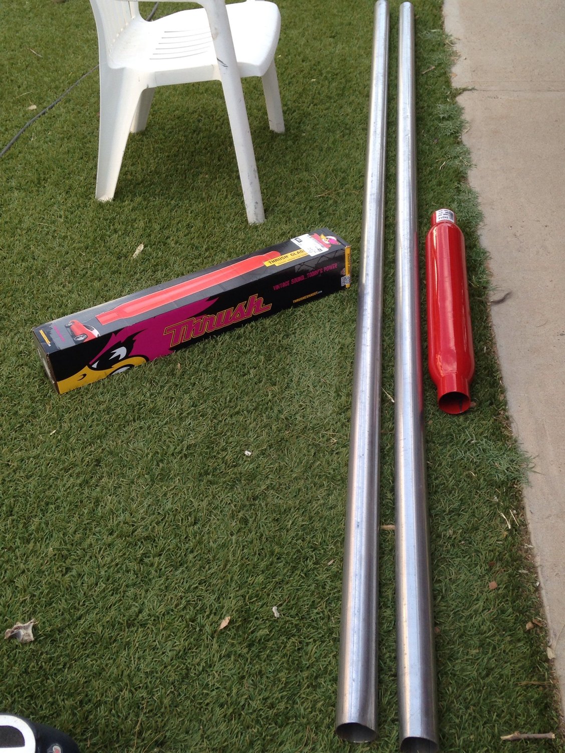

Just bumping this up. I haven't forgotten about it. I'm going to pick up the new tubing and mufflers tomorrow. I should have it built by the end of the week.

Heh heh heh
Now I just gotta figure out how I'm going to bend it.....

buy the summit U pipe kit , it gives you a ton of options just cut what you need and weld . their X pipe comes in handy too , i used the x pipe ,u pipe and 2 4 foot straights to build my exhaust .
