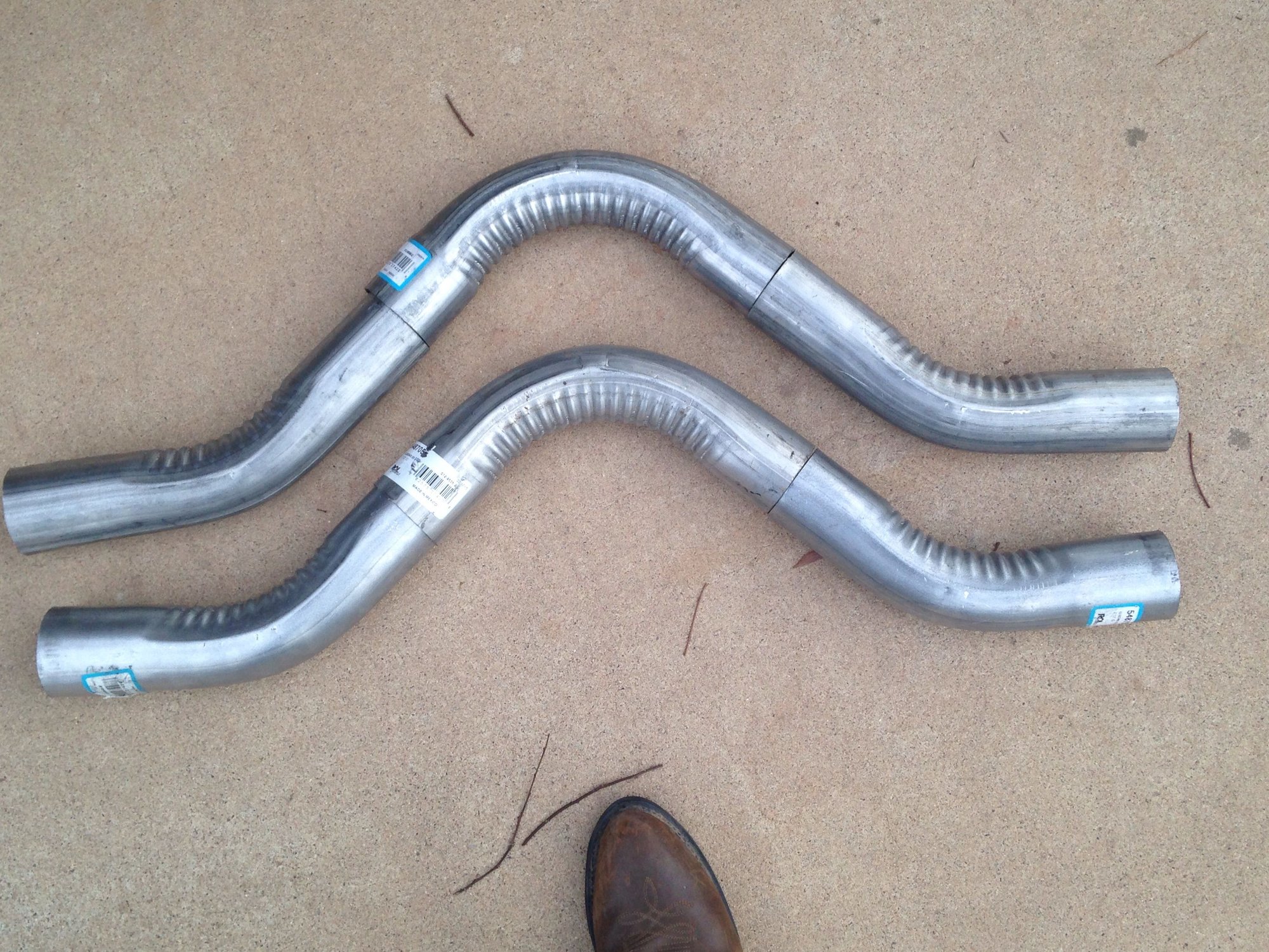

I bought some elbows from oreillys. These 6 and a couple of turn down tips were $50. Not bad.
Four 45* and two 90*. To be assembled as shown for the over the axle hump.
