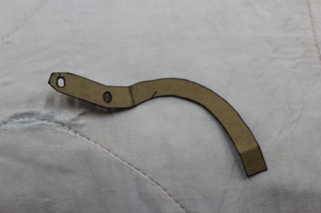

Hey John. Looking back at the way you did your glove box with those extended hinges. How did you get them to work? I’m looking at extending mine, but I just don’t see how it’s gonna lineup properly. If I make them longer than when the door closes, it’s gonna be higher. What am I missing or not understanding?
Old Mar 15, 2026 | 08:49 PM
  #853
56panelford's Avatar
56panelford
Posts: 283,694
Likes: 8,275
From: northwestern Ontario
The arch of the hinge is slightly different than the original, slightly stretched arch. I had to play with it a bit to work but both the pickup and the one I'm doing now work fine.
I'll look tomorrow if I still have the pattern I made, if so I'll contact you and get your address and send it to you..

I have your hinge mod earmarked for my truck as well. I don't know if it can, but if some type of pdf or something could be attached or a link to the template your looking for could be accessed I bet there are several of us who would use it. I know, more work with all you got going but I know I would appreciate it tremendously.

I was thinking these replaces the arc and still bolted in. But after studying your pics some more you got rid of the factory hinges all together. That’s why the piano hinge, wish I had figured this out before painting hahah. Oh well it can still be done. I will have to find a piano hinge or something similar
