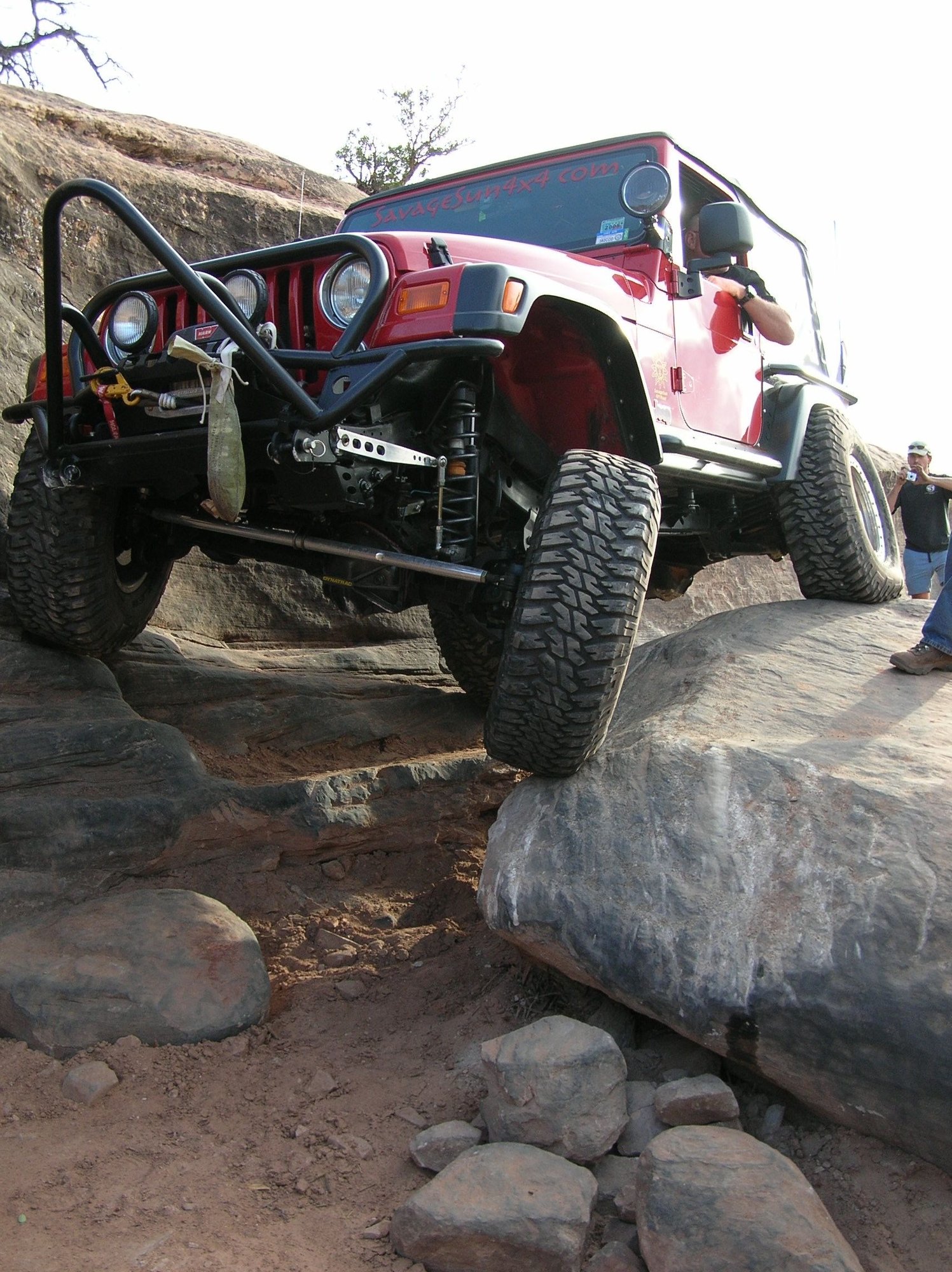

If you look at any Hi Perf cars, Ferrari, Corvette etc you will find very rigid frames. Same goes for the Jeep Wrangler Rubicon, virtually no flex at all. But its all in the suspension. From the view of Jeep - Ferrari the things they do depend upon the suspension to achieve the results they want.
The flex in the frame of the Superduty I would say was engineered into and is well know by the folks at ford, Yes it makes for a bad visual and gives the Ram boys a video to talk about but from an engineering view I think ford has the better idea.
With a 172" wheelbase on my CC/LB dually it would take a very strong frame to overcome the flex. The flex allows the LB the ability to partially absorb some of the road irregularities in the road as you travel. It enhances the ride and the traction footprint.
Overcoming the flex Ford would also have to change the suspension to allow far more flex in on and off road travel.
In this case a lot more droop in the suspension.
You can see some droop here. The springs are 3" taller in height. I limited up movement to the bottom of the OEM fenders and gave the rest of the movement to the droop. There is virtually no frame twist at all. On a wheelbase this short (about 98") you certainly do not want any flex. I think Ford is on the right track with giving some flex in the frame. The wheelbase and intended use dictate flex over rigidity of a no-flex frame.

No one is pulling fivers with a ferrari or a jeep either...
So yes, the frame is designed for the intended use. AWESOME Jeep and photo.
I saw one setup like yours the other day in a parking lot of up. Yours is very tactfully done, this one was also for show and obviously the shop that does the work Jeep. They had too much bling on it for me.

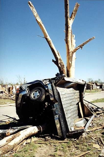

Of course nothing will prevent this from happening... Hurricane Andrew blew the truck into the tree... (yeah, I know a Chevy...)

Thank you, I kept my Jeep looking mostly stock and the old saying applies...'chrome don't get you home'
